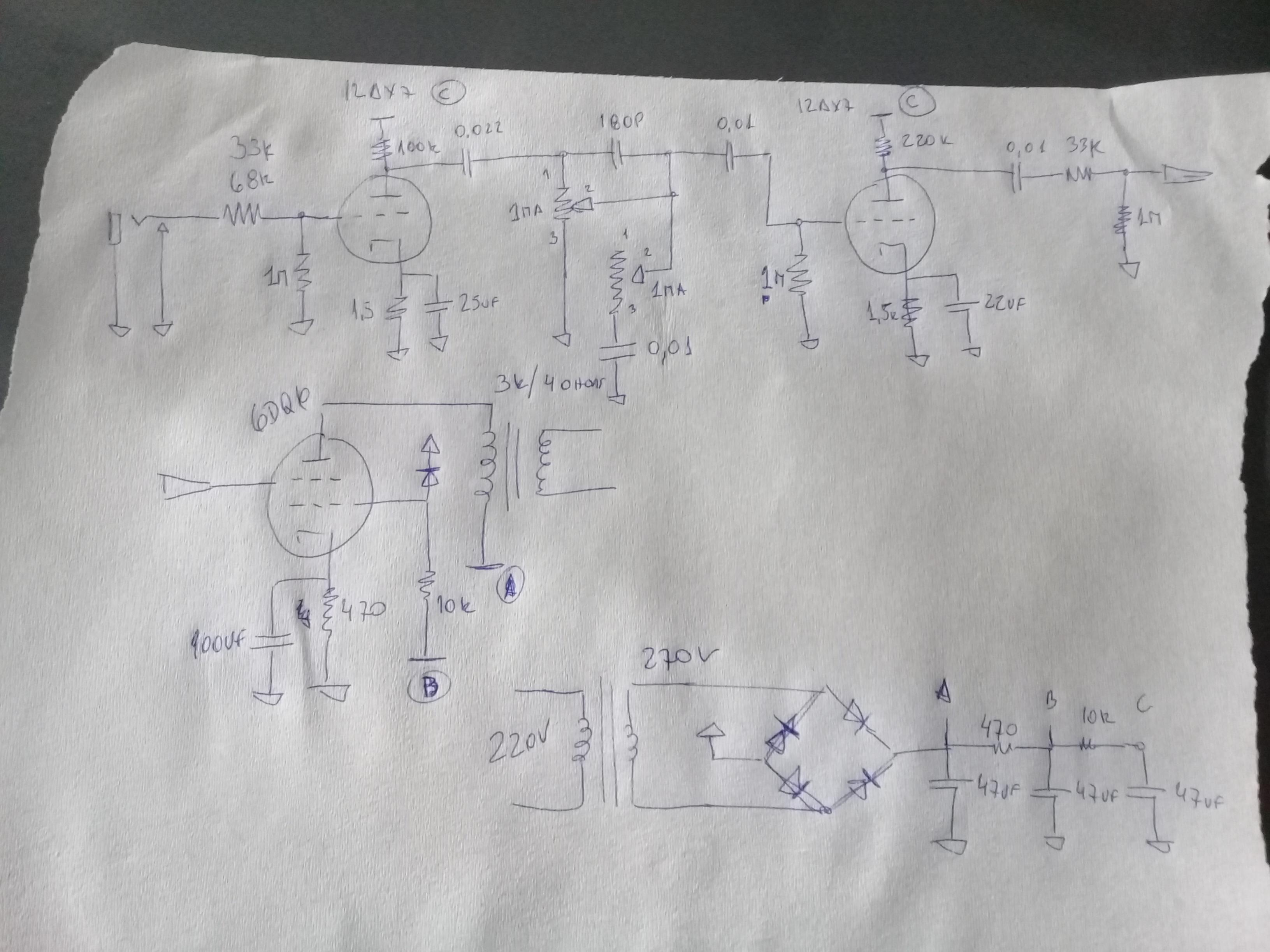

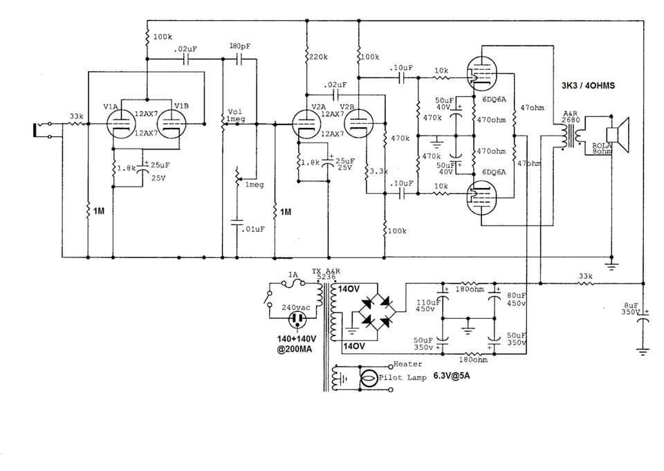

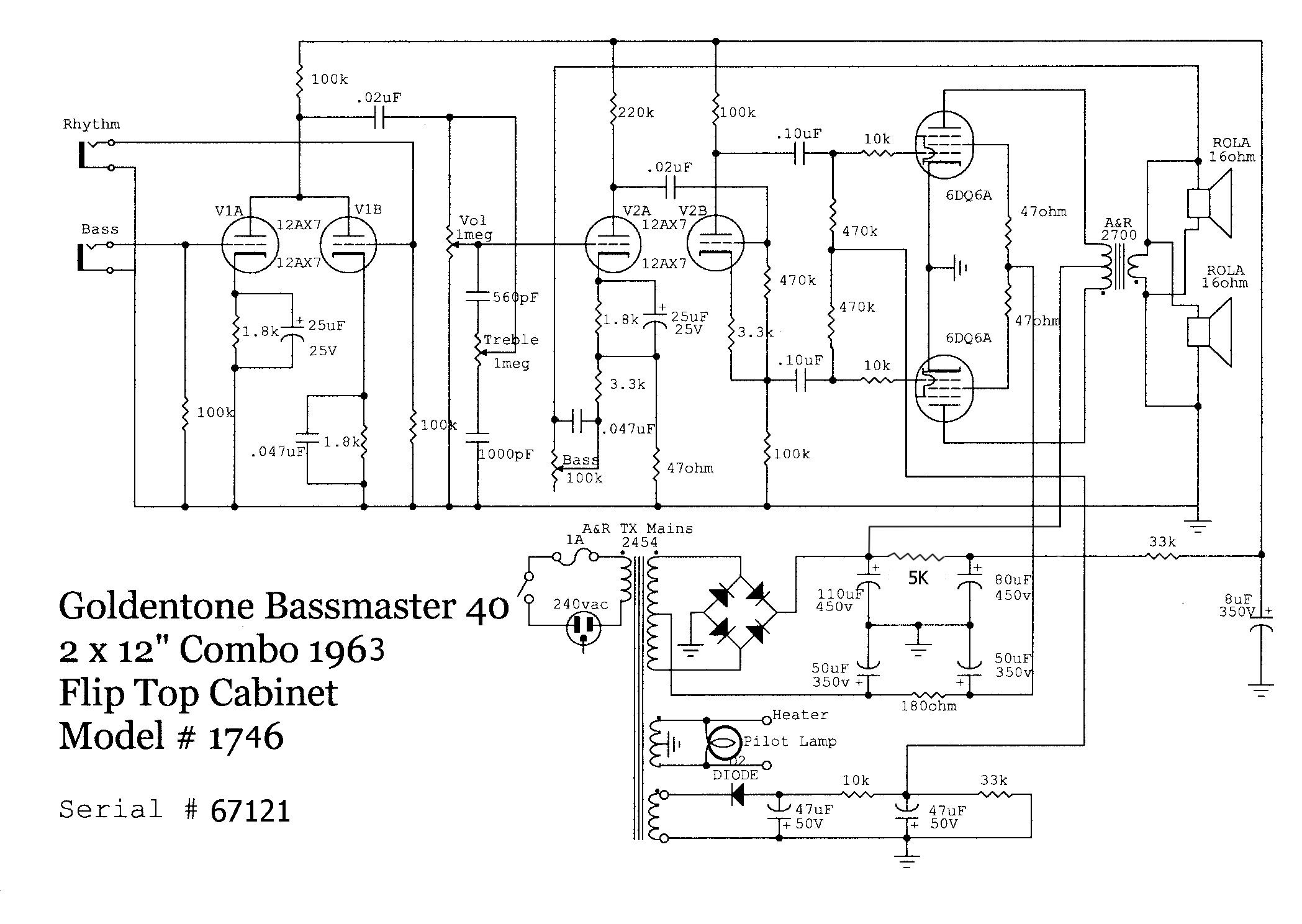

if the plate works at 300v and the screen at 150v them a 115v + 115v is good PT choise? (230x1.44=335v and 115x1.44=165v)
Google doesn't find any transformers with the numbers you posted, so I can't say how they would work. I would use the 140 - 0 - 140 volt transformer. 1.414 is the theoretical maximum that you will get with no load. Reality usually comes in at about 1.3 under load. The transformer may be specced for 140 volts at full load. It will deliver more voltage if the load is light.
The 6DQ6 will work with plate voltages beyond 600 volts. It doesn't like much more than 200 volts on the screen grid, but you will have 20 to 30 volts on the cathode, so if the screen grid is connected to 175 volts and the cathode has 25 volts, the screen grid seen 150 volts, which is just about right.

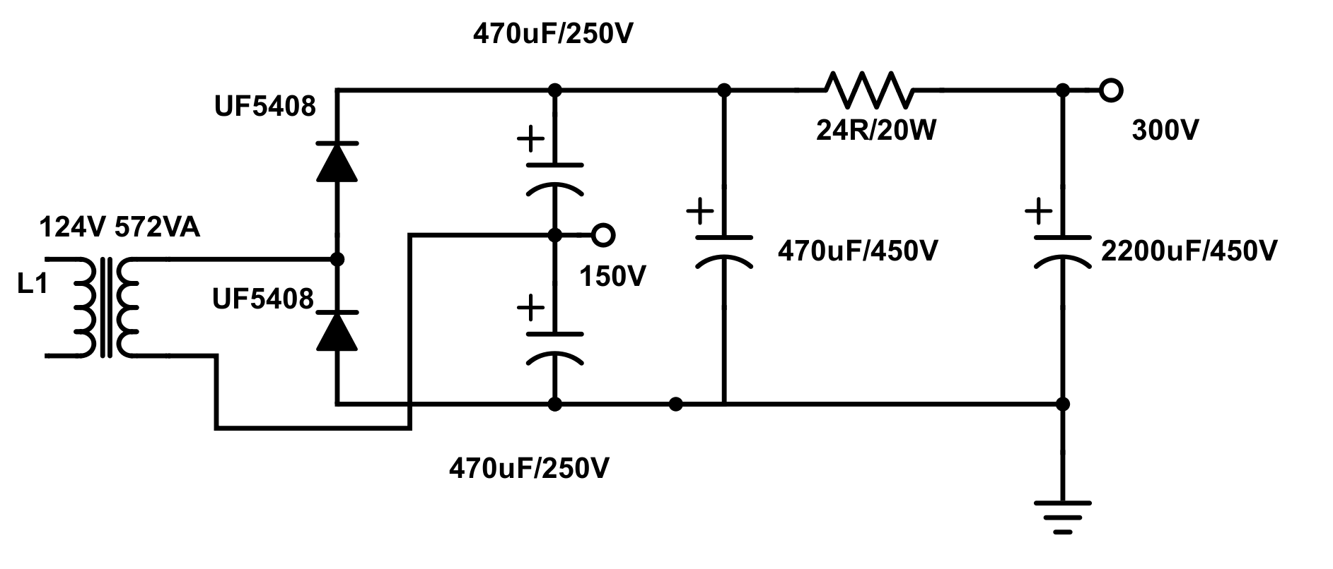

Good point. I use 120V into a doubler to get 300V... The OP could do the same, but that adds cost.

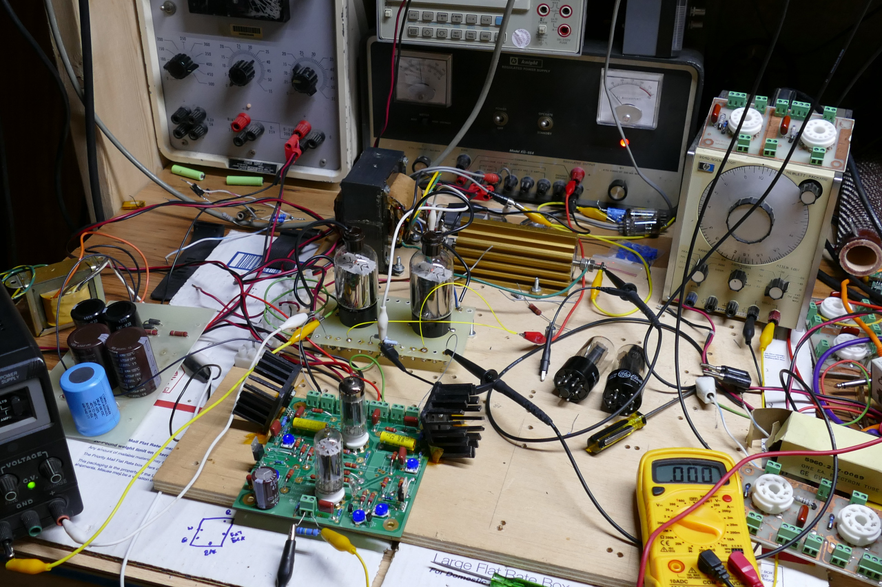

If the OP is using "isolation transformers" for power this should be considered. In this case the chosen output tubes will be well within the "safe zone" with either transformer. The 6DQ6B can eat 220 volts on the screen and 770 volts on the plate. At least 25 volts will be burned in the cathode resistor. It prefers a screen voltage in the 150 to 175 volt range. That means 170 to 200 volts from the screen supply, and 340 to 400 from the plate supply. The preamp section will work best on the highest supply you can feed it, within reason.
I have used isolation transformers with a pair of "120 volt" secondaries in series for amps that need similar voltages, but slightly lower currents (UL84 based). I get 330 plate volts, and 165 screen volts. This will work for the 6DQ6 and probably make at least 20 watts since I was getting 20W from the UL84's, but the 6DQ6 will easily make 100 watts per pair without complaint, so there is no danger of "over feeding" it.

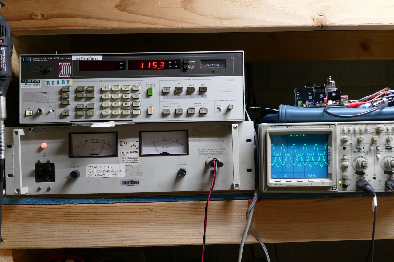

Here are some pictures of a pair happily cranking out 115 watts into a 3300 ohm OPT of 520 plate volts, 170 screen volts in a HiFi test amp. All of the voltages are supplied by lab type power supplies and I simply adjusted everything for the most power without seriously abusing the tubes. You are safe at any reasonable power level that either the 120 or 140 volt transformer can make. Your choice of output transformer will be the limiting factor.

Food for thought, could do a voltage doubler and take the lower capacitor voltage for the screens. Just another way to skin the cat.
...could do a voltage doubler and take the lower capacitor voltage for the screens.
Indeed. This same idea was previously mentioned in this thread twice, first in post #17, and again in post #24.

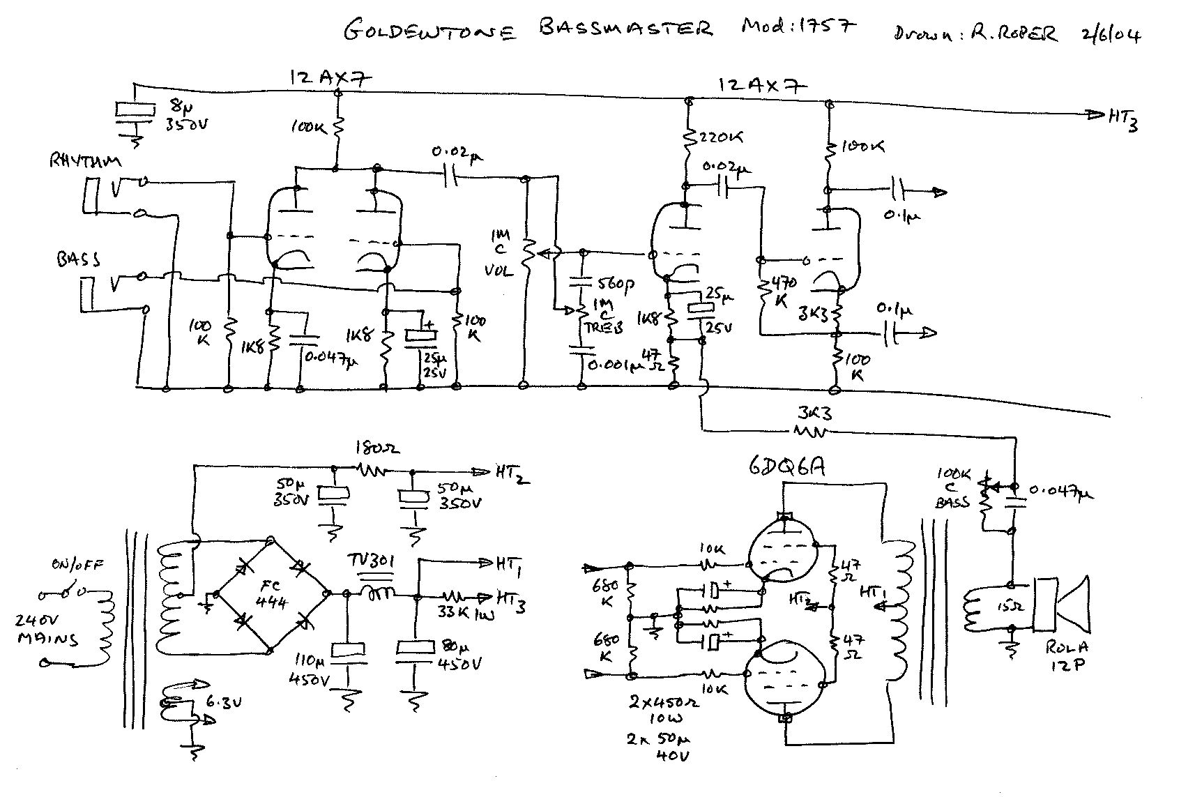

At one time, there were independent Australian tube guitar amp manufacturers, and they went their own way with their designs (i.e. they weren't Fender or Marshall copies.) Some of these amps used sweep-tubes for the outputs, and voltage-doubler power supplies to feed them. It was a clever idea, made possible by using then-newfangled silicon diode rectifiers, rather than the older and much more primitive tube rectifiers used in vintage Fenders and Fender copies.
