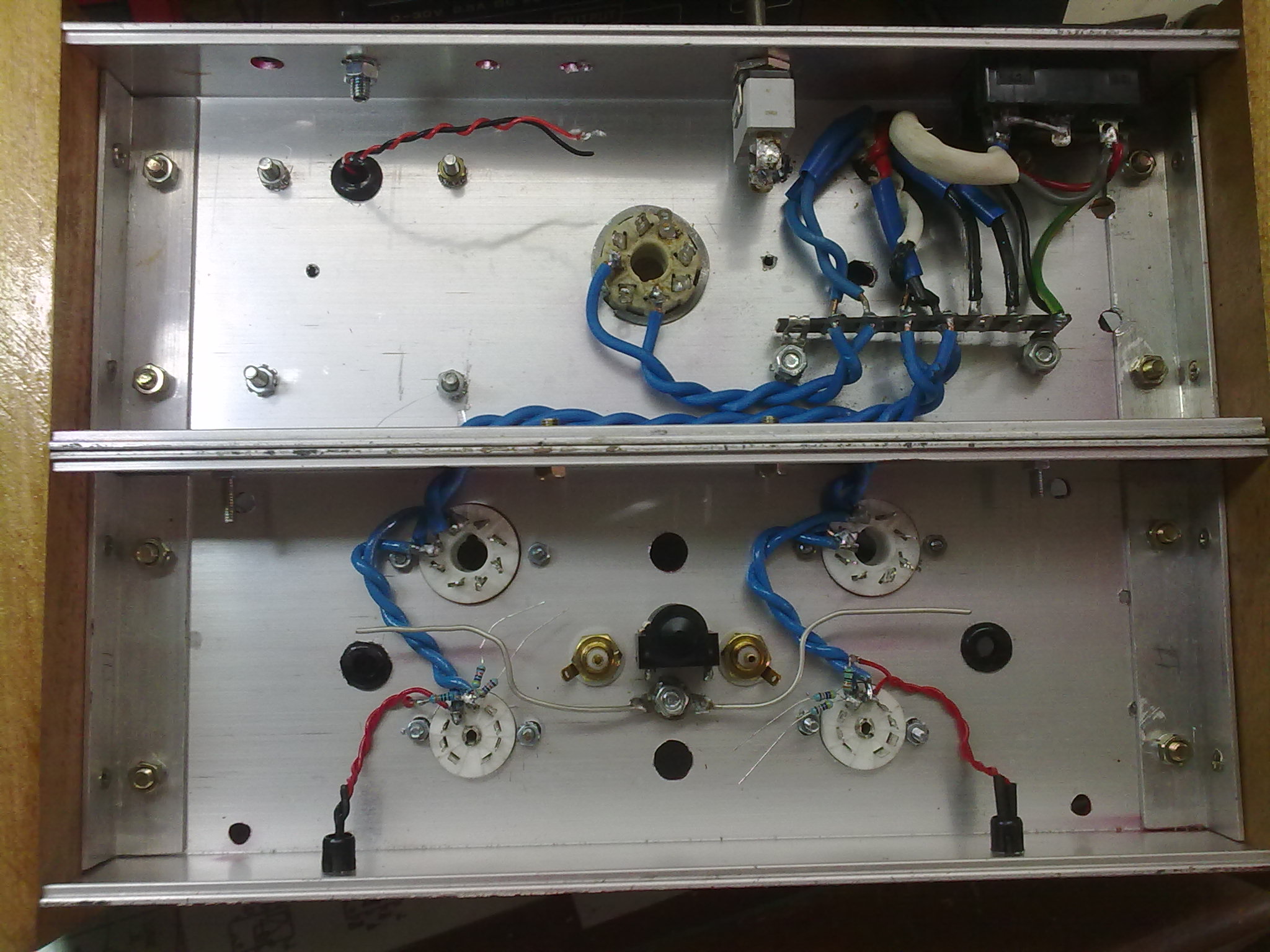

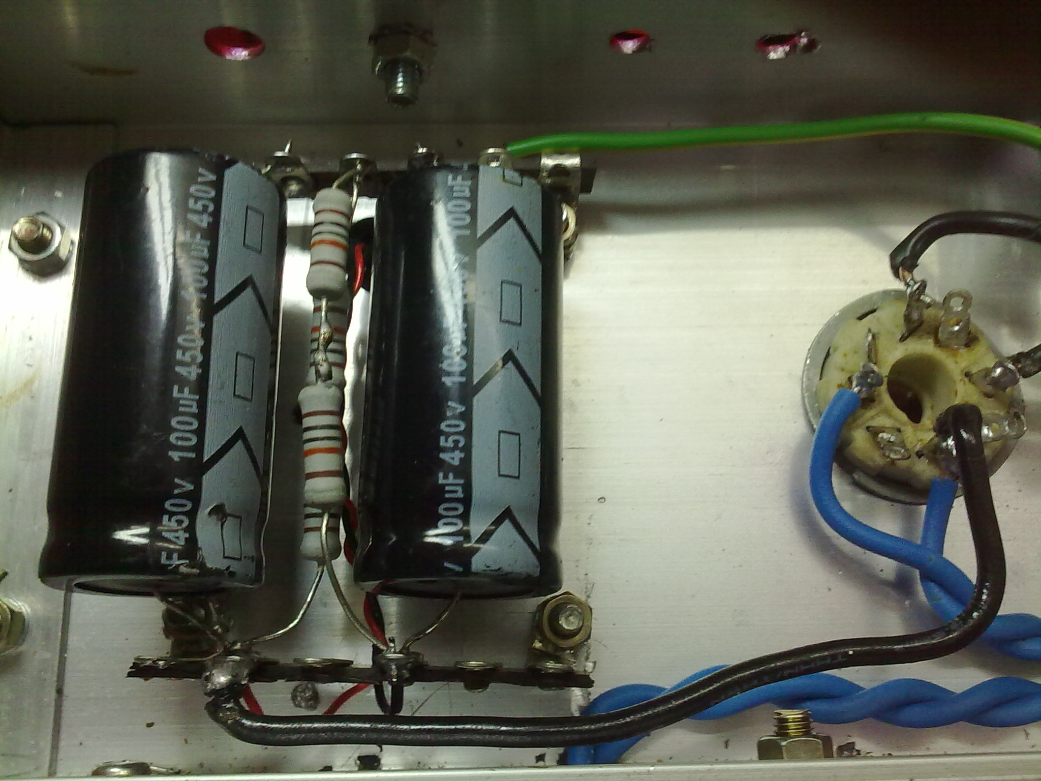

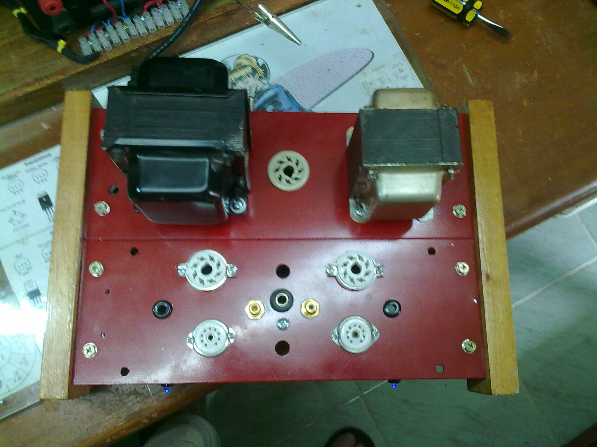

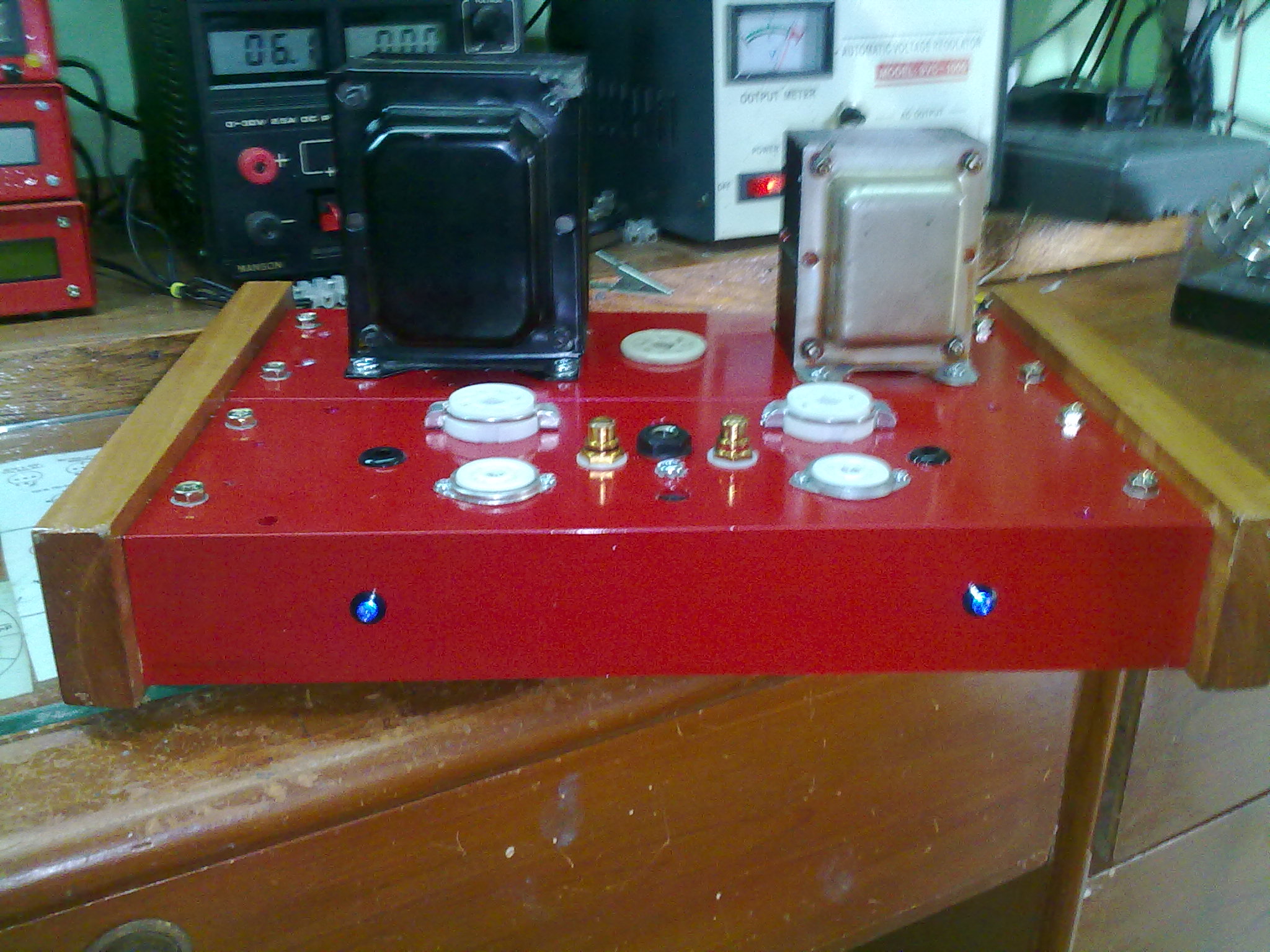

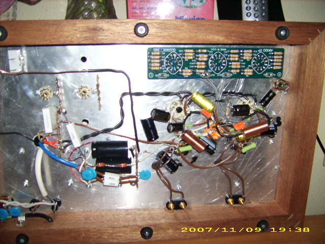

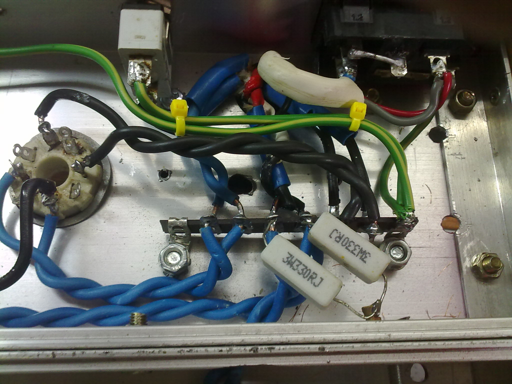

My 6DN7 journey
First of all, hello everybody!
My first post here, I did build many tube amp's for my self and for
other that did ask me, I am from Norway, but I am retired now and
moved to the Philippnes. So I start to build amplifiers, again.

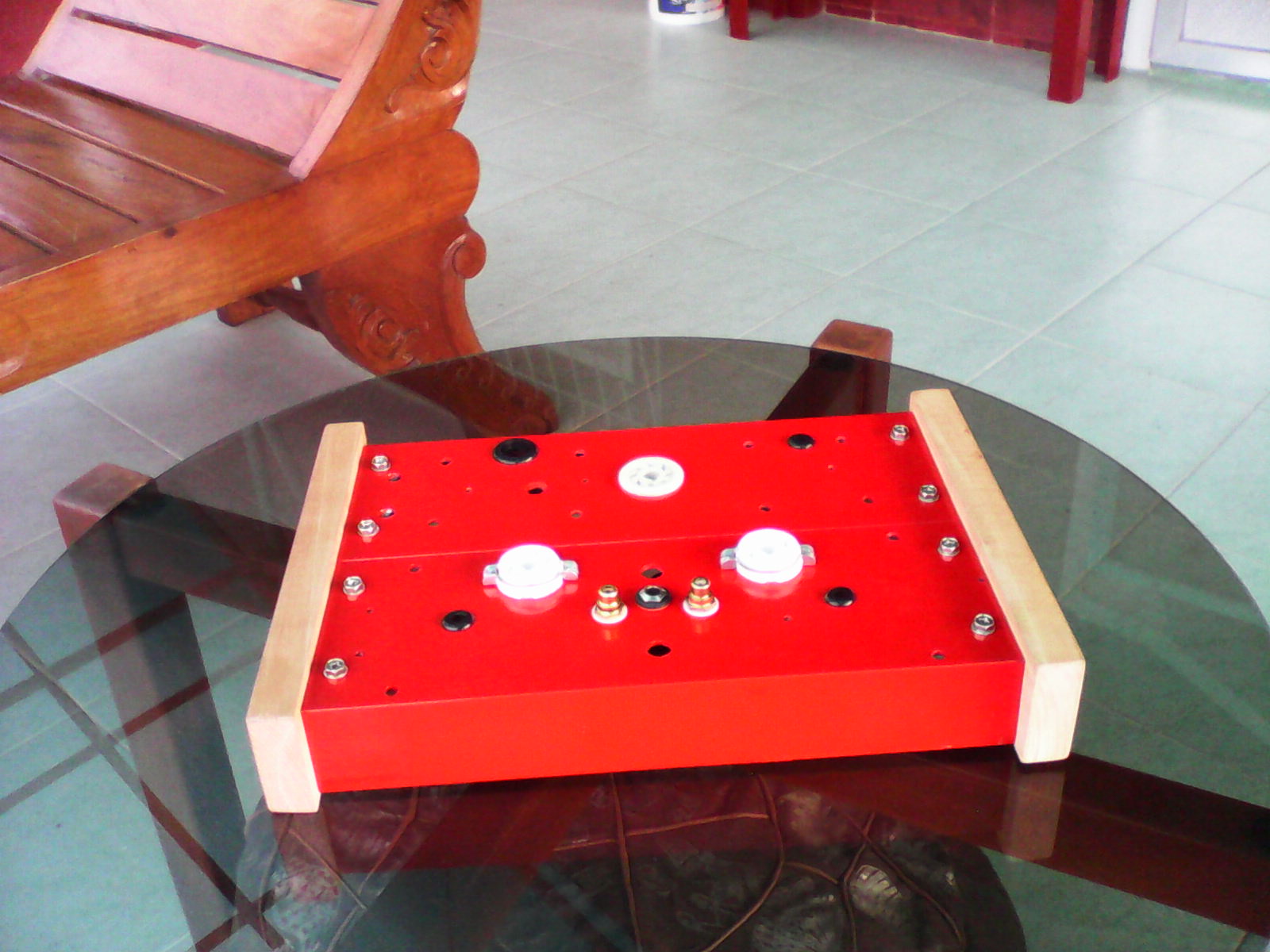

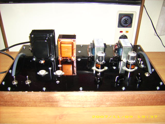

Some years ago I did build this 6DN7 on a wooden frame,
when I was living in London, but this one is long time gone...
It did sound very sweet and nice, and not that expensive and
not difficult to build, so later I build another one on a scrap chassis.
Same sweet sound, surprising deep and clear bass, the OPT is not
that big. It looks like crap so I decided to rebuild it, on a new chassis.
This is the red one you see, just started today.
I use 2 U shape canals, that will shield the "AC part" in the back from
the signal part in the front.
I am using lundahl horn speakers, the 1 - 2 watt drive the horn speaker
without problem, my wife start to complain about half volume.
This amplifier is well worth trying out, you will not regret it.
Jogeir.

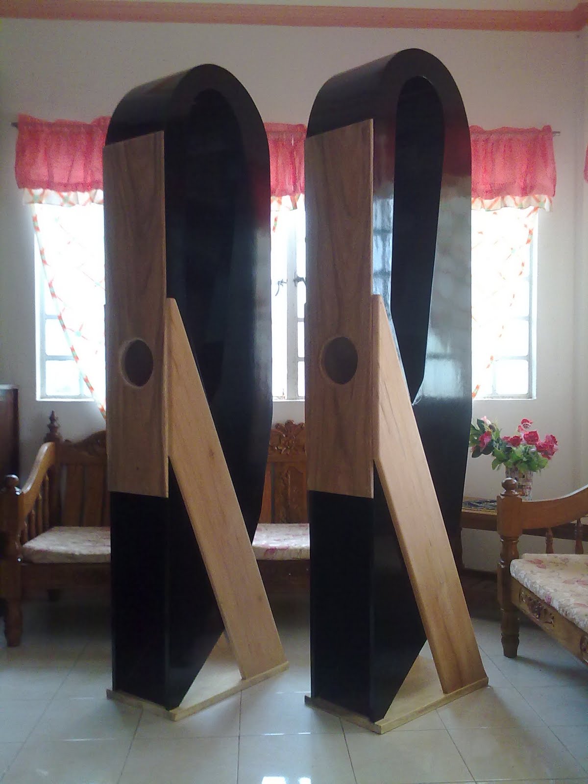

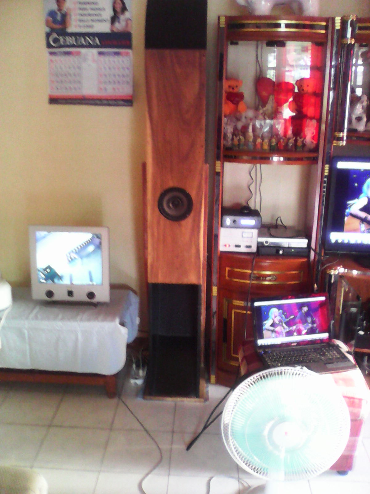

6DN7 Horn
Finished is the most simple as can be, shaker box, a spray can 🙂
It turn out to be nice, four thin layers.
The speakers I made my self, a friend of mine how is a carpenter
made the front and the sides from Acacia wood. From own tree here
in the Pilippines. As the Ark of the Covenant 🙂
We have very nice wood here, the wood sides og the 6DN7 is Mahogany.
I will continue tomorrow, I am retired now, so I have time to build
amplifiers and other stuff.
Jogeir.
