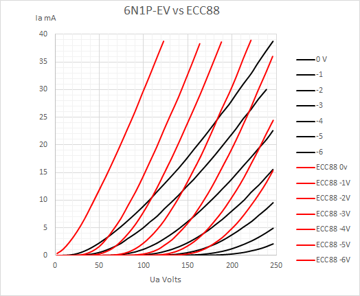

I do not see the 6SN7 and 6N1P as being very equivalent.
And the 6DJ8 / 6922 are not very equivalent to the 6N1P.
Take a look at this, black is Voskhod 6n1p-ev red is Telefunken ecc88/6dj8. It tells the whole story. This is real measurements from my utracer.
