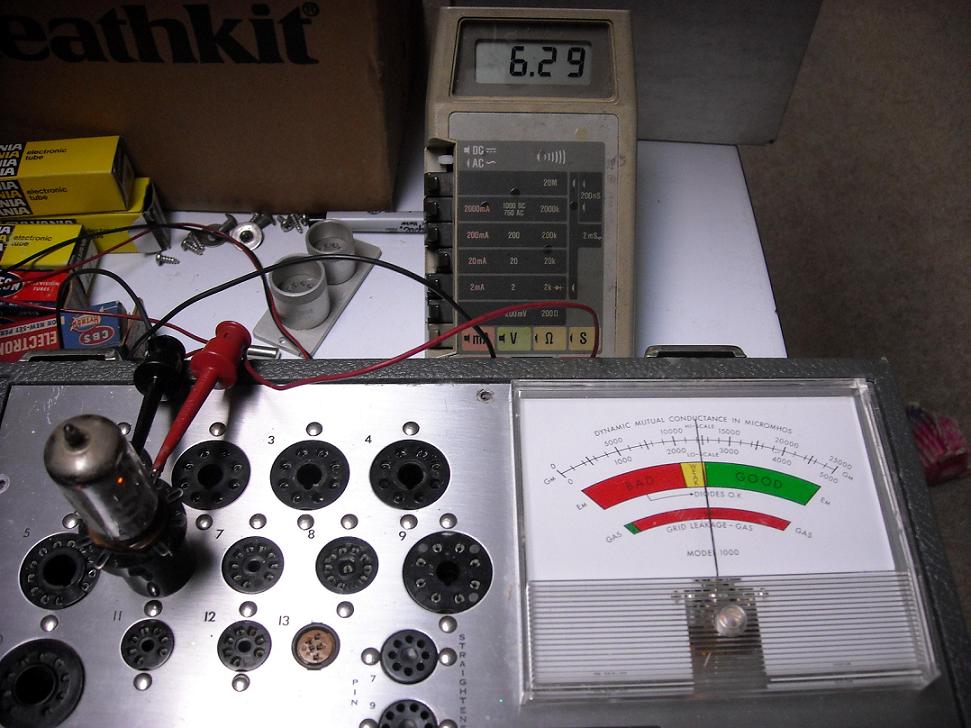

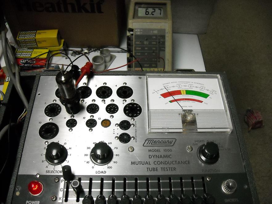

Gm was 4000, not 800. Read wrong scale.
4000 would be high for 6SN7, but 6SN7 is tested differently on this test set, and when the 6N1P is tested that way it comes out near 3400Gm, which is reasonable.
So these are more an equivalent of the 6SN7.
I may watch for some 6N23Ps, thanks.
First photo is 6N1P, second photo is 6DJ8. Both have filament voltage adjusted near 6.3V.

6N1P is not direct substitute for 6DJ8, russians have exact analog called 6N23P. The tube 6N24P is with same parameters , but the pins connections are different. In russians audio forums , 6N24P is called "cascode version" of 6N23P/ECC88/6DJ8. It means that its pins are arranged for easy making cascode schemes and the tube is with low microphonic construction.
6N1P is constructed as noval analog of 6N8S /6SN7/, this is written in some russian datasheets for 6N1P.
That was my conclusion in post #5, that it was closer to the 6SN7 than the 6DJ8. I guess I should try to set up an octal socket and try comparing the 6N1P with the 6SN7.
