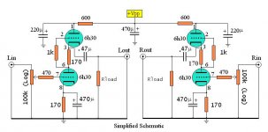

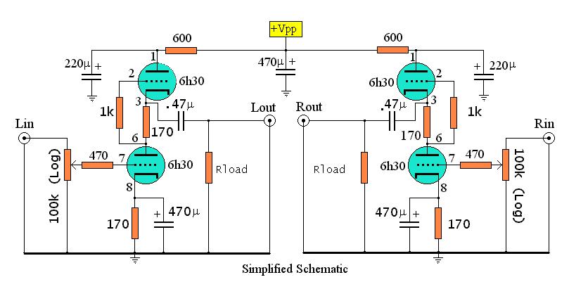

6DJ8 tube schematic as balanced line stage?
6DJ8 (balanced) tube line stage
Hello
These line stage can be used as a balanced line stage to drive amplifier like Aleph X etc ..
Any idea ,advise welcome .😛
Greets gabor
In theory you can use the illustrated left / right channels as hot / cold phase of a balanced line stage. However in practice the two channels / phases in this design do not cross-reference to each other, and therefore are not always going to be 100% balanced.
Probably best to leave this as an unbalanced line stage, and look for other solutions.
Consider transformers as a good way to achieve balance, and also have a read of some of the articles here: John Broskie's Guide to Tube Circuit Analysis & Design (such as Balanced Aikido and http://www.tubecad.com/june99/page7.html)
Also consider buying TubeCAD software (not so expensive) to help you with design of a balanced stage.
Regards, G.
