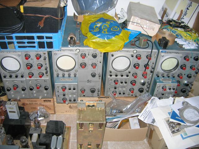

Hi , i'm only working with TEKs in my lab . In Summer , a 5000 (silicon) and in winter : a 500 😀 THos are hard to beat : blue or green screen, 30 or 90MHz BW, and even a 551 twin gun :clown:
