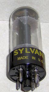

I've run them as high as 330V at 30mA and around 275V @ 35 - 40mA or so in SE (as a driver) with pretty good results. Not all 6CK4 are good, I tend to prefer the Sylvanias with the box plate with wings from the center of the plate structure on either side.. The narrow ends have three perforations and you can see the grid support rods. IMO The best sounding ones have grey plates, not the black shown here.
