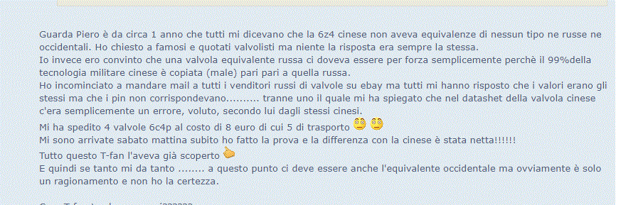

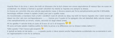

on an Italian forum (old thread 2009) I read that russian 6C4P is compatible with Cinese 6Z4 (same pionout)An Russian sellers,explained that in the datashet of the Chinese valve there was simply an error, wanted, according to him by the Chinese themselves ???
sorry only in italian language...seem an error on chinese datasheet about pinout
