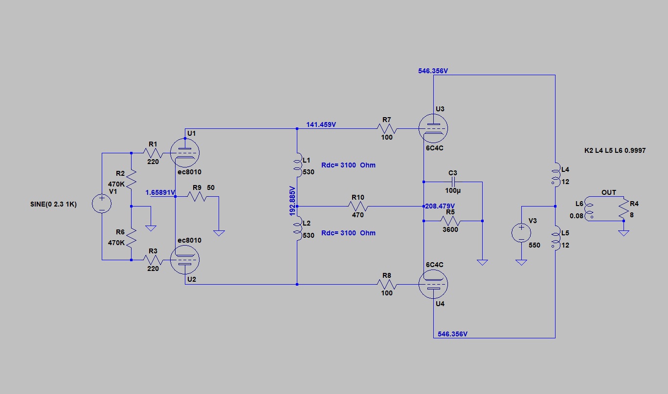

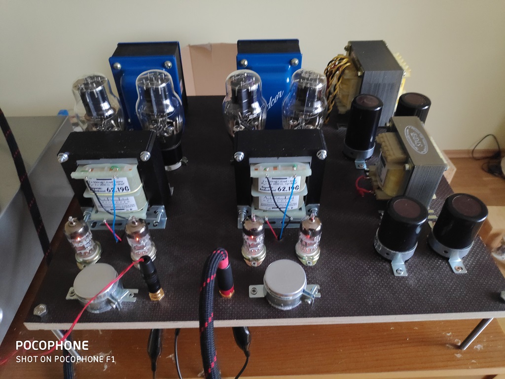

Wow, is that an autoformer/center-tapped plate choke with ~2000H inductance? Or are you using two separate 530H chokes?
Each choke winding with DCR of 3.1k ohms, 16.66mA drawn across each, that's a lot of heat dissipated by the choke(s), is it not? Something like 0.86W dissipated in each winding?

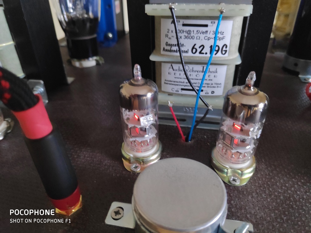

Cool! Which plate chokes are you using?
I am using PP plate chokes (Anodendrosseln) 62.19G.
0.85W for M85 chokes is nothing.

because of the DC cancellation there is no need for a gap (or a very little one), so inductance goes up very fast! Just like a PP OPT vs a SE OPT.
Wow, that PP anode choke is a real beast. 500H per winding. Really nice. I wish there was someone in the US who was making something like that available commercially. (Maybe there is but I don't know about it?) '

did you wind the anode choke yourself?
I don't know if I would call it "loftin-white", but the monkey idea is interesting. Do you really need R10?
Anode choke is from here: Anodendrosseln
R10 is for security reason - on this scheme is only for testing purpose. I reality it will be from 0R to 1K.

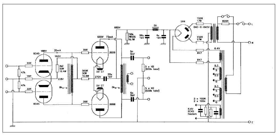

Suggestion
As a suggestion, try removing the 100uF cap bypassing the 3k6 cathode resistor to the output stage. Put a 40uF pp cap from the B+ to the junction of the cathodes, ultrapath Elliano style. Might have to tweek the value but I found the sound much better than the present 100uF cap arrangement. Attached is Thorsten Loesch's drd pp with the suggested cap arrangement.

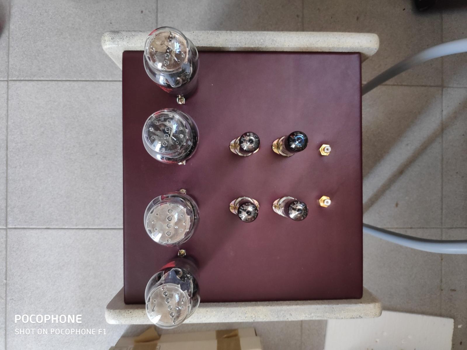

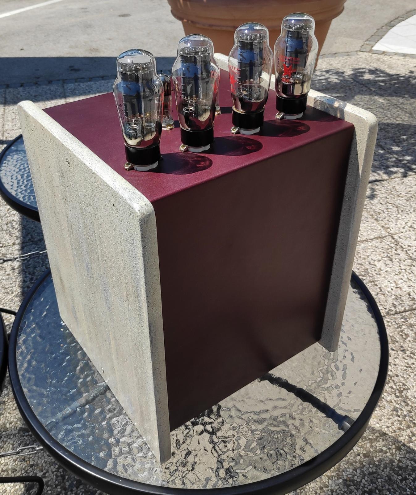

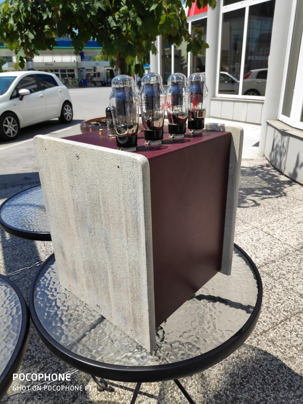

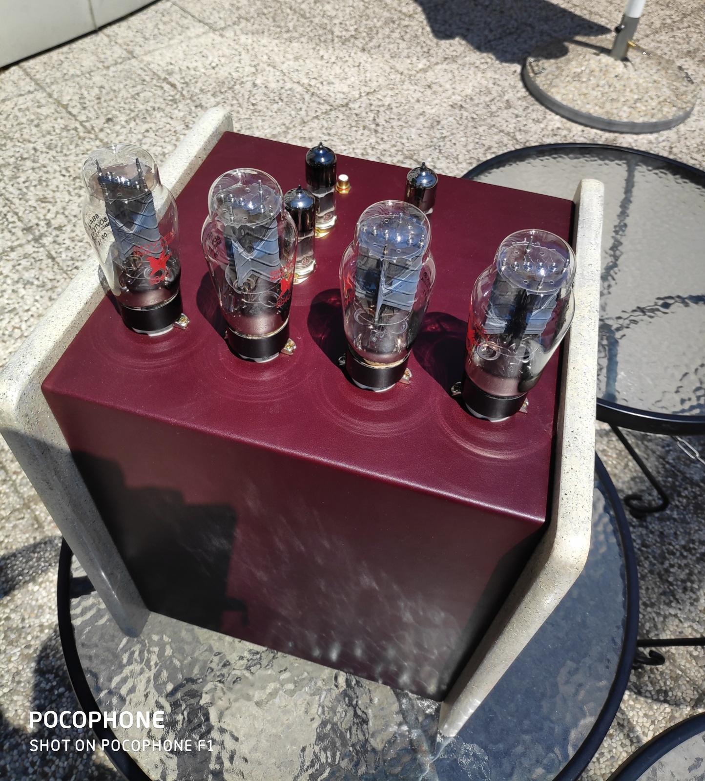

finally made chassis
Big box, 40 x 30 x 30cm. All iron in the box.

The power tube is a single plate 2A3? The amplification driver is Russia's 6E5P Or other tube?
Those amplifiers look wonderful!
I bet they sound real good.

I always thought that a Loftin-White amplifier was a single ended 2A3 with the driver DC coupled to the 2A3 grid.
I was looking at this thread to find a Loftin-White amplifier.
I did not know that a Loftin-White amplifier was push pull . . .
I guess I learn something every day.
But . . .
....I did not know that a Loftin-White amplifier was push pull . . . .
I don't think it was.
