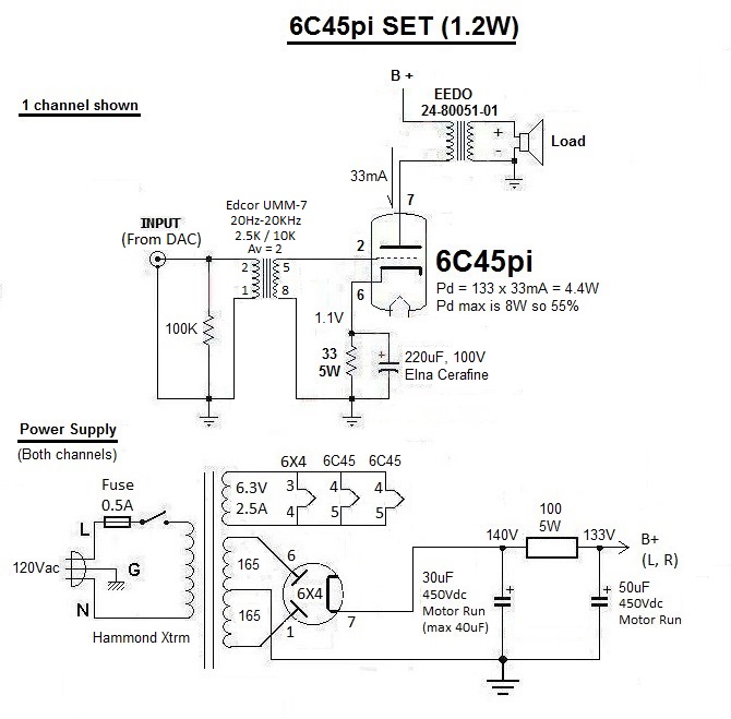

It would be nice to see your operating point, Va, Vk, Rk, some use 10mA bias while other find their sweet spot at 40mA. I haven't built the one in my first port, I just draw the schematic. I might try some Cree Schottky diode instead of Rk
IIRC, it's set for about 25mA of current and 1.5V of bias with a CCS plate load and a 5K:150 output transformer. It's currently setup with a cathode resistor/bypass cap combo. The LEDs that I would want to use won't be so happy with that kind of current passing through them.

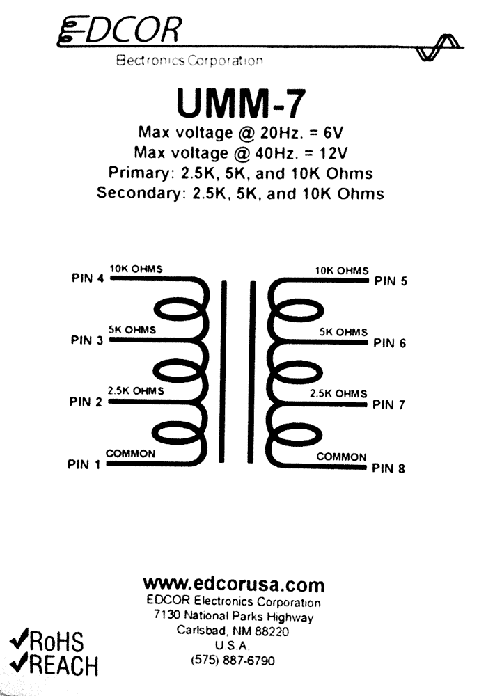

Just want to verify the wiring to prevent blowing my DAC...
I connect the output (1 of them) from my DAC directly to pin 1,2 (2.5k) and then pin 5,8 (10k) to the input of the amp.
Pls confirm even though it's a basic question.
...DAC directly to pin 1,2 (2.5k) and then pin 5,8 (10k) to the input of the amp....
Yes.
I use PSE 6c45 Spud driven through 10k pot ,220vdc over tube ,2.5k load and 90 ohm cathode res each tube with 1kuf bypass . So about 25ma per tube Gain is littlebit small ,yes but in right speakers no problem . Of course voltage is much over recommended 150 vdc but sound is better with higher voltage . I tried cheap input transformer and also GG type preamp . I solve gain problem ,but loose special sound character with more gainstages
papparazzi
papparazzi
Final schematic
Despite it's low cost the sound of this transformer is quite transparent. I have increase the overall gain of the amp without using SS components, that was my goal .
Thanks to all for your help.
I'm attaching the latest schematic with the added transformer.
