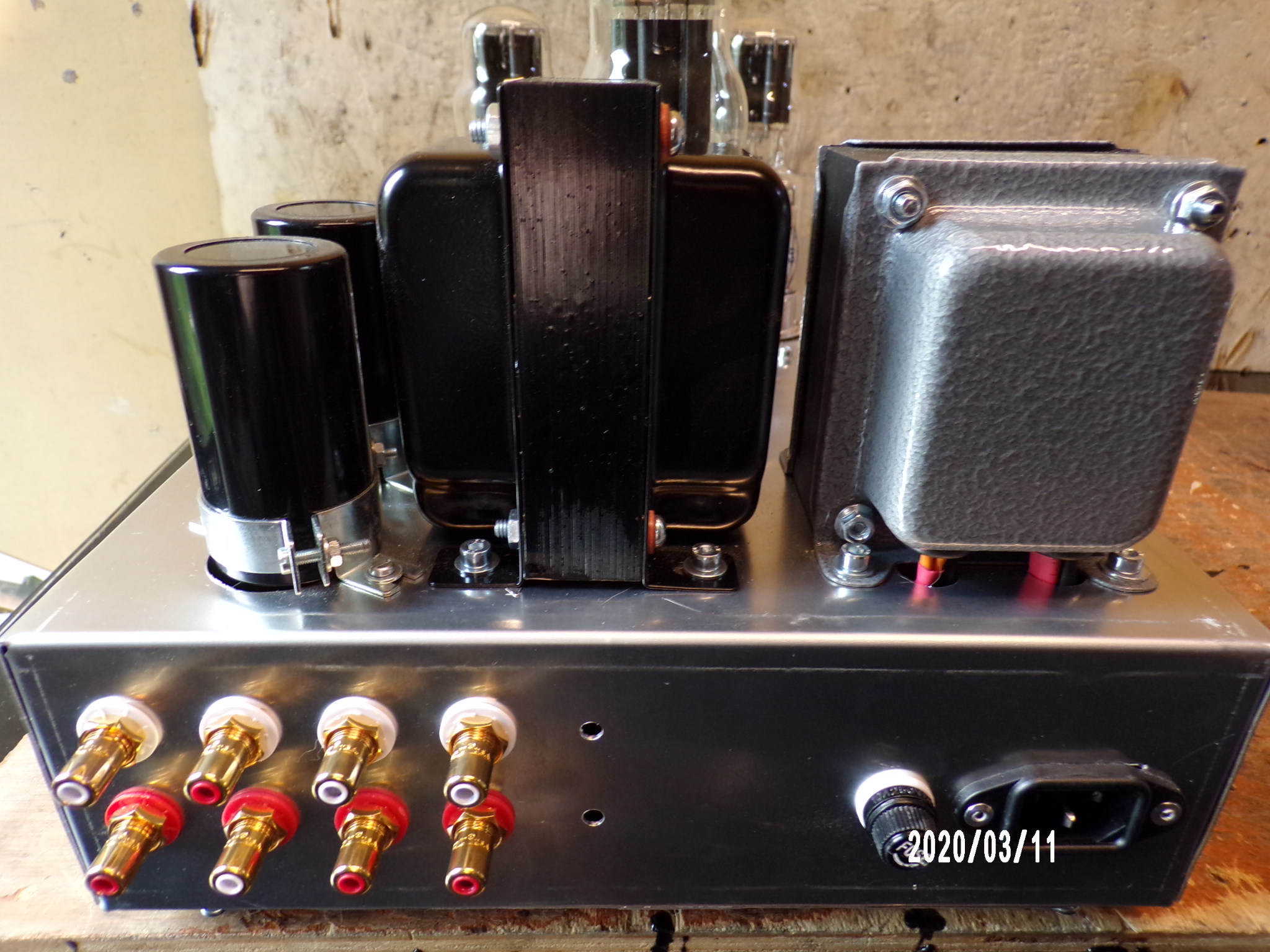

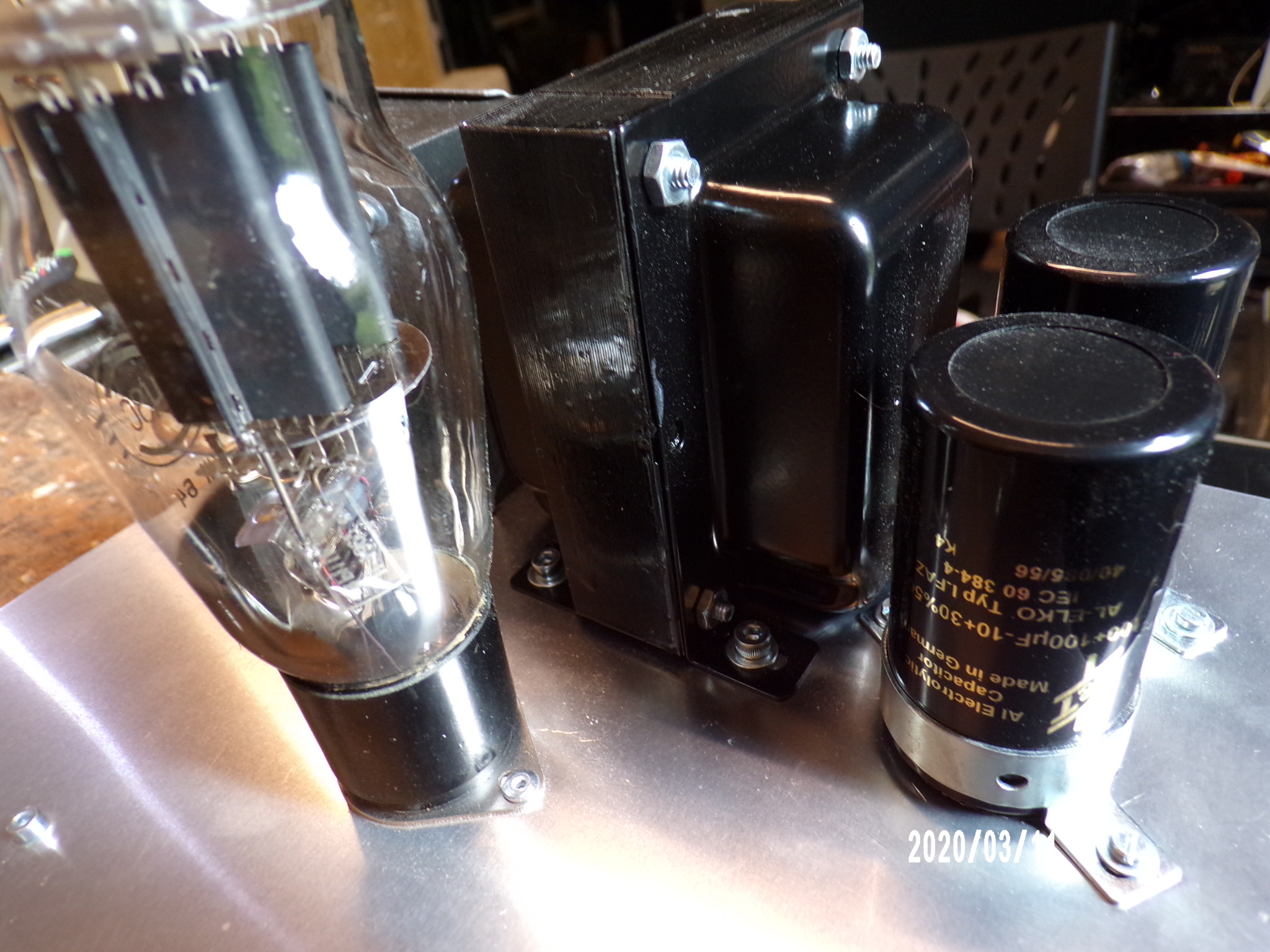

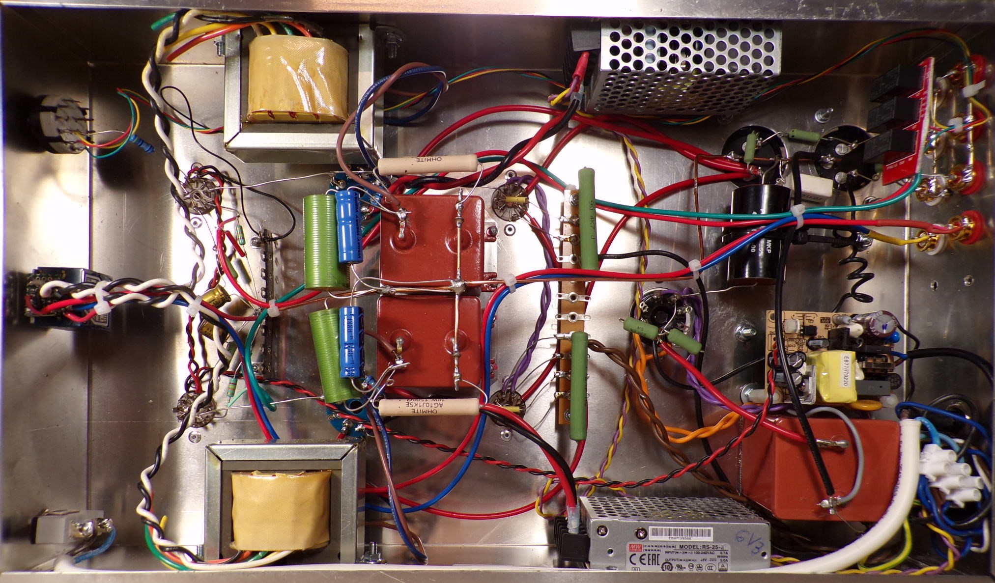

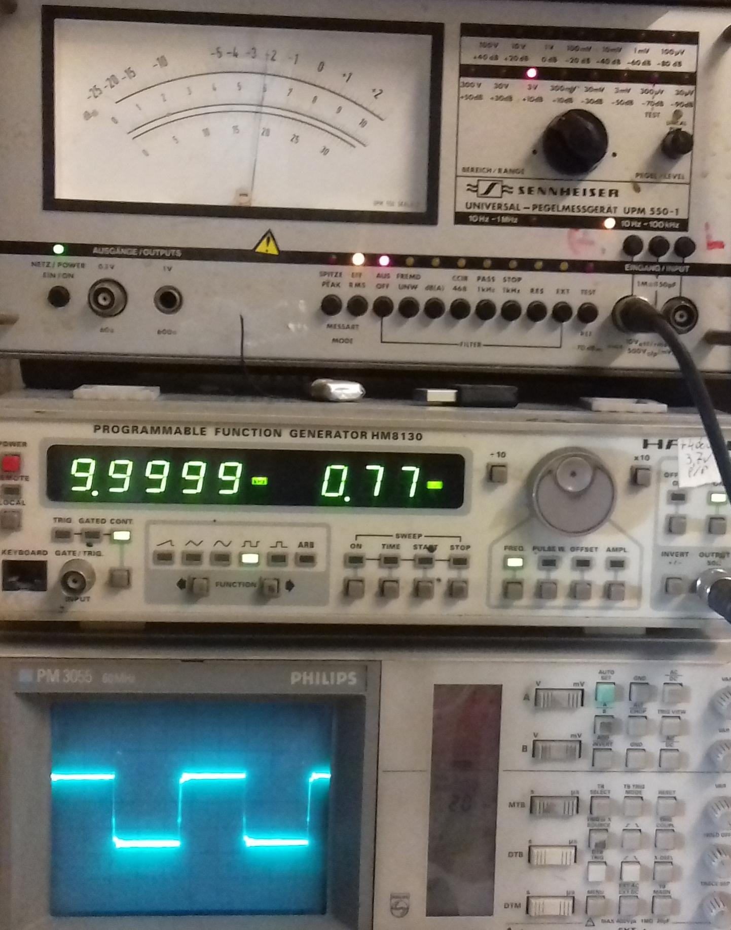

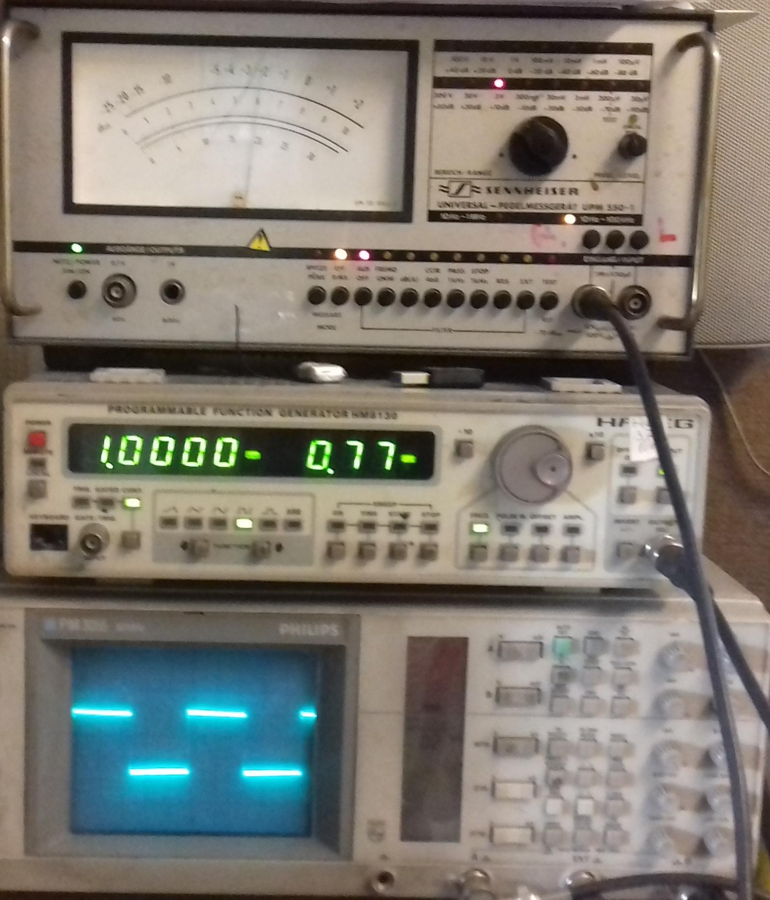

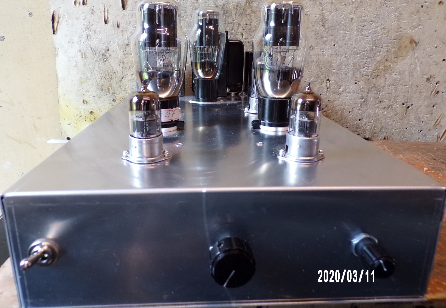

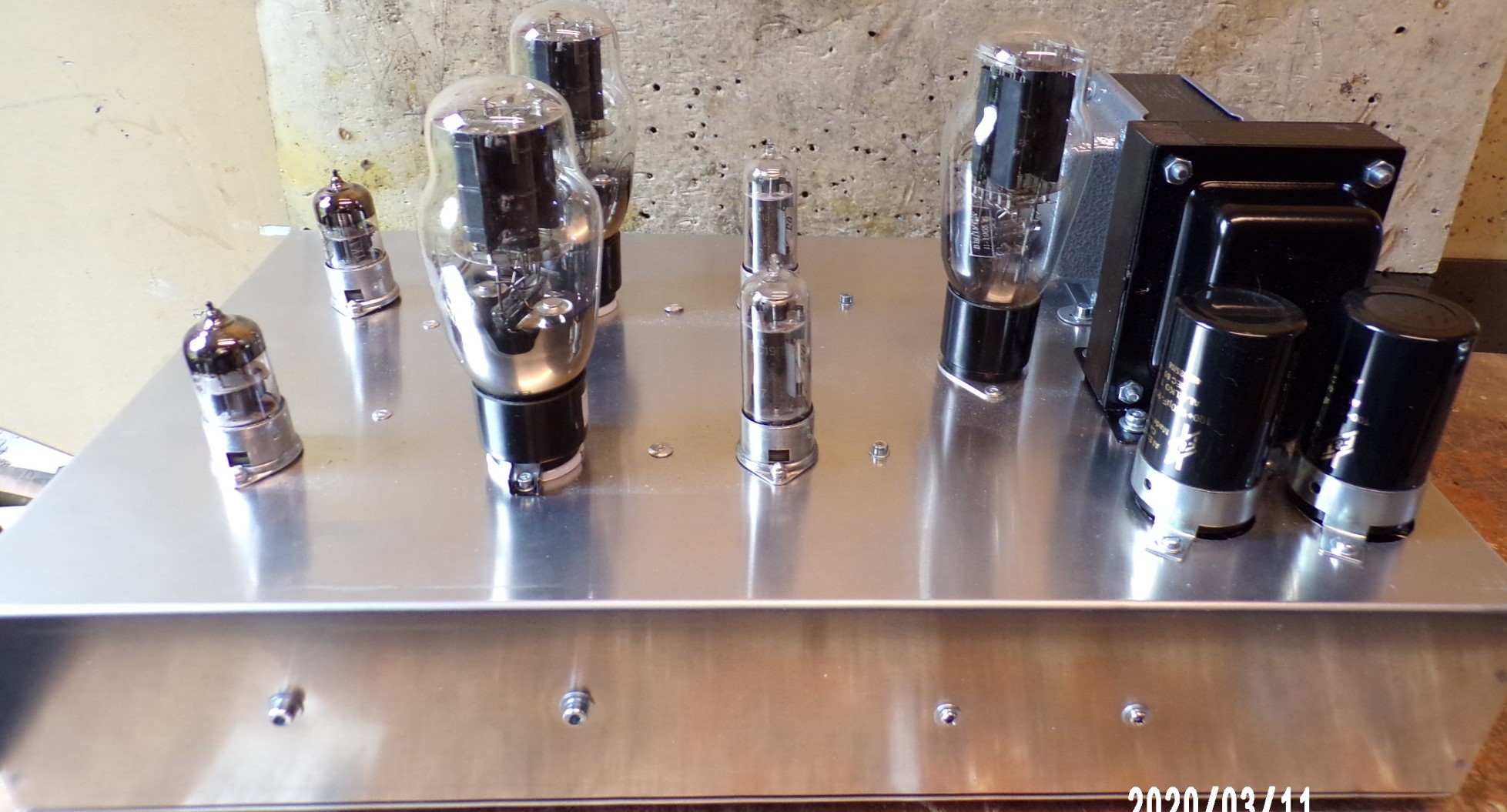

6C45 6C4C preamp
direct coupled preamplifier
very linear and pleasant sound
main power switch and source select to come on lather
4db gain more than we need with modern source and cd player
