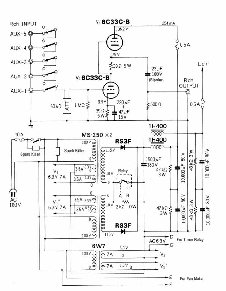

Hello all,
I know this is a real waste of power tubes, but I feel the itch to build the 6c33c tube pre amp I have attached to this post.
Apart from the crazy use/waste of this tube, what do you guys think its performance might be compared to other tube preamps?
As much as I want to build this I dont want to build something that wont sound good.
How do I calculate output impedance and power output?
Also has anyone tried the Tube Zen amp, I have never read any discussion about it?

I didn't think the 6c33c was know for its linearity. Also there are better circuits availble than the SRPP. If you really need to drive 50meters of cable then go for it - otherwise forget it.

The SRPP is totally unneccessary if you're only swinging a couple of volts. The rp is so low for this tube that you don't gain any real advantage in output impedance, either.

If the parameters are what I suspect they are, a 6C30 might be a better choice. It has excellent linearity. The new Audio Research preamps all use the 6C30, and the sound is an incredible step up from the earlier designs that used the 6922/6DJ8.

I'd suggest setting it up with a slightly smaller valve to start...6C19 for one...6C41 for another. If these pan out, then move on up to the Big One...🙂

With a powertube like that count an hour for the thing to settle, deal with cracks, clicks, pops and microphony as well...
The schematic is an SRPP using a dual triode iso of a twin where mu is virtually non-existant and not a design priority either.
On top of that the SRPP cuts mu in half, what is this thing designed for I wonder?
It sports a 22 microFarad bipolar cap on the output as well, great....
Could it be a headphone amp perhaps?

Well so much for that idea.
I was thinking that it would be kind of fun to use those big ole power tubes for a line-stage since I dont have the money right now for a full power amp, and I have a fetish for big tubes.

I looked up 6C30 tube and the descriptions say 'Delay Relay', what does that mean, a delay relay vacuum tube?????
Also how would I substitute the 6C33C for the 6C30 (I have zero experience in designing tube equipment)?

lawbadman said:Also how would I substitute the 6C33C for the 6C30 (I have zero experience in designing tube equipment)?
They don't substitute. Just look for published 6H30 designs such as this one:
