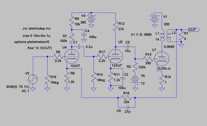

I just had to start with this quote... IT DOES WORK! and it works pretty well indeed using 'em old trusty ears and good music.
You will have to accept facts. If the component values are as in your schematic, even with NFB returned to V2 cathode, it will be a disaster. No matter what your ears may say.
Check the voltages at V3 cathode and anode, you will probably have something like 10-20V over the tube.
If it sound and measures OK your schematic is faulty!
Can not find A+, B+ and BIAS in the schematic?

revintage said:About the lousy 5814/ECC82, I would say it is not good enough to drive the 6C33C. 5687 or 12B4 would be the way to go. Or why not a trioded 6E5P.
Or try a tasty E182CC.
Just my two cents but I would think a 5687/E182CC common cathode into a triode strapped EL84 common cathode into the 6C33C would seem to be a really nice circuit. You could direct couple the first two stages and the cap couple the output stage. Just a thought. I really don't care for 12XX7s.
I hope you are referring to sound quality or distortion. From a current and output impedance aspect, the ECC82 could drive a 6c33c with ease. 6c33c is not that hard to drive
El84 would be overkill as a driver.
6c33c takes a fair amount of voltage swing, but other than that it's fairly easy to drive. Grid-current draw and input capacitance aren't that demanding. It has high inter electrode capacitance, but the gain is low (usually around 2), so input capacitance isn't bad. I've found that they do start to draw some grid current Vgk reaches 0V, but it's only like 1mA at most.

It is not negative comments, it is as you asked for: "ideas on refinement",. I posted a first schematic with your tubes involved earlier. I am also working on another with a DC-coupled 5814 CF into the 6C33C.
So cheer up, we are all trying to help you to get a working amp out of your existing tubes! With some tricks it should be possible to build it without overall NFB.

Don't be discouraged. We are just trying to help. You seem skilled for a newbie. People on these forums always give criticism when people post their schematics, don't take it personally. Your end result will probably be a very good sounding amplifier if you stick with it.
The schematic Revintage posted in #12 looks pretty solid. If he finishes a direct coupled version, I'm sure it will be good.
Direct-coupling to a CF driver is desirable (but not mandatory) for the 6c33c when used in fixed bias class-A because the tube has a tenancy to drift. Keeping a low DCR in the grid circuit seems to help stabilize some.
You may want to consider keeping it. Or at least make it switchable. 6c33c amps tend to give inconsistent gain and distortion from tube to tube and they are difficult to match. Getting good balance (sonically and amplitude) between channels can be difficult without it. I find that generally 6dB of global feedback will significantly increase consistency without causing any detectable sonic deficiencies. It actually helps the amp sound less muddy when the music becomes "busy".

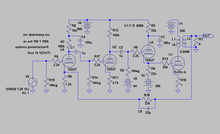

Yes, This is the scheme I would use--In fact with a few differences--I did,--more or less!
--Worked out really nicely, and even sounded pretty good with my home-wound output transformers....
Don't give up, This scheme from revintage is pretty straight-forward and a great starting-point, but by all means persue your existing scheme and see how you get on.....
(With this scheme, you'll notice the rather odd Minus 84V supply to the CF driver grid. This voltage sets the bias-point for the '33, via the CF driver. Make it adjustable from say, -70V to -100V and you can trim the bias to exactly what you need....

Hi Alastair,
What´s odd in simming a circuit with max allowable current through the OPT?
It is so obvious one must make the bias adjustable, so why bother to comment it ! Gliding Dutchman seems to be fully aware of these things.
Odd value...Explanation for OP
Earlier in this thread, The OP was unsure of how to rig up a potential divider from HT to deck to elevate the heaters, as an aid to reduce hum--He admits himself he is a newcomer to tubes....
It AINT Obvious to Everybody,--- just Why there would be what appears at first look an Odd Voltage of -84V supply at this point....

Any ideas on the 6H30Pi tubes as driver tubes? I must admit that these tubes (6H30Pi) has been used in the original prototype amp where I got the parts from.
I popped in the only set of 6H30Pi I have and VOILA!! Sounds much better, more drive, incredible bass!!
Also in the second (driver stage) I placed a resistor between the first "plate" and second "grid" to prevent startup sparking (cathode stripping?).
Elevated the filament supply as per instruction.
Placed 10nF 600V cap on wiper of Bias adj.
Made each output PSU separate with a >> ac-rectifier-cap-coil-cap.
I still have an issue with the 1st stage - too much gain! How can I trim the gain so that it just acts as a buffer stage? Or !! Can I employ the "unused" dual triode as a CCS and/or B+ supply regulator (or something like that) for the 6H30Pi tubes? Maybe get another 6H30Pi for the application.
Otherwise I am enjoying the amps sound.

Alastair E said:6H30pi, 6922, ECC88 types should work reasonably as driver for the 6C33, so long as you dont want to 'push' the '33 too hard.
How is it configured? CF or CC
They are designed for moderate voltage use, --which is fine for your 200 odd volts +B
Schematic would be nice....!
Same as the first schematic. I just popped in the 6H30Pi tubes and had to rewire the heater supply for 6.3v.
The amp seems to be working best with the first stage omitted.
