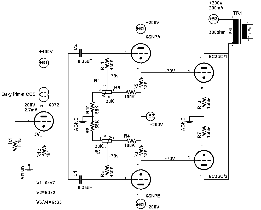

A friend of mine wants to build a 6c33c pse. We are thinking that, due to the high grid current (even when the grid is far from 0V) and the high input capacitance, a good solution should be a cathode follower direct coupled to the output tube. We've tried to design something that could even solve the bias problem for the power stage. Look at the result. I'm sure that we neglected something and this is the reason why I'm posting the scheme here and asking for your help.
Thankyou guys 😀

Nothing scratched my eyes at first.
I really do like the first stage with its CCS load and 400v B+, not to tell about the absence of cathode bypasses.
Heu... and what about simply bias each 6SN7 from a (adjustable) tap on its cathode resistor.
This should introduce some bootstrap releiving load from the first stage by practically hiding the grid leak resistors.

Hi Yvesm, Hi Milan.
Milan you are right...200mA for each 6c33 so 400mA in total. The 6072 with its hybrid load can provide the full mu because the current is stable and the load line straight. I think that a better solution is to change the R12 with two red leds. However...I think that with 3Vpp on the input the driver should be able to produce a 140Vpp swing. Because the amp will be two monoblock, we are thinking to change the 6072 with an ecc88 and use the second half as a common cathode preamp to make the sensibility higher.
Yvesm, what do you mean when you said: "Heu... and what about simply bias each 6SN7 from a (adjustable) tap on its cathode resistor.
This should introduce some bootstrap releiving load from the first stage by practically hiding the grid leak resistors."?

I mean, just return the grid leak resistor of the 6SN7 to a tap on its cathode resistor.
For example, replace R5 by an 1K in serie with a 12K and tie the low end of R11 at the junction.
The 1K being at the cathode side and the 12K at the -200 side.
This places some positive feed back to the grid and greatly increases the input impedance because the low end of R11 is somewhat 'driven' by the cathode voltage swing.
Yves.

Now I have to think to the power supply. My friend has already build a 6c33 pse and has two transformers that can provide 235Vac/500mA, 335Vac/100mA each. Do you think is possible to create a virtual gnd and a +/-200V from the 335Vac secondary and even obtain the 400V for the driver stage?

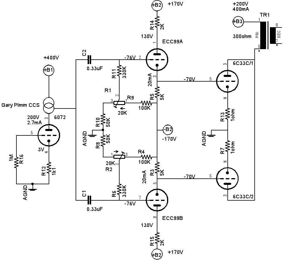

You are right for the cathode follower. I'm redrawing that stage with the ecc99. 😉
What about the voltage amplifier? I'm thinking to use an ecc8 and use one half in front of the hybrid srpp.
Mark

The working point that I've choosen is 200V/200mA for each tube. Vg=-70V So a plate dissipation of 40W, exactly the same that you have chose. 2/3 of the max power indeed.
This was chosen because I've read that this seems to be a good compromise between sound and tubes life.
The max output power is near 30W and it seems enough, I don't need much more power.
I'll add the new design that use an ecc99 instead the 6sn7
Mark
