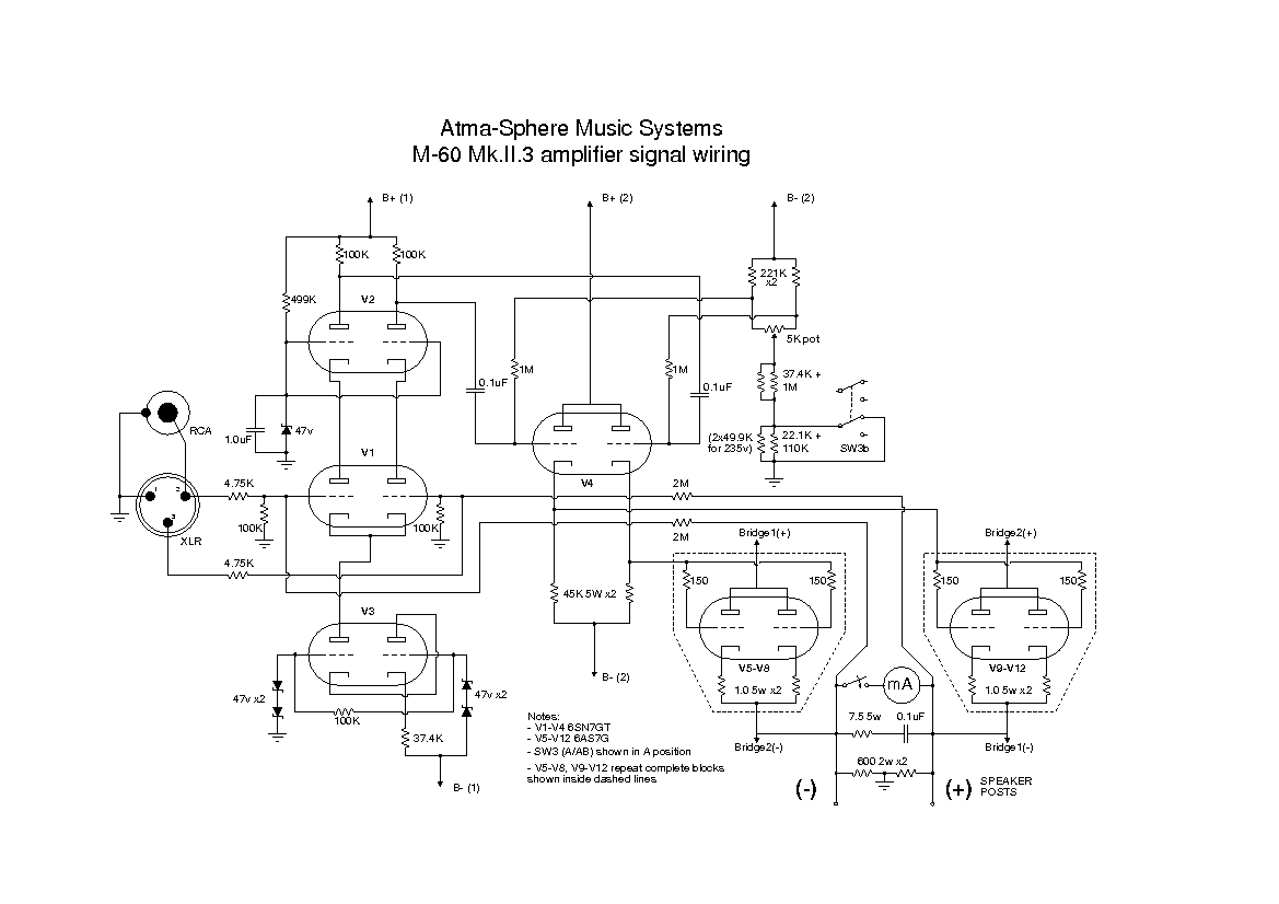

Sure. I've used this with 6C33s in the past, running class A although with only 2 tubes per channel you will not be able to do that unless you speaker is 32 ohms or so.
You will have to adjust some things for the 6C33; the bias voltage will not be as negative. What is nice about this circuit is its less prone to runaway.
This circuit is quite proven, is very stable and relatively fail-safe.
You will need a manual bias control, about 10K wired as a reostat to replace the 22.1K and 110K resistors in the bias network. You will also need a spring-loaded switch wired to disconnect one of the power transformer secondaries from one of the rectifier packs for the output section. When you depress the switch, that supply will then shut down, allowing to to read the bias current with a DC Ammeter across the speaker terminals as shown.

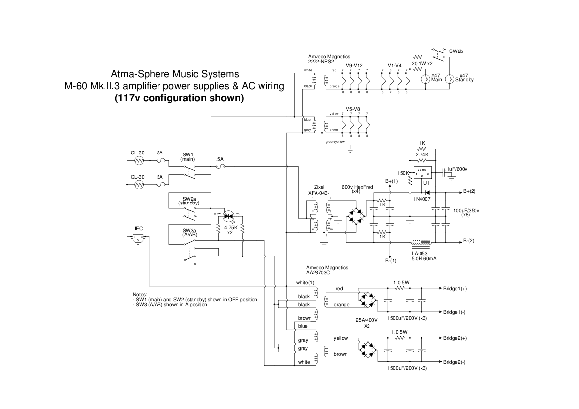

The power supply is not shown in this schematic but can be found at http://www.diyaudio.com/forums/atta...7645366-what-tubes-tube-amp-m60-power-117.gif
I would set the bias at 200ma after a 5 minute warmup and not let it exceed 250ma after one hour of operation. The circuit shows a small amount of negative feedback but you will not need it if your speaker is at least 16 ohms.
If you use more than 2 power tubes I would set the cathode resistors of the power tubes to 2 ohms 10 watts, and I would install a fuse in series with the plates of the tubes in any event. Wire the fuseholders so that the B+ line is on the inner contact of the fuseholder. The fuse value should be 1.5amps.
With only a single pair you do not need to do a lot of matching, although you will be rewarded with better sound if you do.
The 6C33 sockets need a hole in the chassis larger than you would expect, as it is expected that the socket is mounted with a standoff of at least 1/8" to allow air past the socket. There should be a gap between the tube residing in the socket and the chassis that is at least 1/4" all the way around the tube. I would also install two rings of cooling holes around the socket and make sure that the bottom cover has cooling slots or holes as well.
I would wire the filaments for 12V as the wiring is a bit easier to manage. The American sockets (EF Johnson) hold up a lot better than the Chinese or Russian sockets, which have a service life of about 5000-7000 hours. I recommend wiring the socket with silver or silver-plated wire, insulated with Teflon and use SN96 or other 800 degree (F) solder, as it will hold up a lot better. Regular solder can come right off the socket in time. The filament connection on the socket is overloaded at all times and so tends to run the temperature of the socket up high, and the tube itself runs so hot that even without B+ on it burns are a serious risk!
If the socket is installed properly, it will be a shock hazard if the tube is not in the socket due to exposed contacts. Extreme caution is advised!
As always, have fun and don't zap yourself.

Apparently! In the schematic that I provided, there is no 'top' power tube as it is a Circlotron.
IM distortion does not arise from push-pull operation. Usually it comes from intermodulations elsewhere in the circuit. For example in the circuit I provided if the plate of V4 is not sufficiently bypassed, you will increase IM distortion. Another technique to reduce IM is to use seperate power supplies for the driver and output sections. A third method is to avoid direct-coupling from input to output, as a fully direct-coupled amplifier can easily modulate its power supplies. This is assuming that the actual circuits in the amplifier are in fact linear, if they are not of course IM will arise there as well.
If you build this amplifier correctly, IM is well below 0.02% at full output.

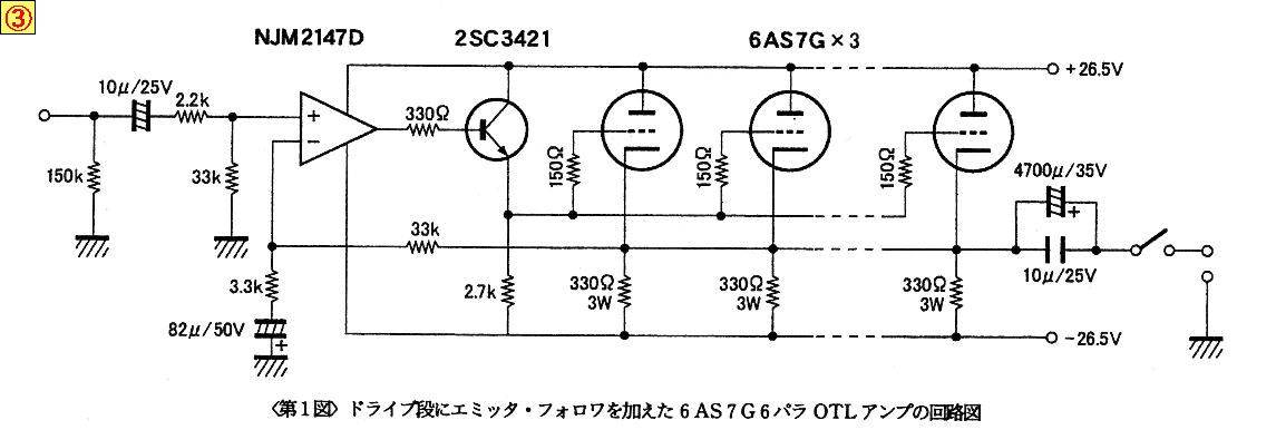

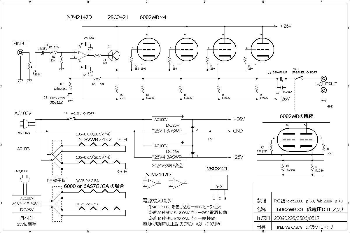

OTL SE(Not OCL) topolology schematic:One pure Tube,and two mixed, Tube,transistor and IC.Some old Japanese design,think work Ok but wery uneficient(power consumption/output power ,relation).I newer try this schematics.Salute . BTW- I see on your homepage many AM/FM RF transmitter apllication ,so question for You,did You ewer transmit(Radio Pirates) on the MW- AM band(1600-1800 khz)?

Actually OTL SE(hybrid) schematic nr 2 & 3 of Mr Ikeda is wery elegant.All stages are bipolar suplyed from same PSU(only +- 26,5V) and DC coupled,and output stage Idlle & stability is ensured thru the NFB feedback net(r5,r3,c2)to the pin 2(inverted input) of 1/2- NJM2147D OP Amp.But stel remain isue of Low eficiency(Power in/Power out) and Sound definition.
I find the second circuit very interesting. I guess each tube shown in the schematic is one of the two pairs inside the 6as7, so I need two 150ohm resistors for each tube and a total of 3 tubes (6 tube sections) per channel, am I getting that right?
Two modifications to propose:
1. One could throw away the semiconductor section and build a tube driver connected through the 150ohm resistors to the grids of the final tubes.
2. One could make a tube driver using ECC86 tubes for a full 26V operated amplifier :)
And two questions:
1. Will this 82uF and 3.3k still be needed for the cathode bias if using a custom tube driver instead of the solid state one?
2. Can I use more tubes on this schematic, say 5 in parallel for greater output and lower impedance?
