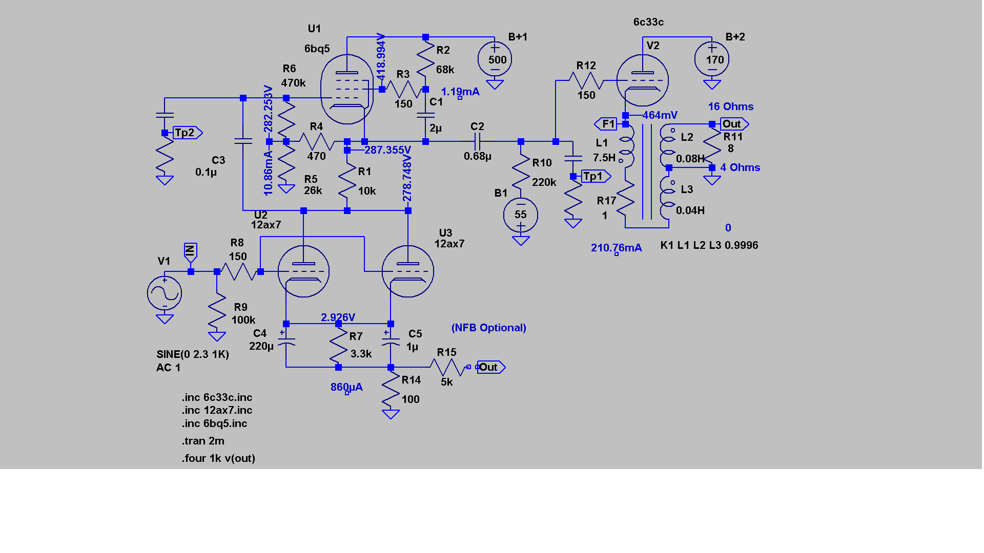

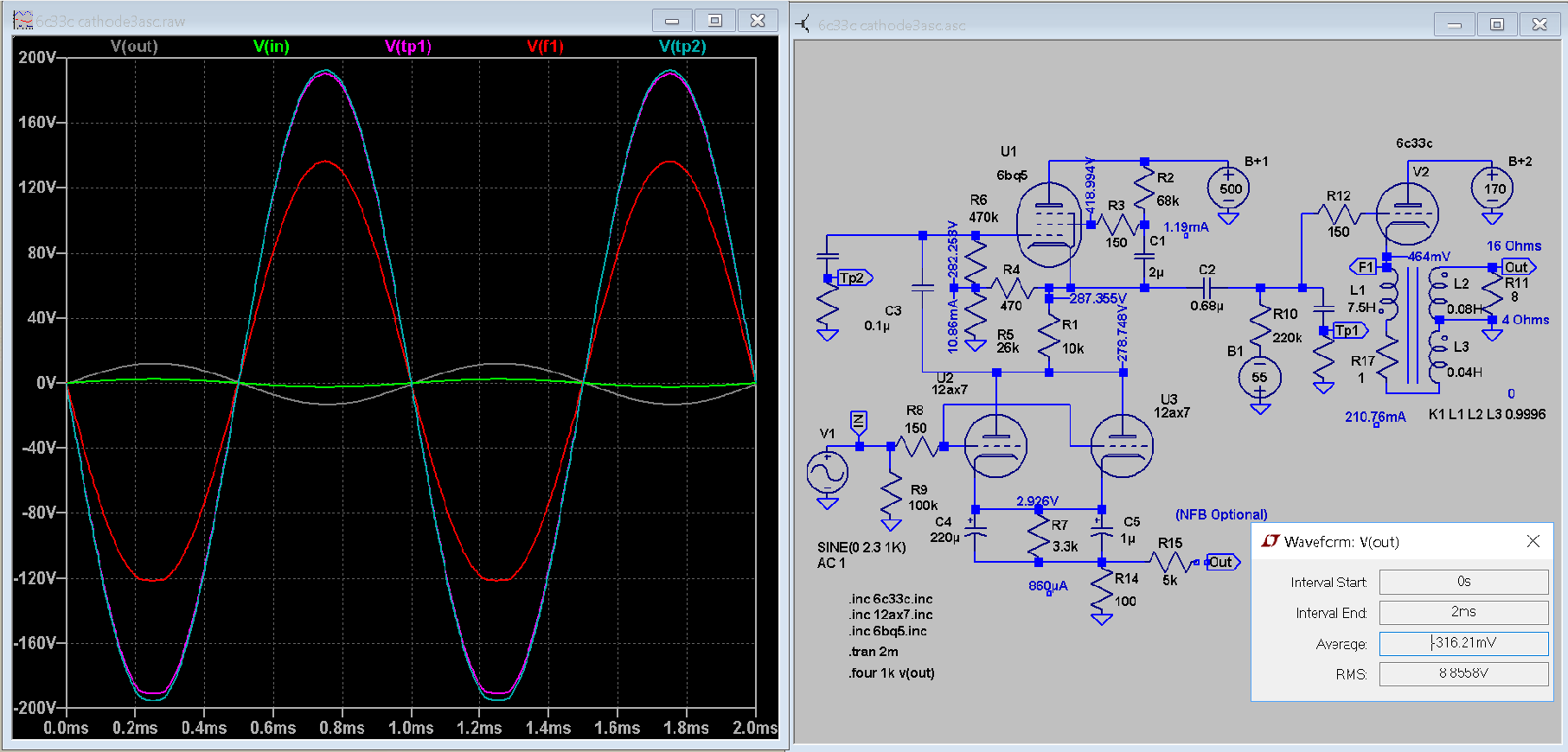

I recently reworked on 6c33c cathode output amp which I built years ago. I ordered a M5 iron which has Pri 200 Ohms and Sec 4/8/16,but the high frequency (above 5k) rolled off quite bit, and I have rewired the primary wiinding to a secondary winding to increase the negative feedback so the frequency is significanlty improved. I use a vintage Pioneer CL-70 90dbs speaker, the sound is really very good.
The driver was originally SV83 and 6n1p by Svetlana. I use 6p14p (el84/6bq5) and 12ax7 with slight changes in components values as shown. It's 250V or half the HT for bottom and top tubes. The driver distortion is 1% and power output is <2% without NFB.
The libs are zips file found on this forum, found it is quite accurate as compared to actual circuit measurement, I post here for reference.

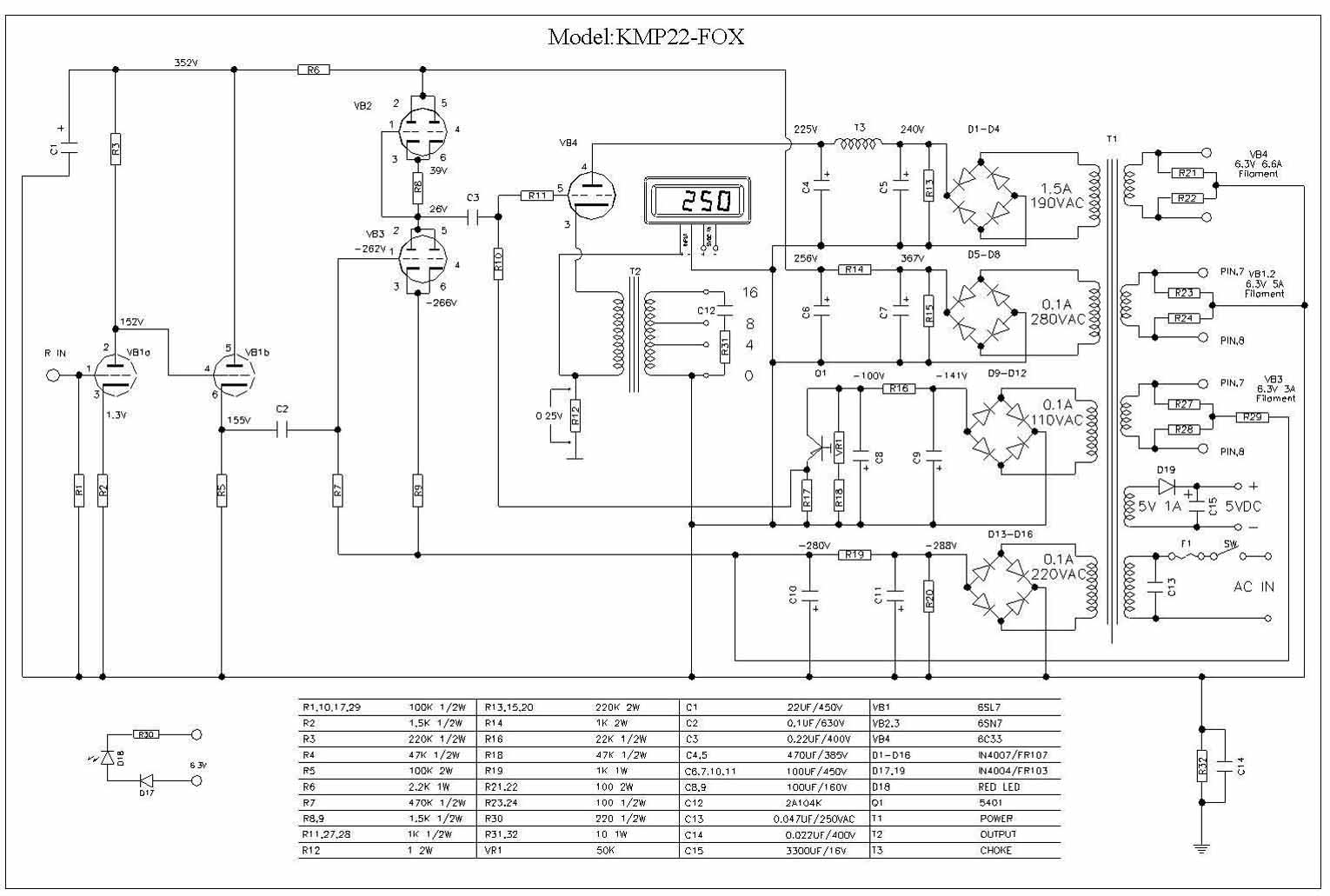

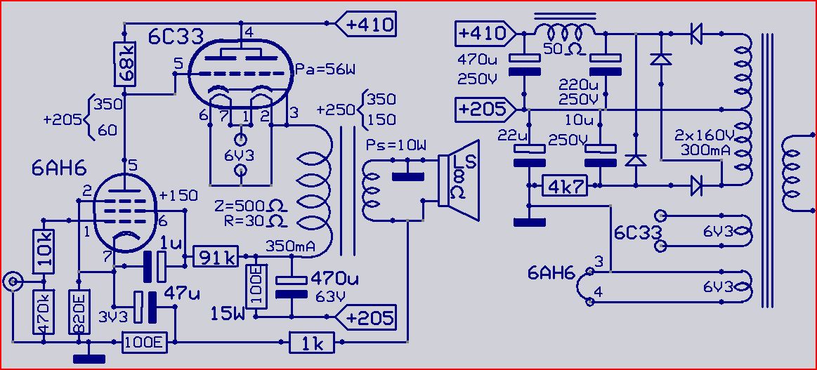

Antique Sound Lab KI22-FOX Stereo, The Antique Sound Lab KI22-FOX Stereo Integrated Amplifier by Dick Olsher
That is the amp what I am trying to build initially (if anyone still has copy of schematic please post it here for sharing), the problem is difficulty the output transformer needs to be custom ordered (again).
I could have seen it at the time when I built it, but I am not a bit fan of DC the amp, I don't use DC in OTL amp like Tim Mellow amp, I believe the cap coupled should sound just as good. Once you're DC you can't easy changed, but need to concentrate on sonic improvement in the overall schematic, the cap coupled allow you to make change without realigned the opertion point and bias.
The Pdissp is 56W for Mona sch, try to reduce it if you're going to build it. It's not a zero feedback amp, with pentode driver the distortion is higher than Mu stage. Try to SIM it to better understand the circuit.

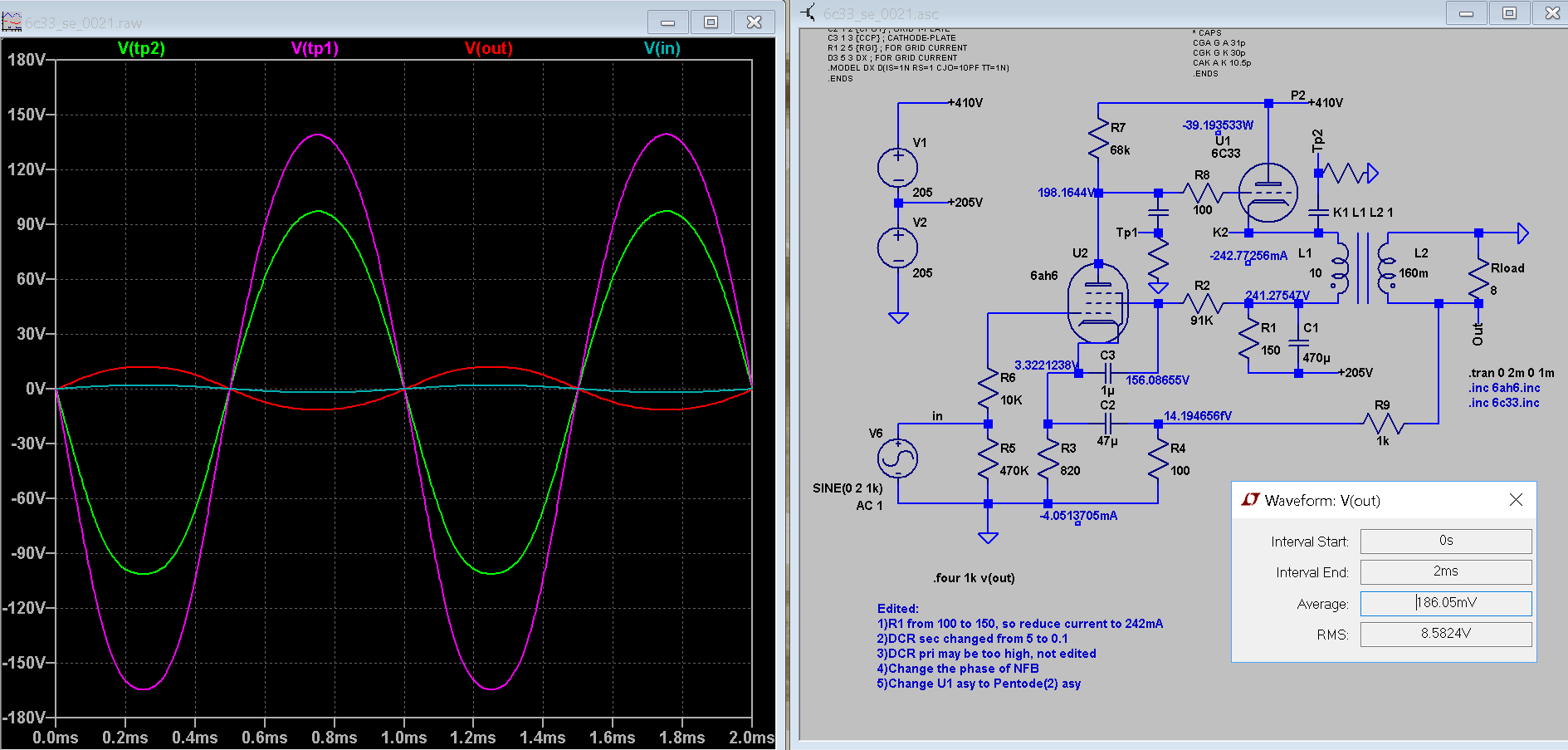

Joined 2005

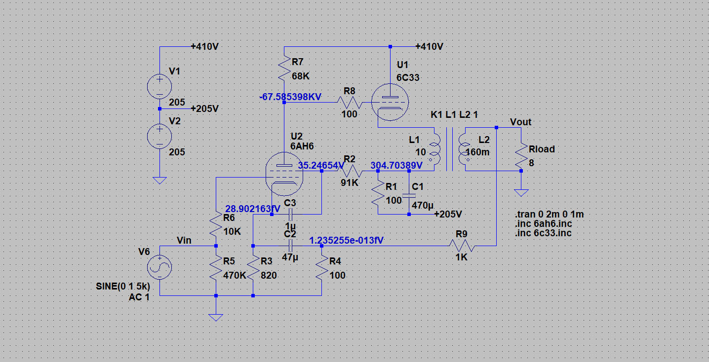

@Koon,
Modeled the design I posted earlier, but something doesn't add up, I've been staring at it for the past 30mins and checked all the models (pin assignment etc.) but can't get it to work? The fact that I have some nodes with fV showing must have something to do with it :D
Perhaps you have some pointers?

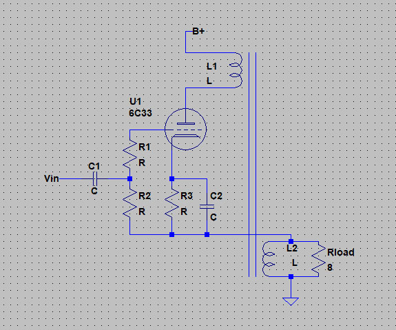

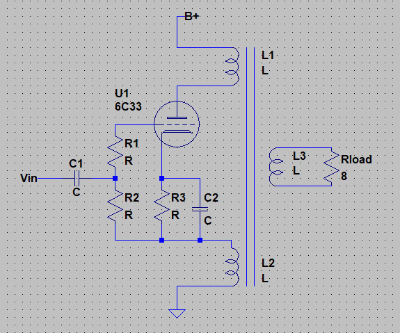

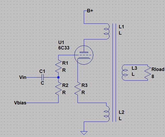

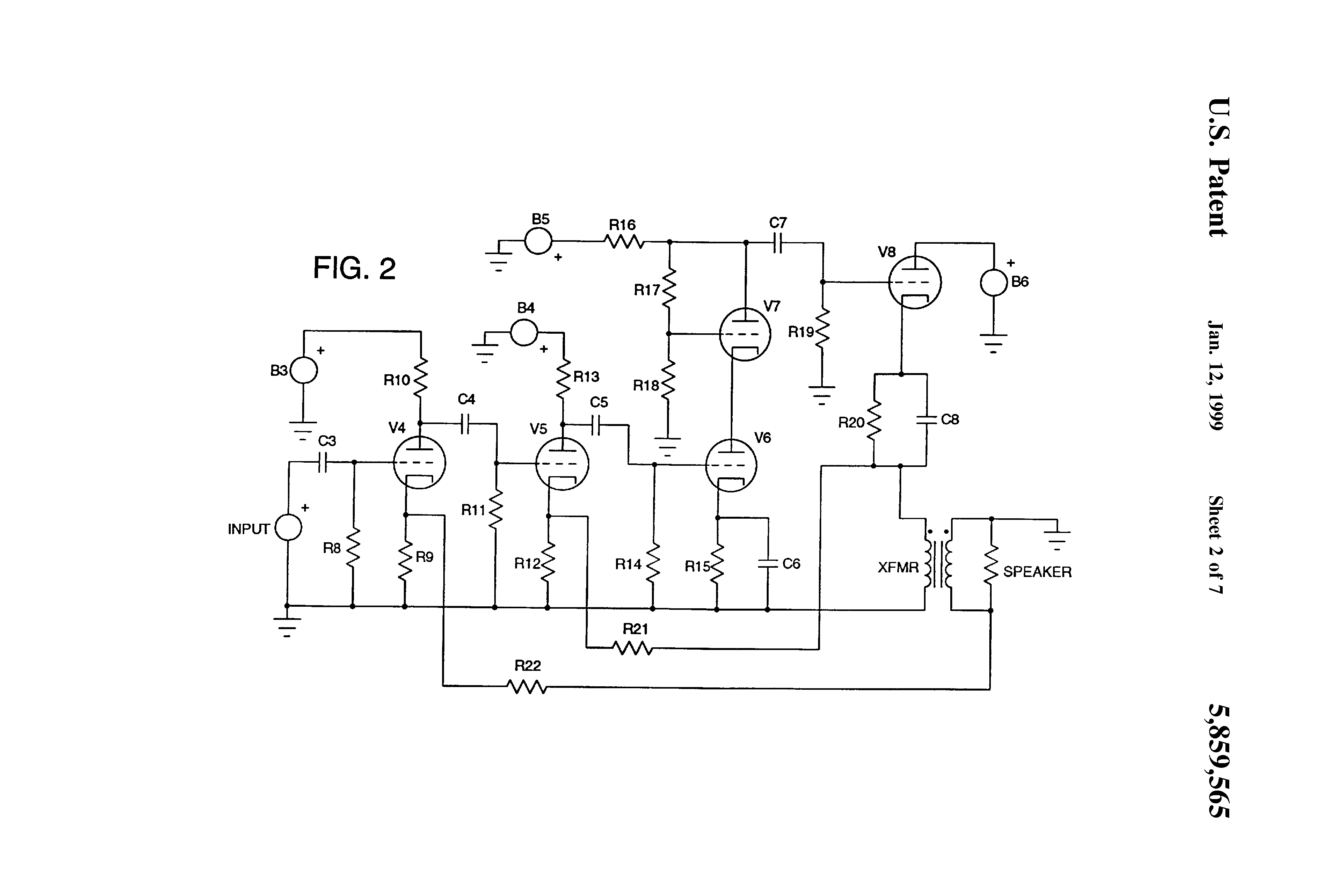

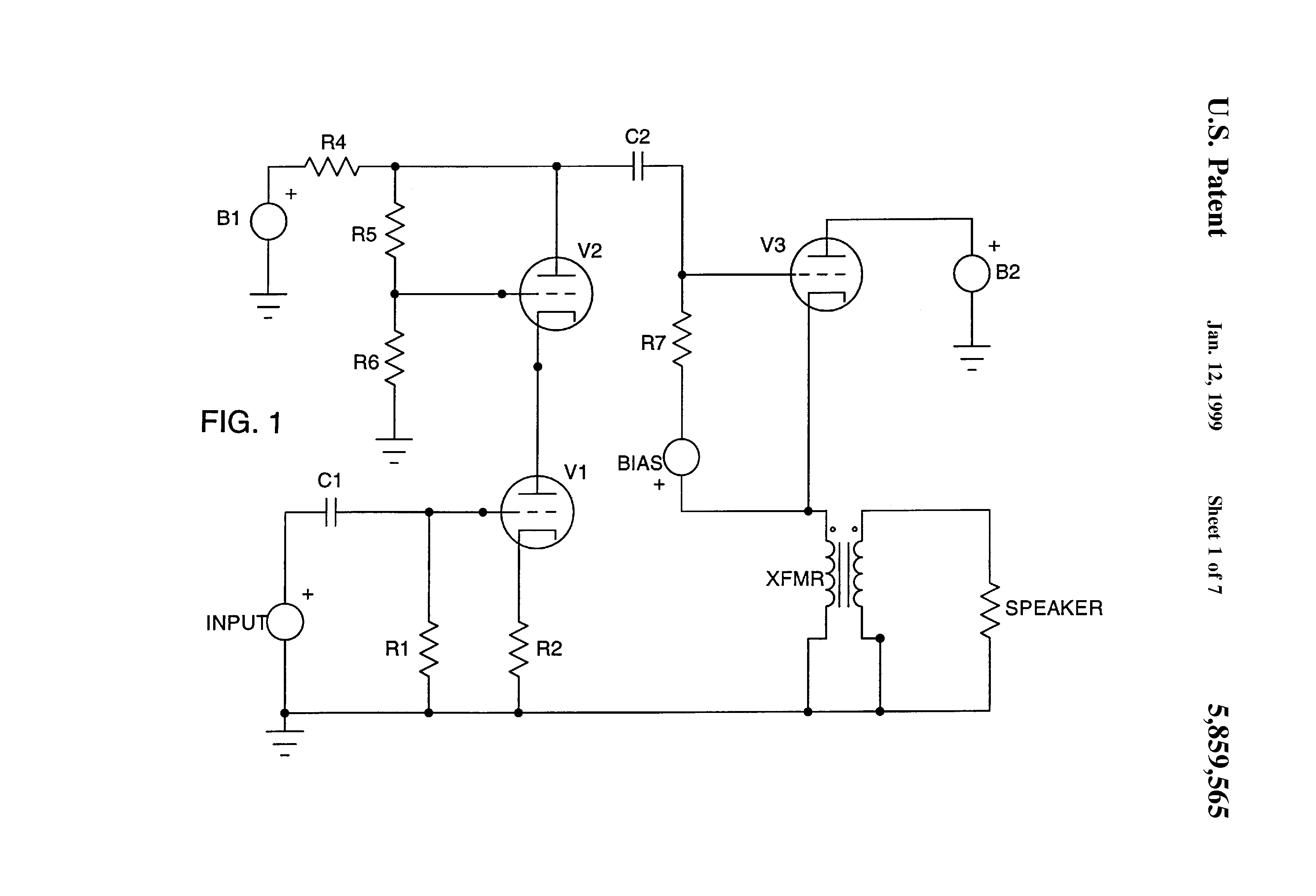

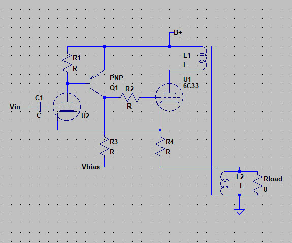

In the meantime I have made some drafts with ideas so might as well share those here as well, so perhaps we'll get some discussion going. What I was aiming for is maximum coupling between the 6C33 and the OPT and reducing the drive requirement for the input stage with 6c33_se_005.jpg.
Incorporating a 2nd primary winding into the design, auto-bias.
Incorporating a 2nd primary winding into the design, fixed-bias.
Incorporating the secondary winding into the design, auto-bias.
Incorporating the secondary winding into the design, fixed-bias and making it easier to drive with a circuit proposed by J. Broskie.

@Koon,
File 6AH6.inc
File 6C33.inc
1) Use Pentode2.asy with the correct pin is easiest, tetrode.asy doesn't seem to work. The model is working. You can also change the pin order in inc file to match the pentode.asy you have.
But
2) The phase for NFB is incorrect, try to change the phase of Pri or Sec.
3) Try to reduce the Pdissp of 6c33c

Disabled Account
Joined 2013
Here is what I edited for you but you can do better :)
The distortion now > 2%, mainly from the driver stage, you'll certainly need more NFB, apart from aligned the bias of the output stage by changing R1.

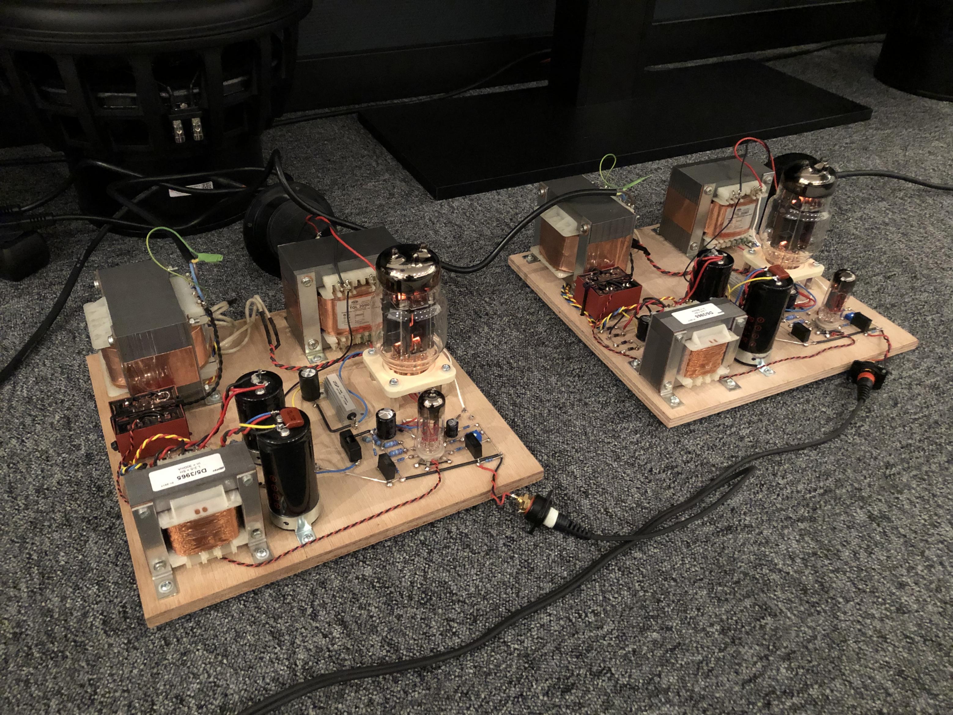

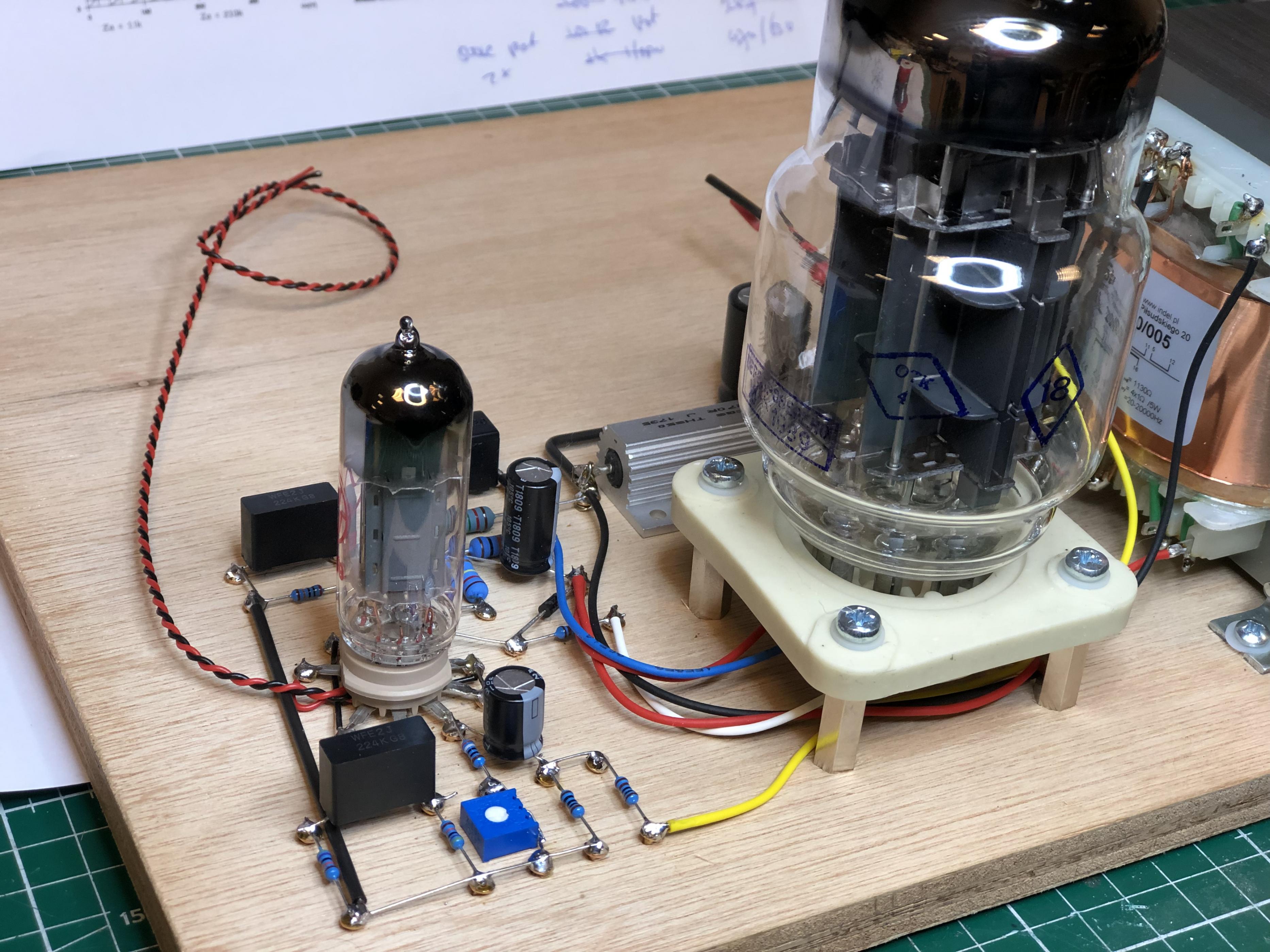

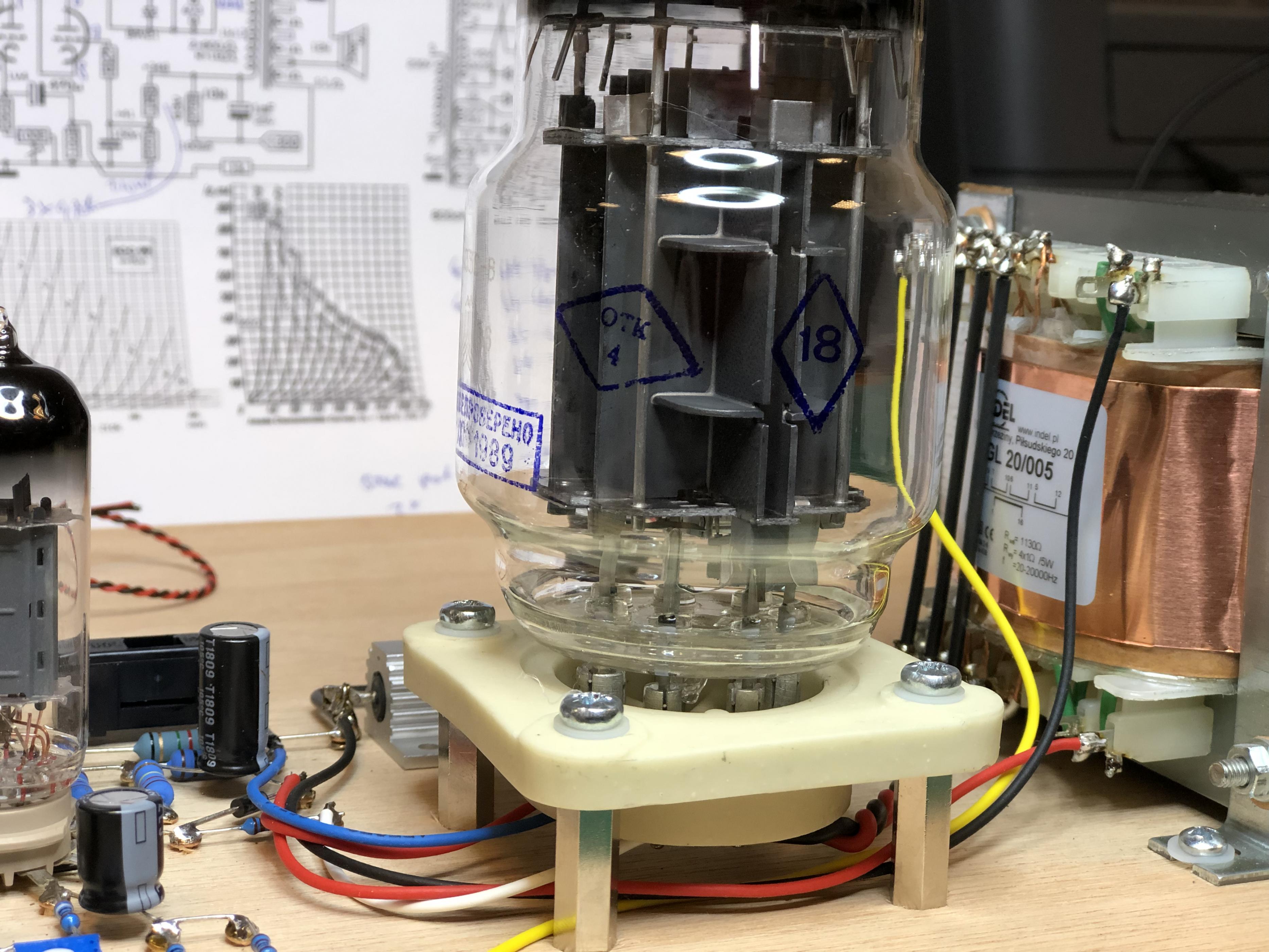

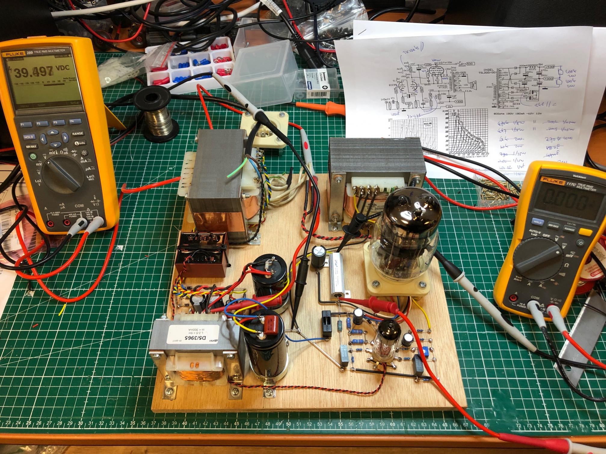

Joined 2005
In the meantime I’ve put a prototype together and plan to finsh the PSU for it tomorrow, as all that simulation is nice, but there’s but one proof of the pudding afterall, which means actually building it!
