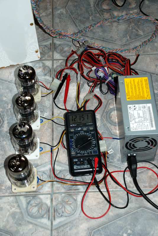

that topology is easily converted to SUSY
