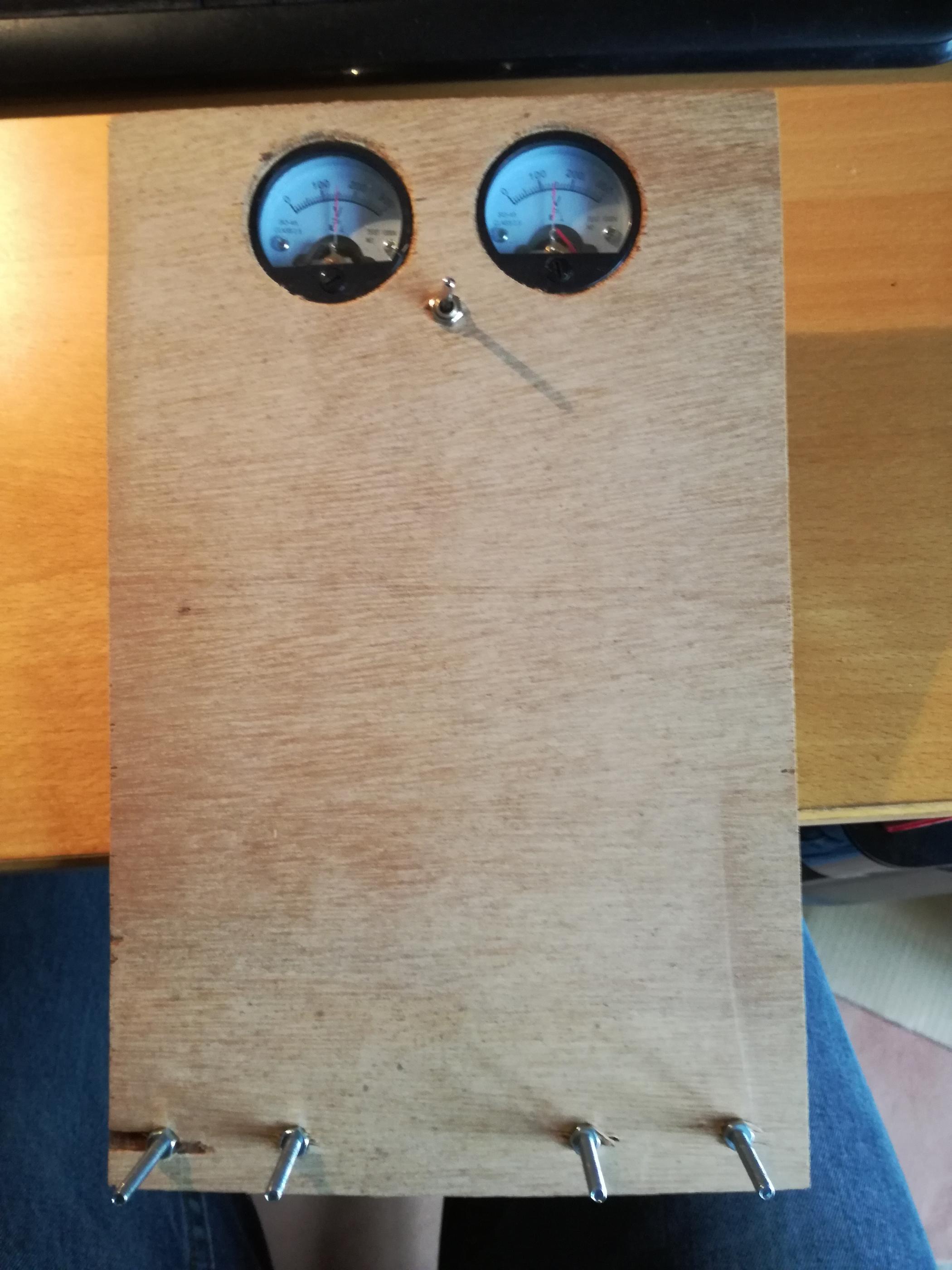

Some remarks about the decisions I made when making this amp:
As can be seen fro the photos, I decided to use 4 meters for the bias setting.
Ralph´s (Atmasphere´s) solution is more elegant, with only one meter pr. channel, but I wanted to be able to monitor the bias of the tubes more closely, as this was the first attempt on such a beast.
As I understand it, with only one meter, if bias in 1 tube changes (DC balance changes), you will have to set all tubes to zero and then adjust 1 set of tubes at a time to restore bias and DC balance.
In my much more complicated scheme, you can monitor each tube for correct bias. There is a switch between the two meters in each channel that switches (via relays) the meters between the two sets of tubes. The bias setting potmeters are beneath the meters and the two to the left are the ones that corresponds to the tube set that is monitored , when the switch is flipped to the left.
The switch at the top center of the front plate is the powerswitch and the switch below is operating relays that shorts the 1 Ohm cathode resistors so the meters are inactive , when playing music. I have always disliked cathode/source/emitter resistors in follower output stages and try to avoid the if possible.😀.
When music is not playing, I can get an idea of how the tube biasing is behaving when deactivating the shorting switch.
If something looks wrong, I use my extra gadget (see the pic.) that goes into the speaker terminals (the four screws that eventually will be replaced by real banana plugs 😱). The switch on the gadget shorts the speaker terminals and now I can set the bias for each tube precisely.
The two meters are for DC balance when the switch are flipped back to non shorting position. And this is used to fine tune DC balance, when cathode resistors are shorted. It is actually not necessary to make this fine tuning, but I wanted to have the opportunity.
Another choice I made was to use multiple small electrolytic capacitors for the power supply instead of a few big. I Like that solution and I had a ton of 3300 Uf /80 V laying around 😀.
The cathode resistors play an important role, as they reduce current hogging between power tubes. This is a dynamic issue, so individual bias settings will not solve it. I think you will find that several things happen when they are used: you get more power, lower distortion and greater tube reliability all in one go.
In your case you would also get the possible advantage of an easier metering situation, as the meter could simply monitor the voltage drop across the cathode resistor.
I think your solution of 4 meters is the better way to go but of course its a bit more expensive (if you use a good quality meter) and requires more chassis real estate.
Good work in any event!!
Ok thanks.
My meters are indeed measuring the voltage drop over the 1 ohm cathode resistors.
But anyway, I will try to let the relays just cut the meters from the cathode resistors , when playing music. You cannot have the meters hanging on the resistors when playing music, as they will make strange sounds and behave weird and I have only about 100 Ohms in series with the meters so a lot of power would be dissipated in the meters/resistor.
