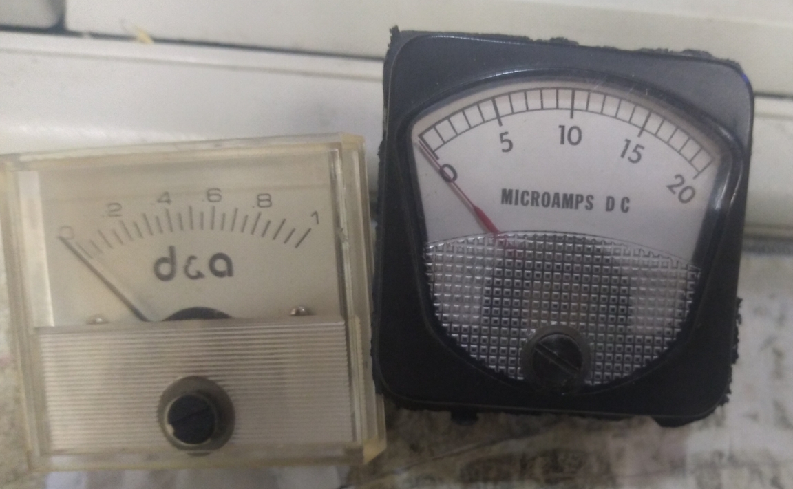

I was thinking moreso of a regular voltmeter that requires a series resistor. A lot of those require current in the uA range for full deflection. Some have a 0-100 scale and that would work for what I need.
All I'd then need is a DMM to measure the voltage across the 10 ohm resistor to get the mA reading and set the meter series resistor to indicate that value.
Yes, a µA meter would give some freedom to adjust the mV range via resistors.A lot of those require current in the uA range for full deflection. Some have a 0-100 scale and that would work for what I need.
Might be hard to find, though.
I've got two small meters that read full scale across the 1 ohm common cathode resistor. I can use a trimpot to adjust the meter to indicate the correct current value. I might use the 0-20 meter as it could then read to 200mA.
Not sure. Will have to measure it.
For the 0-20 scale meter I found a 6.8k series resistor gave me the proper meter indication when compared to a DMM measuring the voltage across the 1 ohm resistor. I tried 50mA and 70mA. Both read at the 5 and 7 mark with 60mA reading at the 6 mark.
For the 0-1 scale meter (1mA full scale) I found a 33 ohm resistor makes it read correctly. I will likely use the 0-20 scale meter due to how it looks and that it has four mounting bolts whereas the 0-1 scale meter only has two diagonally across from each other which won't work for mounting it with a bracket.
I'll move the 1 ohm resistor to the meter.

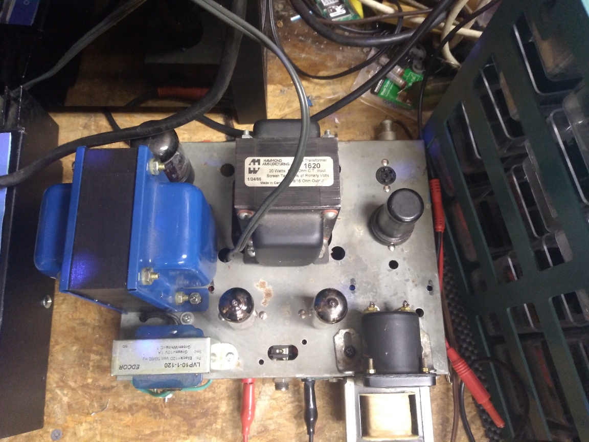

So here's where I mounted the meter. A terminal strip under the chassis located near the choke is where the resistors and wiring connect.

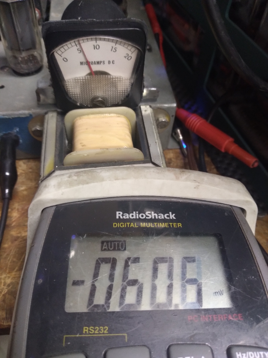

Here's the meter reading. Close enough for me. I might stick a label on the meter face right above the zero adjust and below the clear part of the window that says mA X10.
But if you use only one shared meter, one tube might theoretically draw 10mA and the other one 50mA.
You're right one tube could indeed draw a lot more current, but given they are close to each other far as my tube tester says, I suspect they should age the same and barring any failure of components one tube shouldn't draw a higher current than the other. Also if that were the case I'd likely notice distortion in the audio.
There's no guarantee that tubes age at the same rate.
I don't see a sense in using just one common meter.
Why not just mount test sockets connected to individual cathode sense resistors allowing to connect a DMM?
I don't really want an external meter.
What I might do is use a DPDT switch and a SPST switch and use a 1 ohm resistor in series with each cathode with the ends of the 1 ohm resistors connected to the current 1 ohm resistor. The DPDT switch will select either reading the cathode current of one tube or both tubes. the SPST switch will select what tube is having its cathode current read.
