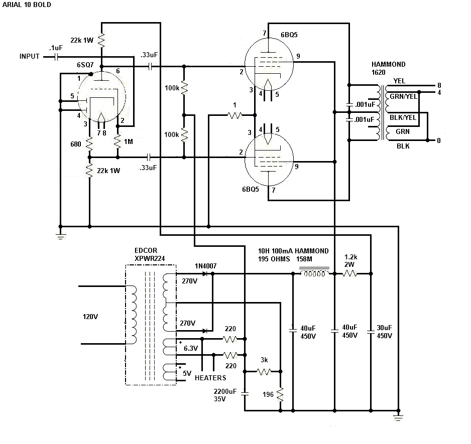

I've got a push pull 6BQ5 amp that is cathode biased.
The measurements are as follows with a 130.1 ohm cathode resistor.
Plate voltage 340.3Vdc
Screen voltage 341.7Vdc
Cathode voltage 10.27Vdc
Cathode current 78.94mA
I'm thinking of converting it to fixed bias as that eliminates the need for the cathode bypass cap and gives slightly more power output.
All I should need to do is set the grid bias voltage to where the cathode current is around 78.94mA, right?
I have a 500 ohm pot listed on the schematic as that's what I had on hand. I suspect that I will need a second filter stage for the bias voltage.
I'm also thinking of adding a 100mA meter to measure the cathode current so that I do not need an external meter to measure it. I may also install a SPST switch across the meter so that I can bypass the meter if needed.
I am, however going to have to get creative on installing the meter as it will not fit on the chassis due to the chassis being rather compact.
I currently have a 15Vac supply for the - bias power supply. Is it possible to use the 5 volt ands 6.3 volt windings in series for 11.3Vac and get enough bias voltage to bias the tubes at 70mA? If so that would eliminate one transformer.
What I will do is use a variable voltage power supply to set the bias voltage and see what voltage is needed for 70mA cathode current.
Also will the B+ voltages be too high for the 6BQ5 and 6SQ7 or are they ok?

If you go fixed bias for almost inaudibly more power, you should have separate bias pots for the output tubes and lower grid leak resistors.
The ds says 300k max for stable fixed operation. So 220k instead of 470k.
The pots don't have to be 500ohm, more like 10k.
But what is wrong with bypass caps in a non hifi amp ?
If you want to improve, use separate cathode resistors and bypass caps.
So 270ohm and 47uF...100uF for each tube.
No nred for a meter and bias checking every other day either, the separate cathode resistors will do the job automatically and safer.
If you think the meter - which is hard to fit anyway - is required for the show, then use a 15V range and on-off-on switch to display bias voltage across cathode resistors from either tube or none.

Separate pots would be beneficial as I wouldn't need a matched pair of tubes.
The 500 ohm pot was what I had on hand. May see if I can find a higher value in my stash.
Definitely need lower grid leak resistors for sure.

Plate and screen voltage (measured to cathode) limit for 6BQ5 is 300V.
Fixed bias will increase actual voltages by another 10V.
Cathode bias is much safer regarding thermal runaway.
The advantage is that you don’t to deal with the effective higher B+.I've never thought of using a voltage regilator in the cathode circuit.
The 6BQ5 is running hot in the original schematic, 330V*39.5mA=13W.
Better to keep cathode bias and separate cathode resistors and caps, 2x300ohms would be safer for the 6BQ5.
The first stage has no gain, you need like 10V input signal to reach full power, right?
The gain is a 12SQ7 on the communications receiver chassis.

So after doing some experimenting this is what I've come up with.
The input jack is wired to short the input when nothing is plugged in.
The measurements are as follows.
6BQ5 Plate 318.8Vdc
6BQ5 Screen 321Vdc
6BQ5 cathode current 56.4mA
Bias voltage -11.29Vdc
Unfortunately I cannot drop the B+ voltage more with the parts I have on hand.
Given the bias is not adjustable by a pot, I will not need the meter. What I may do is install a couple banana jacks on the amp connected across the 1 ohm resistor so that I can use a DMM to measure the cathode current.
Since it's relatively easy to do I might try the ultra linear connection real quick just to see if that's any better.
I have a tuner connected to my McIntosh C-24 preamp and it drives the amp quite nicely. Even though the amp isn't intended for HI-FI use, it sounds pretty good.
According to the tube data I should be using an 8k primary impedance output transformer for the operating point I am close to.
This one will give me 4 8 and 16 ohm output impedances.

If the quoted cathode current is for one tube, then you are well above the dissipation limit for the 6BQ5, 18W vs 14W (Pa+Pg2).6BQ5 Plate 318.8Vdc
6BQ5 Screen 321Vdc
Yup, I looked at the curves after posting and realised it had to be for two tubes. Should have checked first before posting.

Could we go back to your motivation for this tinkering? As well as the schematic in post #13? And lowering the B+? I think I have missed the point of all this effort.
Why exactly do you want to eliminate the cathode capacitor? In your schematic in #13 you have not gone to fixed bias but removed the bypass capacitor, if I understand the schematic correctly. The bypass capacitor serves a good purpose in a cathode biased PP pair. What value of cathode resistor do you now use? If you are concerned about uneven dissipation in unmatched tubes, have you considered going to individual cathode resistors (including a trimmer pot to vary the bias) and each with a bypass cap.
And why lower the B+? Is it to reduce dissipation in the power tubes? I think your B+ was fine, as long as you use the correct cathode resistors for proper bias.
What I did was create a negative bias supply in a way using the 196 ohm resistor given it goes between the center tap of the HV winding and ground.
The cathode resistor of the 6BQ5 is a 1 ohm resistor so I can measure the cathode current.
I can ditch the 3k resistor, however that raises the 6BQ5 plate voltage to about 350Vdc.
What I could do is install a 5Y3 or other similar 2 amp filament rectifier and eliminate the 3K resistor.
I'll likely then have about 300Vdc.
Not sure why I didn't think of that last night.
