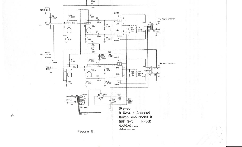

I'd need an actual full circuit diagram or layout, not just words or descriptions of the design etc... thanks !
or would a 6v6 with 12ax7 essentially sound the same/similar?
I have transformers and tubes for the 6bm8 but if the 6v6 is same sound signature -i could find an existing old amp instead.....
The ECL82 valve is a nice general purpose valve and I have built the Mullard 7 a couple of times for friends, they work great.
that is exactly what I was looking for...none of the searches I did brought up anything . thanks so much.
I would prefer the 12ax7/6v6 version of the Baby Huey
A lot would depend on the output transformers of the OP
