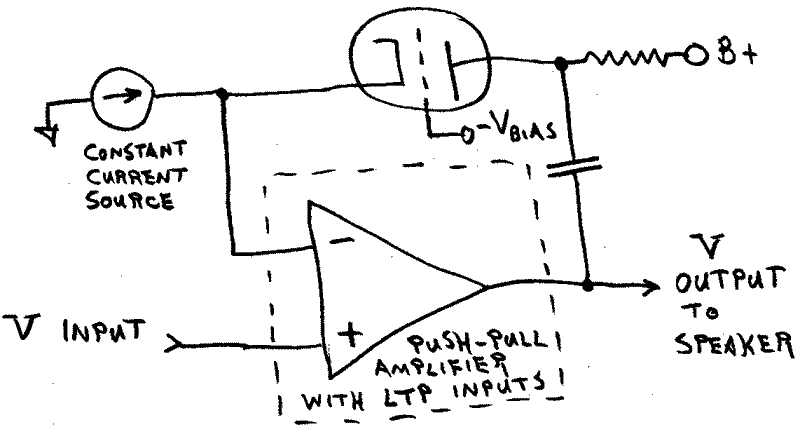

It appears that the triode (a diode effectively) in the "STC" shunt feedback will just make the output device's distortion higher. The current in the pentode output and the nonlinear feedback element would need to track for cancellation, but they are in opposition in the "STC", giving an S shaped response.
Perhaps what they meant to do is this, where the triode is used in inverted Mu form for feedback:
http://www.diyaudio.com/forums/tubes-valves/20686-se-sound-p-p-amplifier.html
This could be just a conventional LTP circuit driving a pentode output, with the neg. shunt plate feedback sent back to the plate load of the input side of the LTP driver.
(or put more simply, the top of the plate load resistor for the input side of the LTP driver connects to the plate of the output pentode, output pentode's grid is driven by the other LTP plate, cap coupled typically. CCS tail on the LTP would help linearity further)
