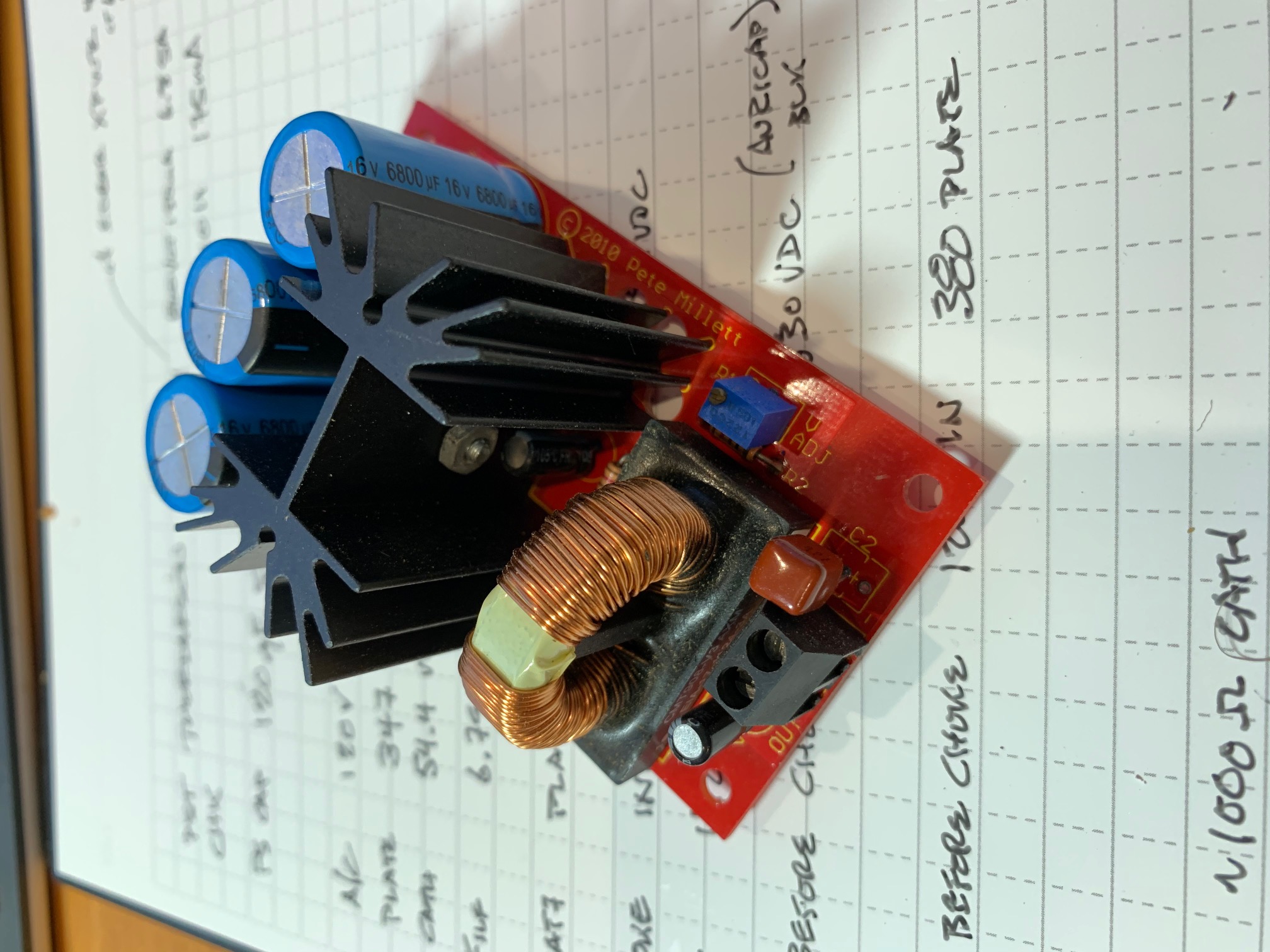

Regulated DC Filament Power Supply
A quick note, for what it's worth: I used Pete Millett's DC power supply board on my Mono Vinyl Flexi-SET Amp, which takes everything from a 46 tetrode to a 300B (yup, two sockets).
I used it for easy switching between different filament voltages, but of course the DC eliminates the dreaded DHT hum, too, which has been an ISSUE for me for 20 years.

Usually available on eBay. IIRC, there was a Mouser parts list available.
I have filament voltage test ports on the top and a nice (ALPS?) pot to adjust the filament voltage. Works a treat, as my British cousins would say.
Don't recall the amperage, but I remember being surprised how high it was.
HOWEVER, it does like input voltage greater than output voltage (nothing's free), so for 6.3VDC out you might have to tie together a 5V and a 6V. For the old triodes/tetrodes, I could use a 6.3V tap.
Here's a photo...
