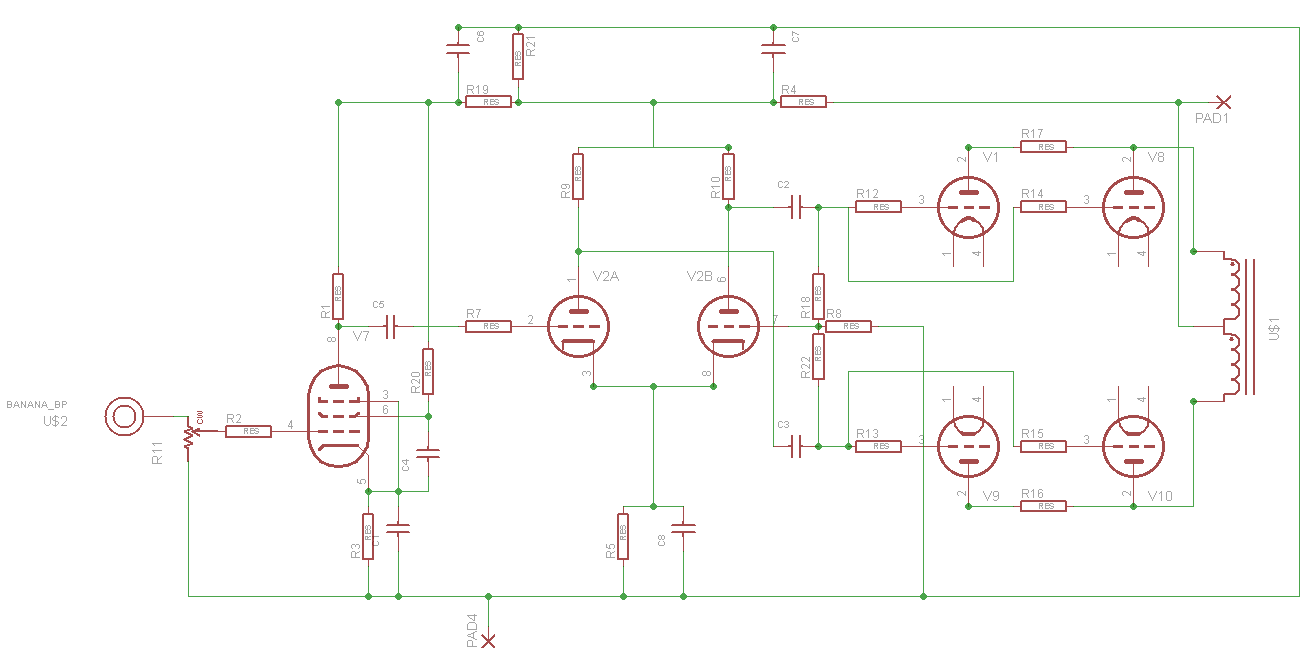

Here is something
I pulled this from a book I found on Pete Millett's book library. It was made for a 6B4Gs and it asked for a 2.5k or 3k opt. It would likely need minor tweaking, I also did this copy in about 15 min. so there may be errors. The other tubes were a 6SJ7 ans 6SN7. This one is for next summer 🙂

With 3K OPT you will probably get "That vintage sound" 😉

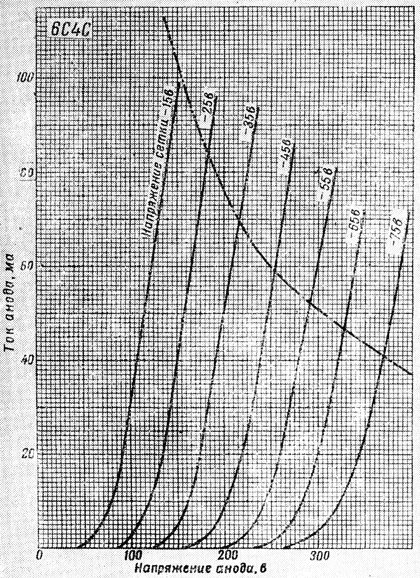

By the way, what are max grid current specs for either 2A3, or for 6С4С? It seems to me I have not seen them...

I don't know the actual grid current specs for the 2A3 but they don't seem to be too much different from the those of the 45. For the above mentioned 14W amp I used a +/-170V and 15K load for the 6SN7 CF resulting in approx. 8.5 mA current. It was perfectly sufficient for the job.
It's a parallel PP. So 5-6K load per pair. However I repeat that it is more important to match the amp with right speakers regardless of the primary load because the Zout will not be so much lower.

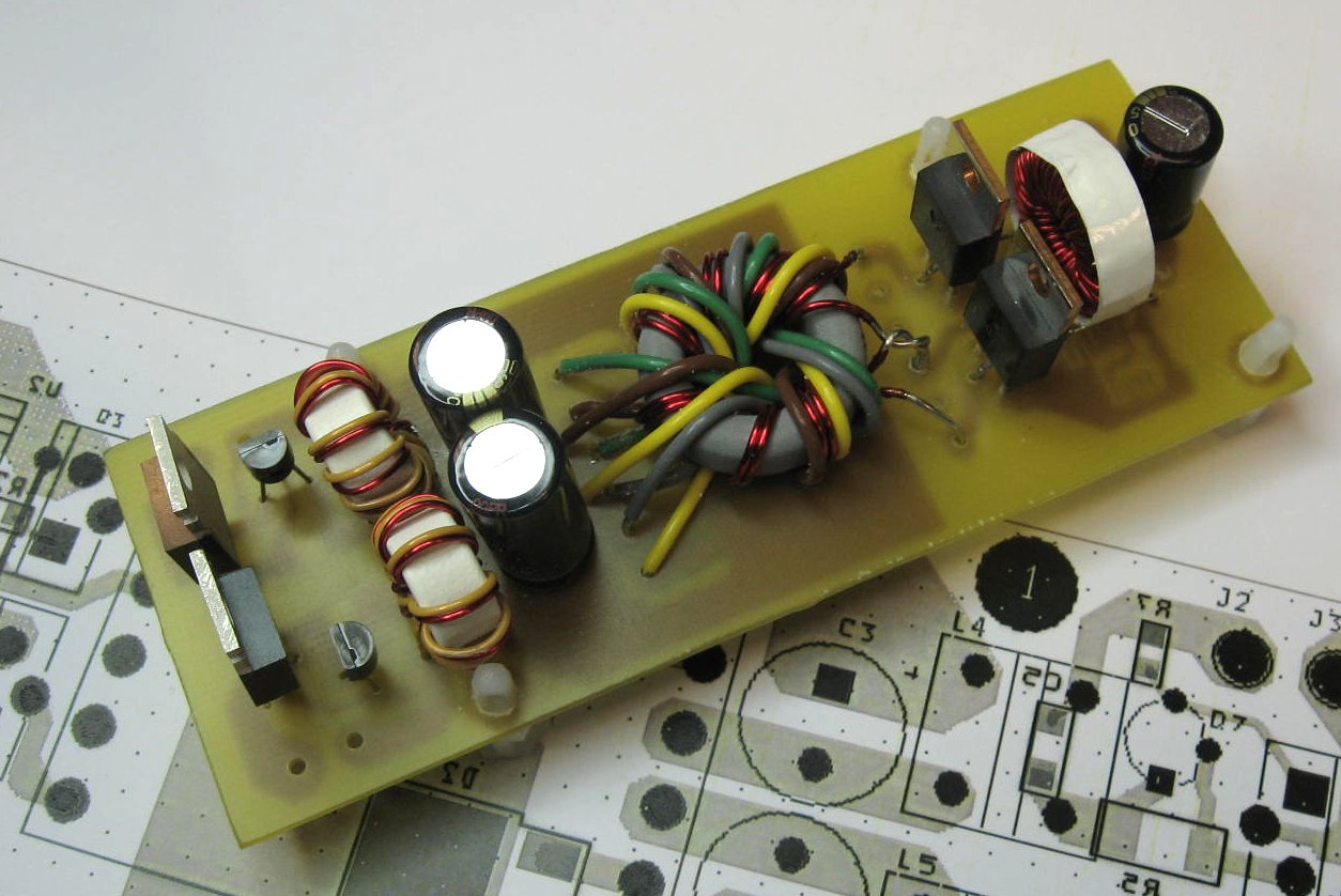

Here's the first stab at an isolated switching heater supply for DHTs. This is a little guy tailored for the requirements of the 6B4G/6S4S. One board does for two tubes, so I'll need a pair for a stereo amp. It's designed to run off a central regulated supply (+15V for now), and consists of a simple choke-fed push-pull chopper with two Schottky rectified outputs. Each output has a simple ring-of-two current regulator set for the 1A filament requirement. Seeing as people usually run these tubes with a transformer that puts out whatever the AC line happens to be delivering at the time, by comparison this circuit will be treating the filaments with kid gloves. It'll allow me to eventually run the amp from a single central SMPS without a lot of extra complications. Oh, yeah, there will be some heat sinks added down the line, at least for the Darlingtons in the current regulators. The mosfets at the front end probably won't need anything to speak of.
