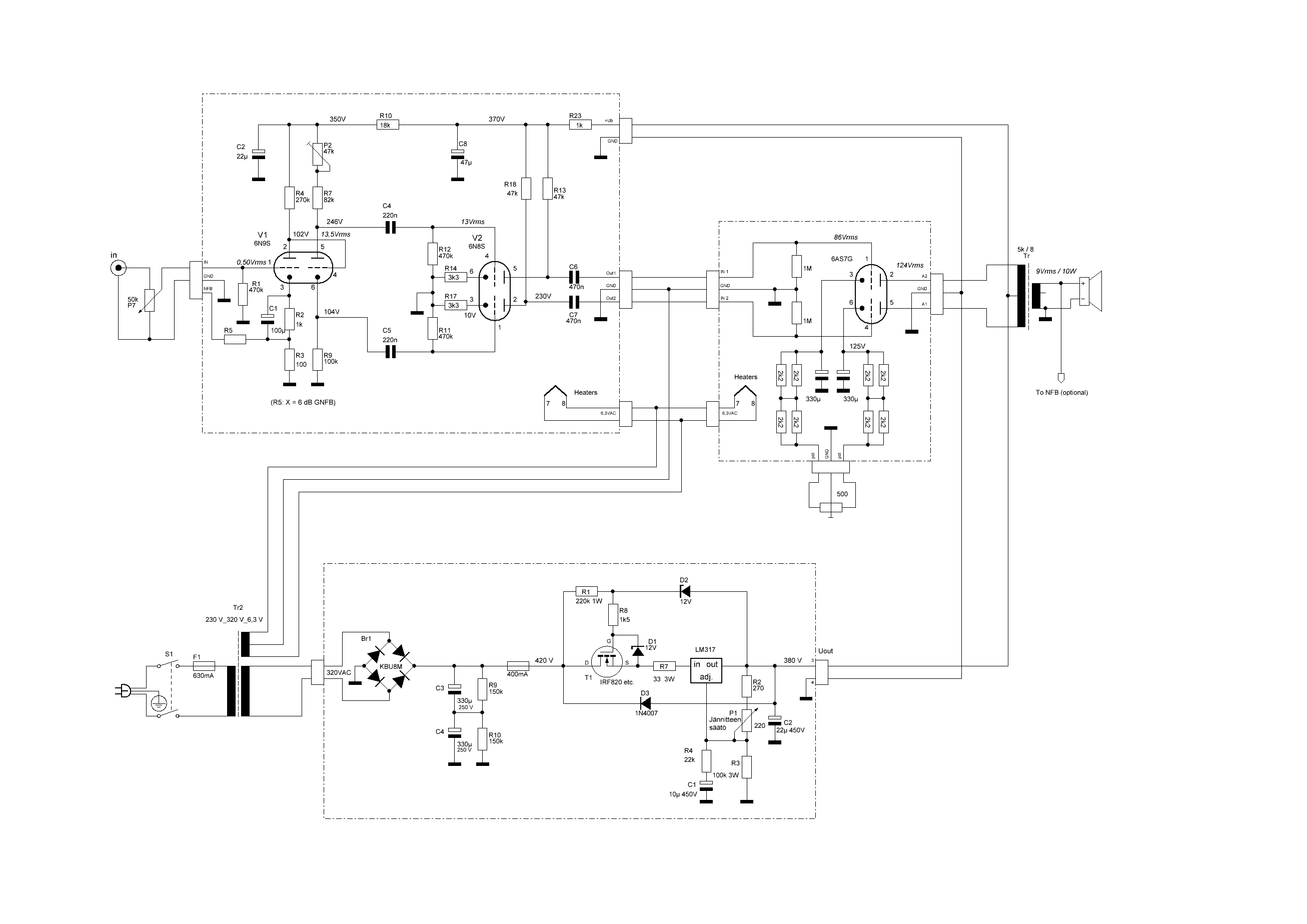

This is my version. About a dozen of these have been built by Finnish hobbyists.
This produce some 10...12 W. If you want a fair priced class A triode PP-amplifier, this is one candidate.

Dealing with the massive drive requirements of a 6080 amp makes for a more complex build in the end. The MU of 2 will really equate to a gain of 1 or less in a real world circuit.
True. The driver stage needs to be carefully designed. The MU in actual circuit is (in my case) 1.44 as can be seen from the schematic.
EL86 as a PP/UL is very good choice, better that typical EL84. With 300 V suppy voltage, more than 20 W is available.
With EL84 and +Ub = 300 V, some 12 W is max.

As you can see from my schematic, there is 370 V supply voltage available for the driver and required drive signal for the output tubes is 245 Vpp, so no problem at all.
The driver stage has also a huge effect to the overall THD. Now it is biased to perform most of the distortion cancelling. The output stage alone has some 3.5...4 % THD at 10 W. With properly biased 6SN7 driver the overall THD is below 1 %.
With an interstage transformer as a driver you won't get such improvement to THD.
Attached the test results of my amplifier.
