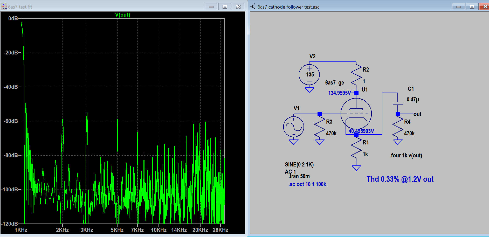

Cc is too big, 0.22uf is enough.

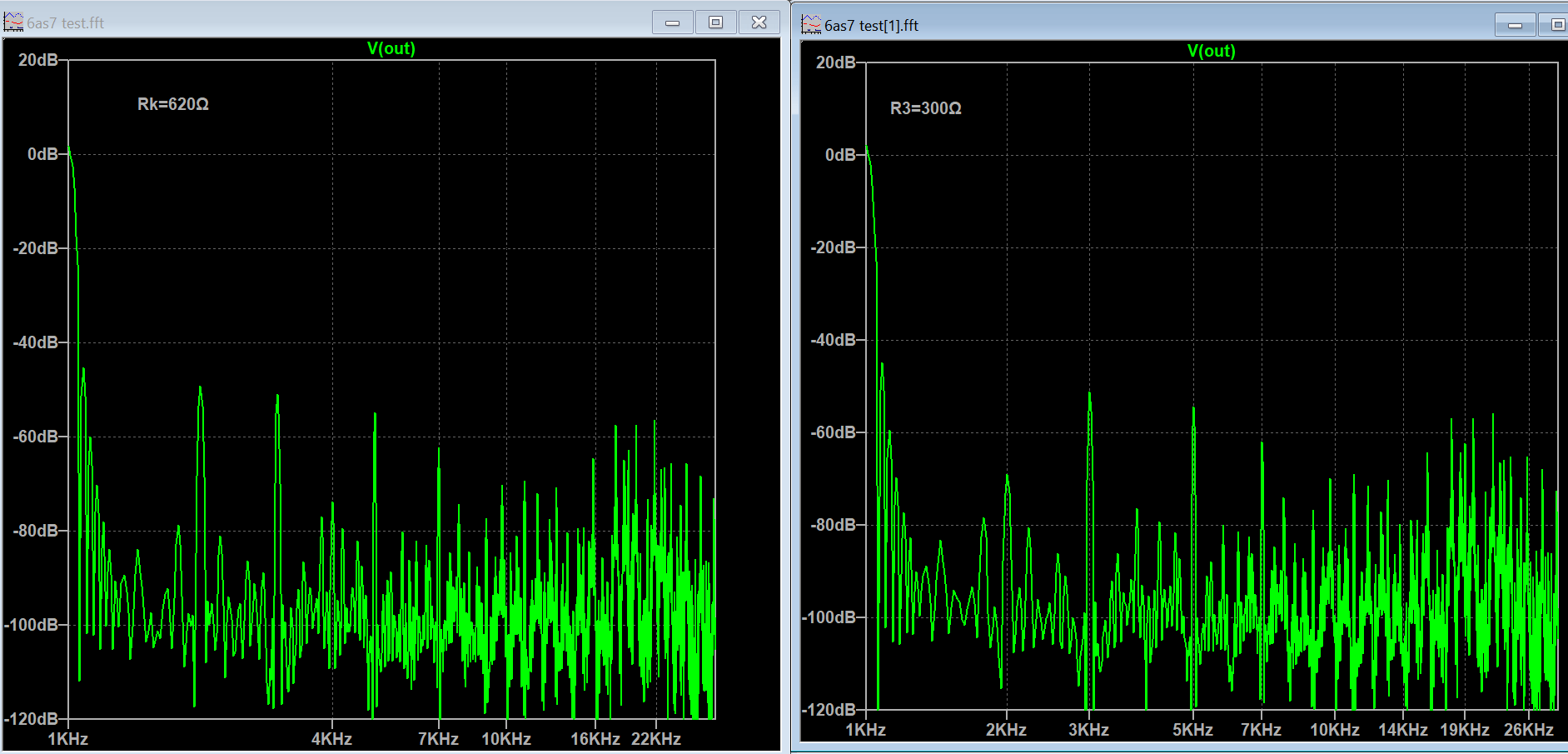

I do a simulation of a simple cathode follower and found that FFT is very similar to your sketch. If the current is increased by reducing cathode resistor to half, you got fft with 2nd harmonics reduced. Not sure how sonic wise is like, it may paid to input and record a wave file instead of sig. for more listening experience.
