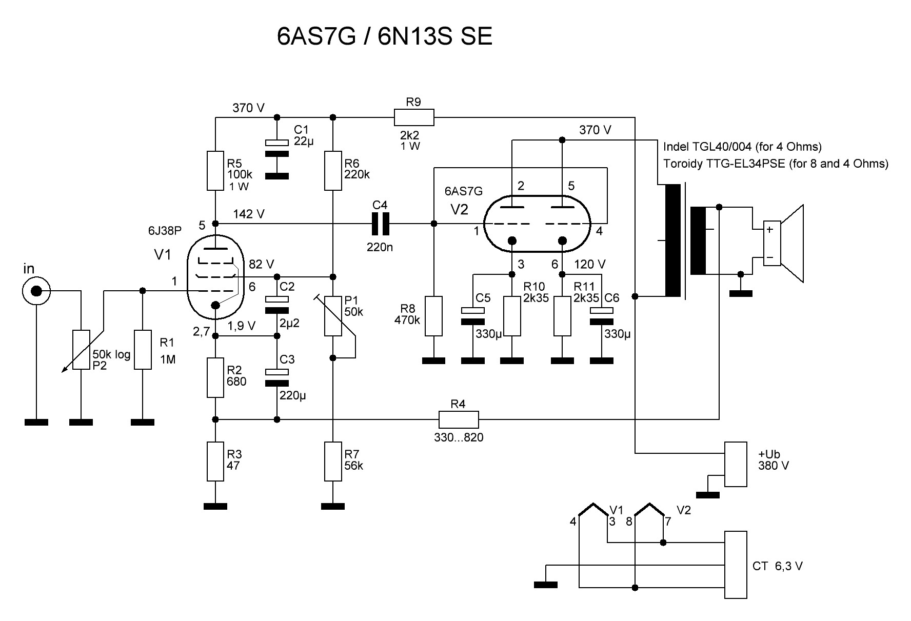

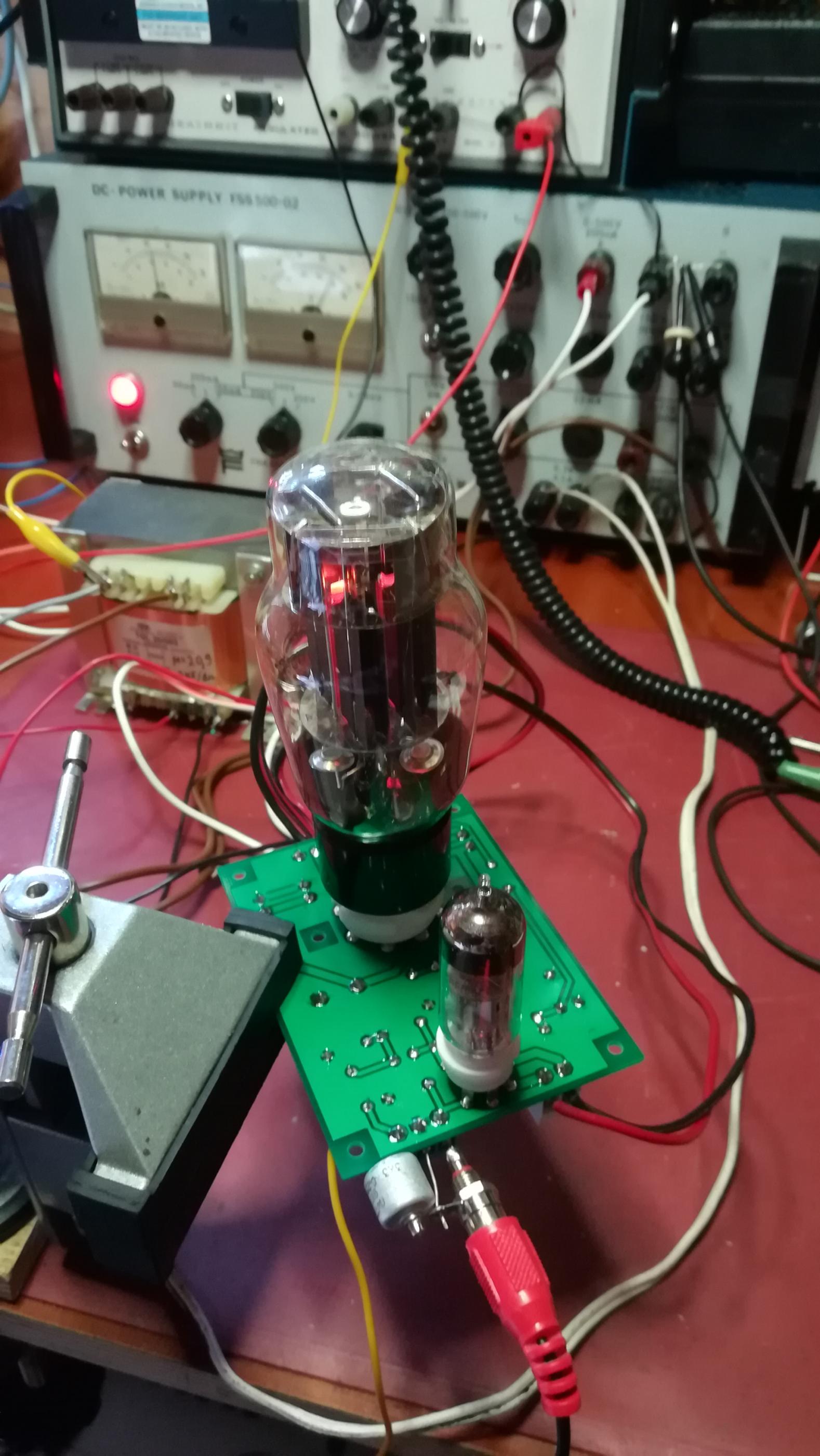

I just completed a 6AS7 (6N13S) SE amplifier which has been waiting to be built a couple of years. This will give 9 W at clipping point and 8 W at relatively low THD.
Attached some documents and test results.
