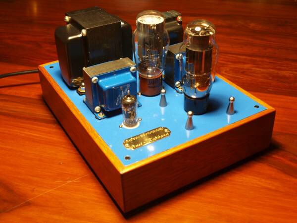

Here's my first go at a low powered SET amp.
6AS7 power stage, 12AX7 driver stage, 5V4G rectifier, 15W Edcor GXSE (1.7K) output transformers, Hammond (270FX) power transformer, Auricap signal capacitors, 24-step attenuator on the front end, Hammond chassis.. I would say this was somewhat of a budget build, but I'm very very happy with the sound. About 3W output power per channel.
The wiring isn't overly pretty (I've since tidied a few things up), but the amp is dead quiet at full volume, even with my ear directly next to the drivers I'm using (Fostex 206e).

Thanks. Haven't we had this conversation before though? 😛
I am using the 6AS7 with 170V from plate to cathode.. 245V on plate, 75V on cathode = 170V plate to cathode.
As for that 1Kohm resistor you're seeing, it's not in the main power supply string, it is used for the leg that feeds B+ to the driver. It has nothing to do with the B+ that the 6AS7 sees.
If you'll notice, there is indeed a 250 ohm resistor between the chokes (after the leg that feeds the driver) which does drop my B+ for the 6AS7 by about 37.5V (150mA * 250ohm). I suppose I could have used a 500VCT power transformer, but then I'd probably be a bit on the low side. That is why I used a 550VCT power transformer.. Between the voltage drops through the rectifier, chokes, and output transformer, I arrive at pretty much exactly the B+ I want for this amp.
As for the fact that my 6AS7 cathode voltage is 75V, requiring a large swing, the 12ax7 is absolutely fine for this task. I've asked you before why you think the 12ax7 isn't a good choice for a driver, and all you've really told me is that you feel as though it's harsh sounding and for use in guitar amps.. As I've mentioned before this sound that you're describing is likely because of how the 12ax7 has been configured in the circuit's you've used it in. Very often the 12ax7 gets set up with too small a load, or bias resistor, and then you get grid conduction. An incorrect bias and small load makes it sound "harsh".
With the bias point and load as it is in this circuit, it provides the swing required, and honestly sounds really really good IMO.

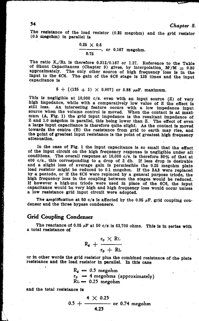

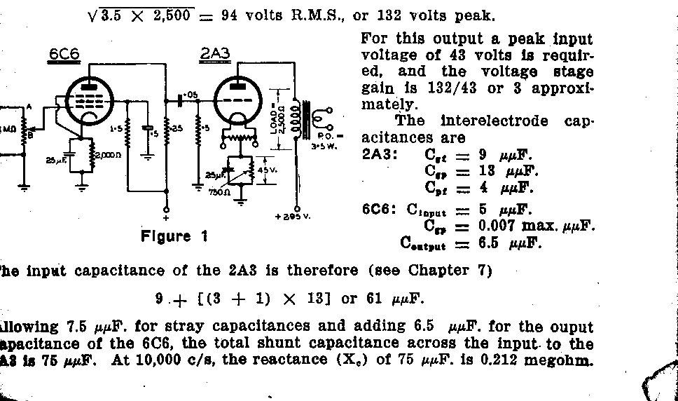

12Ax7
From what i have read the 6AS7 is best run cathode bias.
The 12Ax7 is not a good driver for hard to drive tubes like the 6AS7 or 2A3 as there is a loss of high frequencies.
I found this artical in the Radiotron Designers hand book.
May give some good ideas.
Phil

The only point I completely disagree on is the statement about the 6AS7G being a "Twin Triode".
It is a "Dual Triode" hence other statements from RCA that the triodes should not be paralleled. (There goes my OTL)
http://www.clarisonus.com/Archives/TubeTheory/6AS7G.pdf
I also agree with azazello in that the 12AX7 is not a good choice for driving these kind of triode as HF roll of (among other things) is almost inevitable.
This kind of tube needs a beefy driver. To make life simple a driver that can operate well from lowish B+ is an advantage as the 6AS7G does not like high B+ either. Around 250VDC seems a good place to start.
Since the 6AS7 has a low mu of only 2 the driver also needs a medium to high mu.
A ECC88 seems quite a good candidate but I'm sure there are many others.
Ciao, 😉
