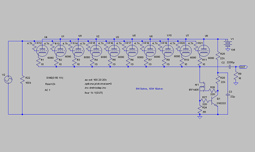

revintage said:To make this cicuit work you have to take out max currents through the 6080s which means their workingpoint should be Ia 125mA, Ua 100V.
You should also use a choke or a CCS from the cathodes to ground. A B+ of 130-170V will do.
Every triode has an theoretical (simplified 1/Gm)Rout of ca 140ohms, so adding a separate 10 ohm to each one will not make you loose so much. Without NFB Zout will be high anyway.
If going for a 8ohm load I would suggest using at least 5 but preferably 10 6080s/channel.
I suggested using a CCS some time ago.

Have anyone really tried a CCS as I know you suggested? Must be the most costeffective way to go as chokes cost a lot. Just using a resistor will make you lose to much power and worsen THD.
Think a CCS robbed from Pass would be fine......
To be honest, I could not see why a CCS would cause oscillation and instability as it is well used, as you say in Pass designs.
And as you say, cost is minimal !!!

If you can find transformer cores, bobbins and magnet wire there´s no need to pay 60 bucks each for cathode chokes. I made my own for my SE OTL with 4x PL504 (per channel):
600 turns 0,45mm wire on EI78 cores with ~0,5mm airgap.

As I know you are keen to try new solutions, have you tried CCSs?
My (theoretical) idea is that one could lower B+ to consist of 100V over the 6080s, the negative swing at decided load and the voltage drop over the CCS.
So a std 115V secondary transformer should be sufficient.
This is a theoretical model of what I mean. Simmed it works well. Stole the CCS from Pass Zen and turned it upside down and changed P to N😉 !
Almost like it is too simple as the grids are at ground level. 12,5W through each 6080. At 5% THD output is 12W/16ohm and 6W/8ohm. At 1% THD output is 2,5W/16ohm and 0,5W/8ohm
That's pretty much what I had in my previous postigs although I cannot remember where my CCS came from!
What current have you through the CCS ?
How about -ve bias for the tubes -?
Andy
Andy

As I said earlier 100V/125mA through the tubes. No need to bias the tubes otherwise than with the CCS. If you check UaIa-curves, Ug is in the ballpark of -30V. So there is enough room for negative swing even if we should loose 10V over the CCS.
Lars: Good idea but you´re not the first one to think about using an Aleph-type CCS in an SE OTL amp, I wrote something about that on this forum at least two years ago. Never got any replies though...😉
The whole thing would be sort of a White follower.

Fuling,
Anyway, did you ever try it? Maybe we should give it a try? I have a ICA-plasticbag with at least 50pcs 6080s somewhere in my warehouse.
Gain is -7dB with 16ohm and -10dB with 8ohm so the driver must have good voltageswing capability.
Lars
Do you feel the design I originally posted has good driver voltage swing as is? I have already boarded up the amp I posted just need to do some tweaks and I will try the CCS and report back over weekend
Lars: No, I never tested any kind of CCS load. I remember being concerned about the startup process but I don´t remember exactly why
It wont work, in theory anyway! Not enough swing. Will come back with an adjustment if your circuit.
I was wrong! It will work, but the sensitivity is very high at 100mV rms. But keep it that way, you might want to add a tad of NFB to it later.
