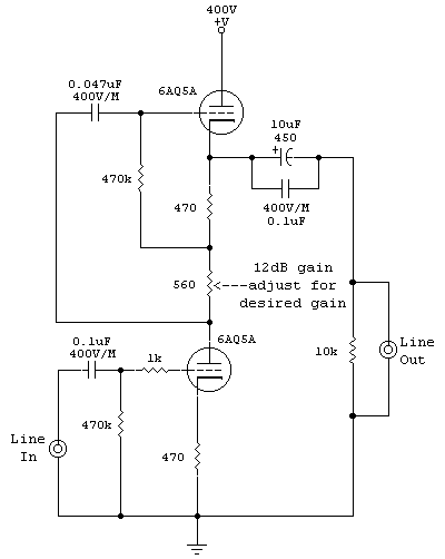

Do you use Circuit Maker Student to model your designs?
Here, I made this model last night of a triode-connected 6AQ5A - go nuts! 🙂

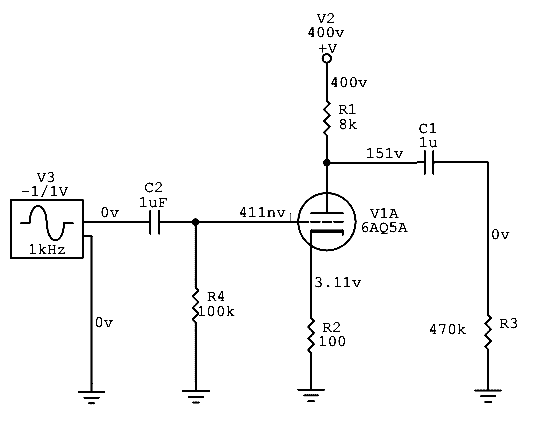

Thanks for that model 🙂 i haven't used circuit maker, but i got it to give it a go. Here's what i've got so far, please let me know if i'm on the right track (probably not).
anyway....
Hmmmm, not bad Geek. I might give it a try, but as i only have two tubes, one half of my stereo might get lonely 🙁
In relation to the above post, does running it as a triode with a cap output reverse phase?
