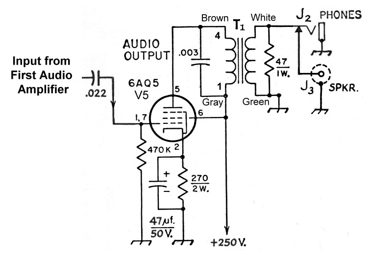

6AQ5 is a mini 6V6. Look for a 6V6 plan and power it a little lower.I have 6aq5 lying around
Nice. Thank you. Is 6aq5 a good sounding tube for headphone?Et voilà. T1 should be 5k:32R... If there's not enough gain, drive it with a 6n1p.
Which tube is better sounding tube ?6AQ5 is a mini 6V6. Look for a 6V6 plan and power it a little lower.
How much current this circuit draw?Et voilà. T1 should be 5k:32R... If there's not enough gain, drive it with a 6n1p.
Superb. Thx alot.6AQ5 is pretty linear as it is. For a headphone, you can just connect it as a triode since you don't need 5 watts of power.
Electrically, 6AQ5, 6V6, 6P6S, and 6P1P are the same.
I have output transformer with primary 3.5k 25H. Guess wont be good enough right?Et voilà. T1 should be 5k:32R... If there's not enough gain, drive it with a 6n1p.
