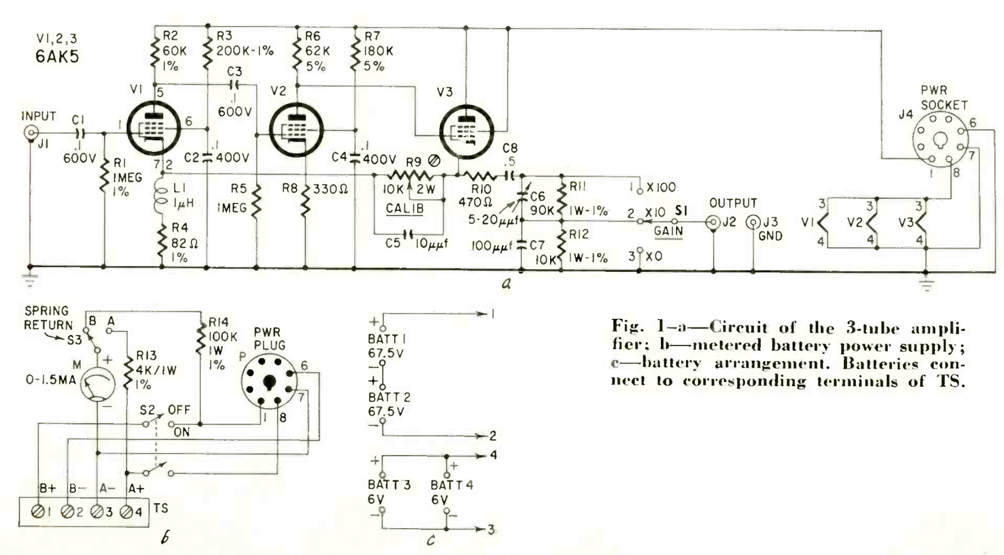

I have ATTEN ADS 1062CML 60MHz 2-channel digital oscilloscope and it has a major problem - poor input sensitivity. Some applies to other consumer grade digital oscilloscopes with cost price around several hundreds USD or Euro. By a chance I found in very old Radio-Electronics magazine low-noise (300 uV output noise with input shorted) high-sensitivity amplifier based on 6AK5. Frequency response 5Hz - 1 MHz, amplification factor 100, max input voltage 0.25V. Amp is immune to high-voltage overload typical for vacuum tune circuits. I powered it from 4 x Li-ion 18650 batteries with nixieclock.org NCH6100HV (12-24V input, 85-235V/24mA output) buck step-up converter and LM317 for 6.3V filament. Both available on Aliexpress.
Article in PDF format and LTSpice files (original schematic and my mods) enclosed in ZIP archive.
I assembled original schematic on prototyping board and it didn't worked as expected, it oscillates no matter what. Additional symptom was low plate voltage on first two 6AK5 (around 45 - 50V with B+ = 135V). Verified assembly many times, replaced NOS Siemens 6AK5 with 6Z1P, no changes. I suspected noise from NCH6100HV buck step-up converter but its not the case since amp is connected with C-R-L-C filter with electrolityc, film and ceramic capacitors.
Finally I have given up and brought this amp to my friend who have more experience. He modified screen grid bias (added R14 and R15 on LTSpice schematic) so voltage (on screen grid) is about 30-31V. Amp is working now. This all is quite strange since it was assembled in Radio-Electronics test lab and they confirmed amp data.

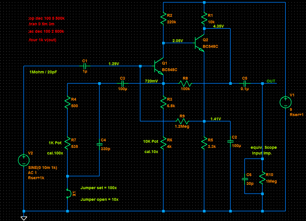

Depends on what bandwidth you need. I use an OPA1641 as a non-inverting x100 amplifier, but it certainly won't go to MHz. Sadly, not many bench meters have a pre-amplifier output, but if you have one, than that's a handy cheat.
Open loop gain is about 60dB, 20dB feedback applied.
If it oscillated before R14 and R15 were added, your build is conditionally stable at best.
Which means that the problem could return any time, depending on source or load impedance or tube aging.
Parasitic capacitances and wiring inductances can cause one build to appear stable, another one unstable.
As an additional precaution I would at least fit 1K grid stoppers on all 3 control grids and 100 ohm stoppers on all 3 screen grids, short and directly soldered to the tube pins.
