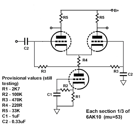

This is just something I've been playing around with. I've never tried anything with a CCS before, and in this tube you get a third triode "for free". The mu of the tube seems high enough, for the CCS(ish) tail, I injected an AC signal at the plate and measured the AC impedance at around 30X the DC, so it's better than a resistor I guess.
The grid needs to be held near 0 (relative to cathode) to pass enough current to let the top pair work well. Most of the designs I found on the web use a divider between B+ and gnd to set this value. Are their any downsides to using the cathode to provide the ref V, like in the diagram?
It works OK with a constant amplitude sine wave, but I've not tried to hit it with any transients or such so I'm not sure this method of bias is stable.
Anything else I should try out?
Thanks...

I wouldn't recommend anything like that. Triodes don't make very good CCSs. You'd be better off using two triodes as an LTP with a cascode of BJTs under the cathodes, and the third section as a pre to help make up for the half of the gain you lose with the LTP.

I've seen designs like you describe, but I want to leave transistors out of it just for the sport. It seems good enough as it, the outputs are balanced within 1% so long as I don't load it too hard. I'm just not sure how it will behave faced with real music instead of a test signal.
On the other hand I could just stick a resistor on the tail and balance it by making the plate loads different, and then use the third tube for a preamp as you suggest. Maybe a better idea?
It's going to drive a PP (dual Pentode compactron of some sort) output stage, the idea is a "2 tube" mini-amp that puts out about 1 clean watt. Doesn't this mean full gain (1/2 pushing, 1/2 pulling) and not half gain? This point still confuses me, I've seen it stated both ways.

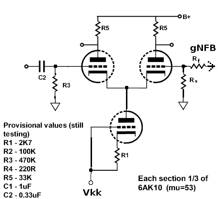

If you still want to go that route, then may I suggest this (attached)?
Operating the triode off a negative rail will definitely help performance quite a bit. That also frees up the opposite side of the LTP for use as a feedback node. You could even add a pot there, and make the gNFB variable.

I'm going to try the negative rail ideas. Then some of the others. This is all on a breadboard so it's easy to try lots of things.
Basically this is kind of a "MacGyver" exercise (for those that remember the show). I've got a bunch of compactron triple-triodes I bought cheap on an impulse, and I'm trying to see what I can make out of them. They were cheap enough that if I burn up a few in the process of trying crazy stuff I don't need to shed any tears. If I were designing from scratch I get that there's a lot of better ways to do it.
(BTW, the cap marked 0.33uF in my diagram should be 0.033uF)
