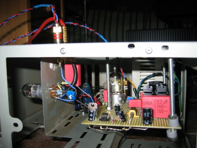

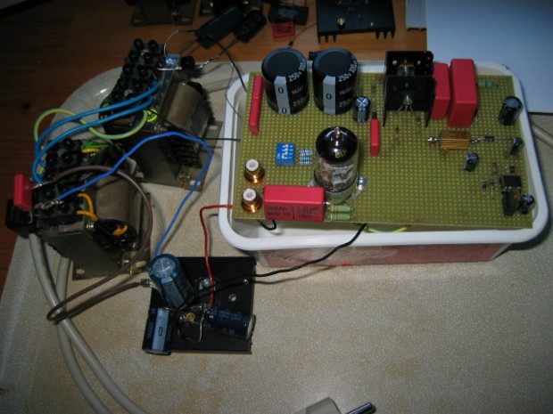

but I finaly menaged to compleet one chanal of Hampton MC pre-pre. There is no chasis yet, and the grounding is probably poor (see picture 2) but this is still just a test board. Sound impresions as it can be heard on only one chanal are great. Only disturbing noise feom the speakers is low frequ. hum (grounding I supouse) at high listening level.
Not necessarily grounding. At these levels it's very difficult to have no hum without some type of screening
Exactly...
I'd use alot thinner wire from the RCA input to the tube and output too.
Wires that thick are just acting as big aerials to their environment.
Also, for best detail resolution the tubes should be carefully matched.
Cheers,😉

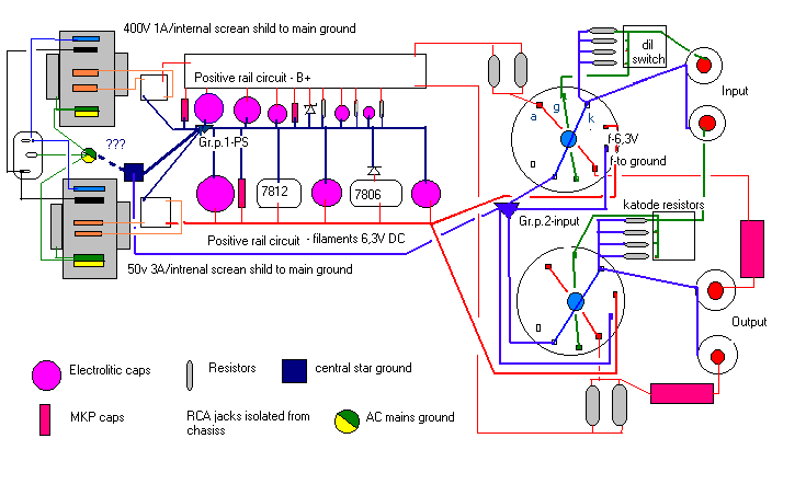

Yes, wireing and layout tehnics is the art that require a lot of expirience. I do not have it.
Well, like I said it`s only a test board, and the hum isn`t wery loud so I supouse it can be solwed. I`ll try a star grounding shema with two local star points (one for PS and one for input stage) and one main star ground point somewhere near the mains socket.
Any sugestion or pointing to some reference, regarding layout and wireing (or anything else) will be wellcome.

Sorry to say so but it's nowhere near to star earthing.
With true star earthing every single negative connection receives its own lead to ground.
Cheers😉
Cheers😉
OK, I do understand that this is not a thrue one point stargrounding, but what are the local stage ground points AIKEN article is talkig about then? PS local ground point, preamp stage ground point... , conected on central star ground point?
Are you saying Frank that this is not a thrue star grounding or you are saying that I made a totall mess out of it, useles for this purpouse? Point me to some basic and not permitable erors please.

Everyone seems to have his own philosophy on the matter but to me a single earthing point seems to give to best results.
Since this is a MC Headamp I'd certainly recommend implementing it carefully.
Yes, it's not a true star as you're combining a bus and a star ground in one.
This isn't necessarily an error, it will work, only with a little mre effort it can be made better.
Even without chassis as a shield it should be absolutely humfree.
Cheers,😉

Well. I supouse I`m not going to bother myself anymore with the MC pre section. After I puted transformers in a seperate enclosure, after I completed the second chanal of preamp, and after I implementd three point stargrounding (all high voltage grounds are conected to the minus pole of first HV filter cap with separate wieres, same at the filament section which is star point 2 and same at the signal circuit-see zipp) I don`t feel any need to change anything. This stuf is realy great. Only noise I can heer from the speaker now is one, produced by my Paravichini tube phono preamp-tube noise at silly gain levels. On the friends SS preamp there is allmost total silence at normal or higher listening levels. I`m shure that fet loaded anodes can sound bether or be quieter in this implementation, same for the one point star grounding, but based on expirience by buildng it using original schematics, I can say it`s fubules anyway. Highly recomended.
