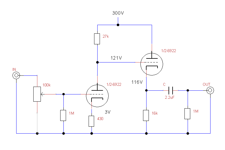

I would like to build a line stage preamp using a pair of 6922's and as few parts as possible. This is my second attempt at creating a circuit like this. I think I've got it, but of course it would be wise to get some more knowledgeable people to view it before I build it and subject it to high voltage.

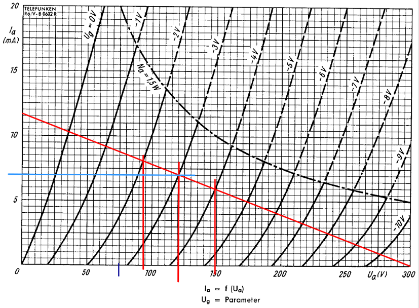

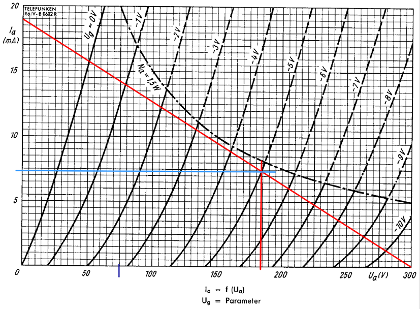

So does this make sense, what I've done? I've attached the schematic and the load lines for both stages.

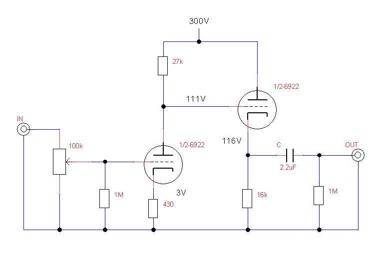

Rookie mistake. Thanks for pointing that out.
121V should be 111V. That actually makes 27k the exact right value instead of the closest value, so that's good.
I've attached the fixed schematic.
