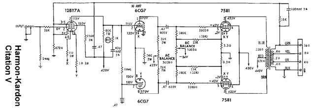

Harmon Kardon V
Hi Tony,
one more, or you can find the circuits on:
http://www.machmat.com/schema/index.htm
Rgds

hi ! a long time ago i build this http://sarris.info/main/pushpull6550
may be it is interesting. uses EF86 and ECC83

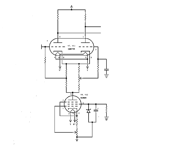

A few belated remarks from someone who has also been in the game for several decades.
One tends to overlook some time constants with the popular view that a directly connected LTP has only one set of coupling caps "in the signal line". The cap to common from the second LTP grid is as much a time constant as one "in the signal line", thus two time constants C-wise. While this is not usually a problem because it could be made very low, it should be such. Apart from phase shift, its presence will create an unbalance at low frequencies, the very place where that cannot be afforded.
(I am not here to criticise, but in the circuit shown by Richw in his post #19, all of C6, C7 and C19 form time constants - apart from the also sometimes overlooked power supply caps. As signal return they are also in the signal line!)
Then another small point is that while it is attractive to use a CCS as the tail of an LTP, such a circuit also needs to have sufficient linearity with frequency. E.g. using "attractive" power supply regulator chips are usually out. Also, such a circuit only guarantees a constant current through both tubes summed, not necessarally equal division of such through the tubes (each triode) in case of unbalance. While we have all the wonderful modern components for a CCS, I could never bring myself to using one instead of a good resistor and some adjustment in the anode circuit. Guess old habits die hard .... 😱
My own choice for a top quality circuit has always been the Williamson topology, despite the two time constants (as said, the "direct" coupled LTP has it too). In a high quality 100W design using the partial cathode feedback output topology (a la Quad II), I have all of four cap time constants while still getting l.f. stability. But as Richw warned, I would also advise the availability of at least an oscilloscope and signal generator (with square wave) to keep away the blues.

Johan Potgieter said:The cap to common from the second LTP grid is as much a time constant as one "in the signal line", thus two time constants C-wise.
For those LTP circuits that are close to the output stage where bias requirements for certian tubes used are higher, then a capacitor from the lower grid to ground is a factor. However, when inversion is done early on, as in the first stage with low bias tubes, a capacitor is rarely needed. A low value resistor will do the job especially when the lower grid is used as a NFB input. But as I said earlier in this thread, it's really designers choice since there's several ways of doing it and making it work.
Then another small point is that while it is attractive to use a CCS as the tail of an LTP...such a circuit only guarantees a constant current through both tubes summed, not necessarally equal division of such through the tubes (each triode) in case of unbalance.
I used to think that way too. So please correct me if I'm wrong here. A LTP is, in essence, a differential amplifier. If it were a steady state DC amplifier only, then your statement would be perfectly true. But it's AC so it's pushing and pulling each ½ cycle. With an active current source that becomes dynamic in it's action, it wants to regulate current flow through each tube (or section) to a set value for each ½ cycle. This is why even value plate load resistors can be used for resonably (but not perfectly) balanced tubes (or sections) without further adjustments. Of course serious imbalance would be another story. Again, designers choice.

One or two resistors?
Hi Rich,
If there is a difference in current draw between the two EF184, where would you place the penthode in the STA100? - seems to me to be difficult, if we keep the original design. Or did I understand you wrong? How can we regulate balance if we exchange the gnd. resistor R14 1K5 with a penthode ? Don't we need a cathode resistor for the first EF184 in order to messure current? We allready have R15 180R for the second EF184.
Rgds
Kim

Re: One or two resistors?
Have a look at this.
www.freewebs.com/valvewizard/ccs.html
read explanation regarding Current Source balance. This should put one in the picture.
Since the STA100 LTP has a low value tail resistor (1K5) this implies quite a low tail voltage circa (24V) and is asking for gain/ drift trouble. (O.M.O the original behaves poorly). The way forward is to use a pentode or triode as CS with a quiet -100V neg rail. Power amp users using fixed bias should be able to steal sufficient neg volts.

I lashed up an LTP using EF184 with a ECL82 pentode as current sink strapped to a minus supply to improve the CCS voltage range for the pentode, only to find the ciruit went into oscillation. In some ways this was expected. As the EF184 is effectively a high slew rate tube, the socket wiring becomes ultra critical.
Morgan jones valve amps 3rd ed page 168 does mention the risk of instability with cathode followers, which this is. So there may be some merit in looking at a tamer med mu circuit, the previous on this thread using 6SN7 (or sim) in the simplest diff pair.
One could try using a transistor as a CCS; in an attempt in a more compact arrangement and avoiding a neg voltage.
However I have an old habit of not using Solid State in tube amp signal sources, just O.M.O.

May be 6DJ8/ECC88?
Hi Rich,
At first I try to adapt one 6DJ8 as CCS , just to find out how sensible the circuit is to different frequences and stability - on a woodboard it is quite easy to change the circuit for EF86.
I try to keep the tube amplifiers without Solid State as well, except for psu fet-regulation. I don't think it is possible to hear "fet's" when they regulate voltage for gain - and drivertubes.

HollowState said:I used to think that way too. So please correct me if I'm wrong here. A LTP is, in essence, a differential amplifier. If it were a steady state DC amplifier only, then your statement would be perfectly true. But it's AC so it's pushing and pulling each ½ cycle.
My remark regarding the CCS keeping only the total anode current constant (and your above statement), is as true for a cathode resistor (a CCS is only a high value resistor). I was comparing the 'advantage' of CCS over a resistor only.
Not to belabour, but it might be informative to examine what advantage a CCS really gives in practice. The cathode input impedance for a grounded grid circuit is (rp+RL)/(mu+1), and one can halve that for the impedance at the two cathodes of an LTP without much error.
One then finds that for a 12AT7 the value is about 800 ohm, and for a 12AX7 about 900 ohm working under popular conditions. That means that using a cathode resistor of 33K for the 12AT7 the output unbalance with equal anode resistors is only 2,4%. For 12AX7 with 68K in the cathode circuit, unbalance will only be 1,3%. (How many of us still use 5% resistors?).
Now a CCS could give 0% unbalance - if the two triodes as well as the anode loads were absolutely equal. (I rather doubt that too many twin triodes will have equality to within <2%, including aging. After that, what about the matching of the output tubes? Are they < 2%?)
