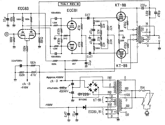

As I am about to build a PP amplifier for a pair of 6550a, and I would like to ask, if someone has experience to the drive circuit - input and driver.
The intension was to use the old circuit from Michaelson & Austin, but if some DIY people has experienced and tested a better configuration for the Tungsol 6550a tubes , I really would appreciate some help with the circuit stucture.
Has anyone out there some knowledge for a modern, or more up to date design, when we speak about the 6550a tubes?

Thanks, - I was not sure whether the cross-coupled interstage tube , and the cathode follower design as in D79 was necessary in order to get the phase right, and secondly - was it really necessary to use that many tube stages to drive a pair of 6550's? A larger number of tubes was seen in McIntosh 275 as well ( one amp I have never heard) . I have listened to the D79 and the sound , after my opinion, was soft and still with good attack in the deep region.
I understand , and what I hoped for, that the long tailed pair and a high performance output transformer are the more important issues when building a good tubeamp.
Could you please let me know what "CCS" is? Please let me have your opinion at the attached TVA-1 design. THe circuit contain not two, but four caps ( two phace) , and you advised me of having only one pair. Third ( I promise to stop now) Could you recommend any output transformer of high quality - We got "Sowter", and "Lundahl" in Europe?

There are so many issues; what B+ ; o/p power?; input sensitivity
are you after ?
A concertina phase splitter with Williamson interstage driver will give a lower output Z to the output tube grids hence better top end performance than the longtail phasesplitter , esp when quite low value grid leaks are used for the output stage. This is a tough challenge esp for distortion.The Svet 6550C version quotes around 100K for fixed bias, which is a darned sight better than 50K for the early A version but I’m not sure about the value with TungSol reissue tubes.
Read up Morgan Jones, 4th edit Valve amp p. 415 mentions the poor performance of the Mullard 5-20 which uses an ECC83 as LTP and one should avoid this signal tube for such tough tasks.
. If you are looking at a -3dB response at 50Khz with a good quality output transformer then expect a driver stage to consume current to deliver the goods and to avoid early response slewing and distortion.
There are other issues, a 3 stage design is more stable than a 4 but with correct optimisation a 4 can be made just as good.
The 3 stage configuration shown in the Radford STA25 Renaissance which uses an ECC88 cascade and 6U8A (ECF80/2) as a beefier longtail pair into 6550’s, could be the configuration you want. At the moment I cannot copy pics.
If you aim for good interstage driver performance then I find 6550’s give better sonic performance than KT88’s (O.M.V).
As Victor mentions, a top notch output tranny is instrumental to performance.
I regulary use an ECF80 as concertina p/s followed by Williamson config 12BY7’s as triodes (expect 30mA current per pair); driving 6550’s and I get very low thd.
A four stage amp using a concertina p/s with 20dB global nfb with give a signal/noise ratio around -60-70dB down whereas a 3 stage using a LTP using the same global nfb should acheive nearly - 85-90dB down.
The -60dB noise figure will just be noticeable from a tweeter in the average distance/ listening position esp when a pentode is used as the input gain stage. I often use a pentode duped as a triode, this is useful when a line sens approx 0dBv (0.77V) is only used, signifigantly reducing the circuit noise.
The beauty of the concertina arrangement is no circuit tweaking for balance, whereas a LTP requires a pot /present to balance out for min thd.
If you use the concertina p/s, make sure the B+ psu ripple rejection is high, as the anode has a far lower PSRR.
Hi Kim,
CCS means "constant current source". It is a means of controlling current flow through the tubes and keeping it at a constant level as well as providing signal isolation. It can be as simple as a single LED or a transistor (or two) biased by a diodes. It could even be another tube. By keeping the current through the long-tailed pair even, you get a better balance and more equal phase inversion. Remember, it is the current through the tube more then the voltage across it that establishes gain. This works well up to a point because very unbalanced tubes (or sections) will still suffer. But it's better then a purely resistive tail and easy to apply. If you search this forum for ccs you should find lots to read. I think even John Brosky's Tubecad journal has a blog about them.
Whether an amplifier uses two capacitors or more in the signal path is really a matter if design philosophy and designer's choice. I believe the best capacitor is no capacitor. By directly coupling the input to the driver (or inverter) a capacitor is eliminated. But this comes at a price. The next stage must be elevated more above ground to remain biased correctly. This requires a higher B+ level from the power supply and more cost.
More capacitors means more total phase shift through the amplifier which can translate to instiblity when global feedback is used. So the design becomes a little more fussy in that respect. But at the same time, another capacitor can make the design easier in certian ways.
Recommending an output transformer is tough. I always use NOS American because I have many. But I've heard good thing about Lundhal and Sowter. Also about Transendar, Electra-Print and Edcor here in the states.

You mention two B+ voltages: in Ultra Linear mode the 560V is out of the question for 6550 (whatever brand) but can take this in true pentode. Choose mode !
The ECF80 triode is rather nice, cheap with a low mu and makes an excellent concertina p/s. The pentode isn't screened and requires respect, microphony, hum etc, so I always use this in triode mode with line inputs.
Since you will have a high B+ (460+ will be required to get 70W), the direct coupling from input to driver tube isn't an issue.
If you use global nfb, a high pass LF roll-off in circuit is essential to correct for phase shift below o/p tranny cutoff.

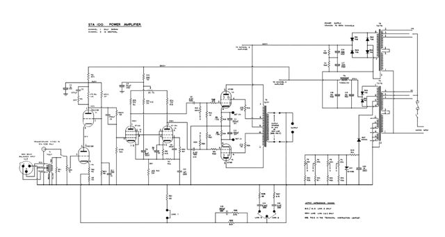

Kim, a couple of circuits faxed over.
The STA100 Radford is an interesting arangement and may suit you well. The values of the feedback components will most likely differ if a foreign output tranny is used. Shown with KT88 outputs, UL operation at 600V is a heroic voltage.

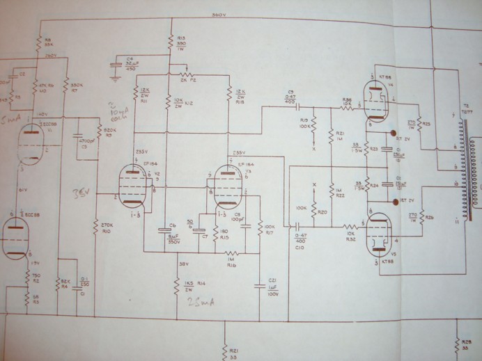

Throwing the spanner in the works....Several decades ago I examined the Radford STA100 LTP phasesplitter for a specific circuit. Used in full pentode mode the gain on gain and volts on volts on paper it looked attractive but I found it performed poorly (when loaded) compared to the conventional concertina and a balanced Williamson push-pull voltage driver as shown in the 4 stage GEC 88 circuit.
Having setup the basic LTP Radford arrangement, (in pic) it gave 0.8% THD with a measly 25+25V rms output drive at 1Khz and 1% thd at 10Khz. In addition C7 on 2nd section LTP required tweaking to 100uF to avoid LF misbalance. All in all the Radford STA100 3 stage amp is a high flyer and replies on a high amount of global nfb (++30dB) to correct for circuit shortcomings to get thd down to 0.05% at only 60W o/p with a B+ of 600V. No thd figure given for the rated 100W or a dB under clipping which is my procedure.
My view is that tube HiFi amps should provide a distortionless output, right up onset clipping. The reason for this is soundly obvious.
During 1960-7, many designs adopted the LTP, the Mullard 20W is another example which relies alot on global nfb for stability against linearity. (Read up Morgan Jones Valve amps 3rd edit p.417). Alot of amps built around this period also had abysmal quality power supplies as electrolytic cap technology wasn’t fully developed.
I stopped doing more measurements when I came across a preamble note which claimed that amps using LTP and massiveamounts of global nfb for hi-fi, sounded duller than other phasesplitter configurations. This is a controversial topic found in many forums, made me think than those 1960 amps using LTP also had very good s/n ratio figures but sound quality was poor. At that time, anything was out to compete with emerging solid state amps.
To sum up,there are good LTP tube amp designs around 10-30W o/p around which use only modest amounts of global nfb, it is a fair comment to make to those enthusiasts who are new to tubing hifi amps, is start with a tame design without the full blooded +30dB global nfb, and get “fingers-on” with a simpler but excellent sounding Williamson (traditional concertina and push pull voltage driver) at the expense of poor s/n ratio and lower global nfb. The choice is out there. This is more likely to get one up and running . In the past 40 yrs I’ve debugged so many experimenters amps, owners who have copied a high flyer amp design, and without necessary knowledge and test/bench equipment is a recipe for dire trouble.
Stay simple unless one has the competence for a real adventure. The long and the short; anyone beavering with power amps should automatically do the math and keep notes to avoid doing silly mistakes.
Maybe the way forward is to try these power LTP circuits with a CCS in the cathode tail and see how they (brilliantly) perform. It does seem strange that this technique wasn’t adopted on the day, some 45+yrs ago.

As promised the two circuits I received from Mr. Rich Walters. I have been looking through my own schematics and found the mentioned circuits in the database.
1 Radford STA100 and 2. Harmon kardon V
Rgds Kim
