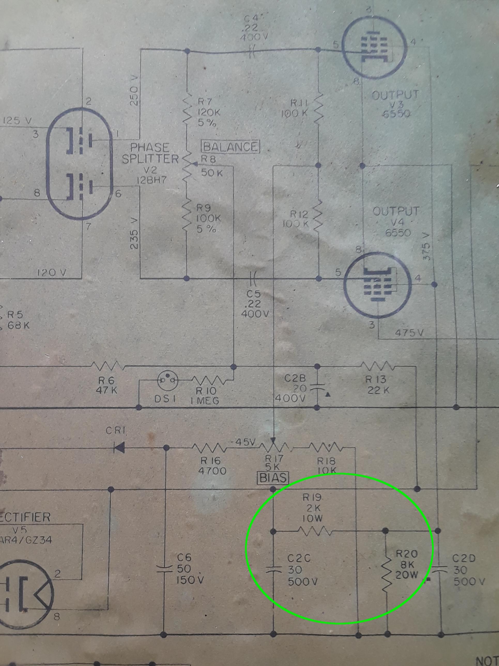

I have two Stromberg-Carlson Model AP-437 mono power amplifiers and the schematics under the hood for the two are different but they are wired the same. One schematic, the one that is how they are wired shows a 2k serial resistor to the screens and an 8k shunt resistor for a screen voltage of 375. The plates are ~520v. The other schematic shows a 470R serial to the screens and zero shunt resistor, the screens are only 5v less than the plates, which to me is too high.
Has anyone seen these amps before and why are there two variations? My thinking is maybe the 6550s were failing with such high screen voltage and so they decided to lower them via the resistive divider.
The 8k shunt resistor is above the chassis, the type that stands straight up and they both are failed. Someone else added large wirewounds that I do not know the rating but look like 20 watts and they are screaming hot and blackening stuff underneath. I currently have mounted 50w chassis mount resistors under the transformer cover using the chassis as a heatsink and it seems to be a little better. But I am curious about why there are two different versions. And maybe going with just the 470 serial screen resistor can be fine but I have little experience with the 6550 and that seems too high to me.
What do the 6550 experts think out there? What should I do? Leave the large chassis mount shunt resistors and lower screen voltage or go ahead and run the screens at 515v?

Oh okay so you are thinking that maybe the extra 20 watt resistor top side was failing and so they said lets just run the screens at anode voltage. That makes sense to me since both the resistors have failed. The bias voltage must be higher with the higher screen voltage which if I change it I would modify for this.
I also don't have any plate characteristic graphs with the screen at 515v, and I do not know what the load impedance the output iron is but I could easily calculate it, the former is the more difficult thing to obtain. So I don't know which operating condition the output transformer is optimal for. If your assumption is correct in that the first iteration is the one with the 8k shunt resistor then I would think the output transformer load is optimal for the lower screen voltage.

I think you'd find with a commensurate shift in bias and screen voltage that the operating conditions will be virtually the same. (This is the problem and benefit of pentodes.. LOL)

You've got over 25 WATTs in that divider. Is it cold in your house?
That amp can't need over 300V on screens. Use a MOSFET to make a low-loss dropped supply. Total screen circuit dissipation will be 1W-2W.

Here is the original schematic attached inside the amp. I circled where the 10 watt 2k serial resistor and 20 watt 8k resistor are. The replacement 20 watt resistor inside the chassis was VERY hot so I replaced them with 50 watt ones inside the transformer cover. This is what i used and it's much better than the wirewound 20 watters.
EDIT: I also replaced the 2k resistor with a 20 watt ceramic so it doesn't get as hot either. I went with 3k3 instead of 2k and I changed the 8k to 8k2, I have 360v on the screen and 520 on the plate.

I'd run them at 350V - performance will be just fine.
I suspect the resistor picture is just a stock photo and not what you put in your amps. (It's 8.2 ohms)
That voltage divider is consuming something like 50mA, if you have space you could install a pair of gas tubes running at 20 - 30 mA or so, greatly improve screen regulation ( = less distortion) and reduce power consumption slightly.
Yes there is the divider + the screen current across the 3k3 and then just the divider current through the 8k2. So about 55mA through the 3k3, and 45mA through the 8k2. I don't like it but that's how it was designed.
I like the idea of gas tubes, I just actually put some 0D3's in my 6HJ5 amp (mainly for looks) but I want to keep the looks of these original, and the circuit as original as possible for resale purposes. People that buy this stuff want it as stock as possible.
So it looks like I will keep it as is with the screens down around 350, the tubes should be happier and the performance should not suffer.
