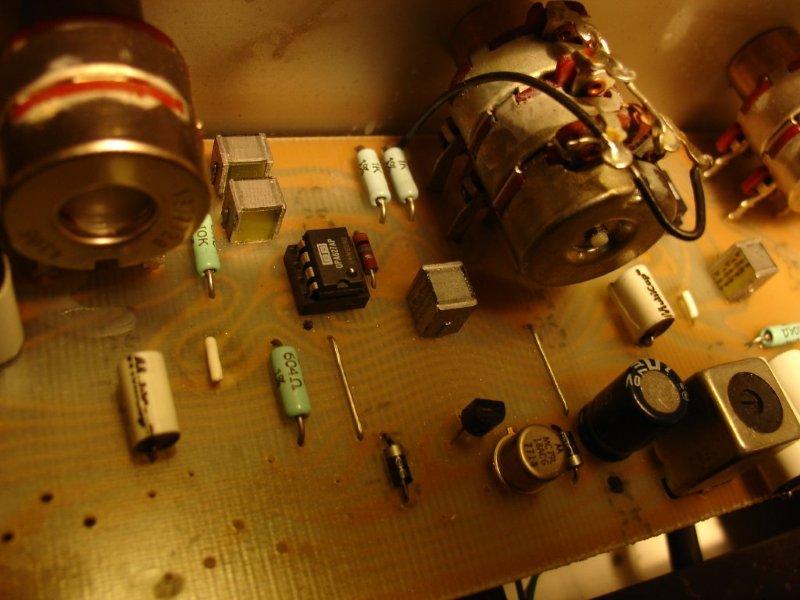

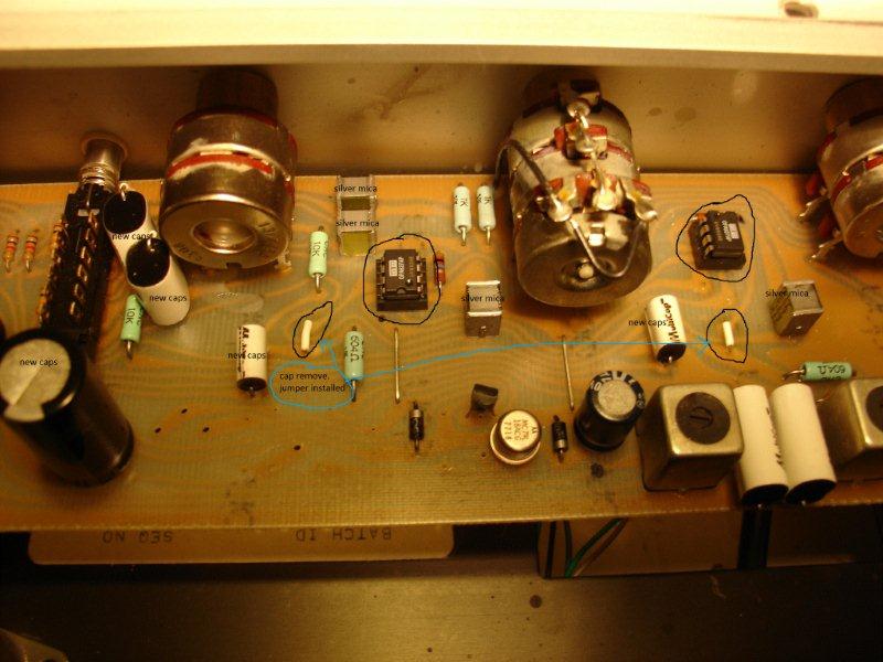

OPA623AP
I used the burr-brown OPA623AP, on the main board, it dropped right in! I have not done the phono section. I don't know if the one you want to use will work. As I said, I changed all the caps except the silver mica, those were made by siemans and are very good. Here's some pics.
Peter C.
Peter C.
