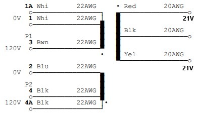

For a tube based project, I am needing a transformer to supply 0-640v@100ma secondaries...
I have a 100 - 120VA Toroid that has 120v primary and 21v secondaries....and reason to beleive I cannot use this toroid backwards?
Have not tried it yet...thought to ask those far smarter first...

Whoops...Thank Jan, you saved me a transformer...was blindly looking at step up/down ratio
But dont we run toroidal transformers backwards all the time?
EDIT - OK, I see that if the pri/sec voltages awere a bit closer, running reverse could work... I have used a Triad N68X backwards (120v - 240v) for a preamp years ago....
A transformer has an idle current which is determined by the voltage and the inductance. A 21V winding has a relatively small inductance that would not limit the mains idle current, and the transformer core would saturate, causing a huge ~short circuit current. Toroidal transformers are wound with just enough inductance to prevent saturation under normal conditions, but even a zero-crossing startup can temporarily saturate the core. A cheap transformer will be wound with a minimum inductance in order to be able to claim higher power handling, but it will be prone to inrush current problems. For reliability, it is a good idea to de-rate the winding voltage, ie use a ~130V transformer at 120V.
steveu - yes, thank you for the full explaination...I thought since I was needing only 100ma@640v, backwards could work since it was rated for double the VA.... but now understand otherwise
