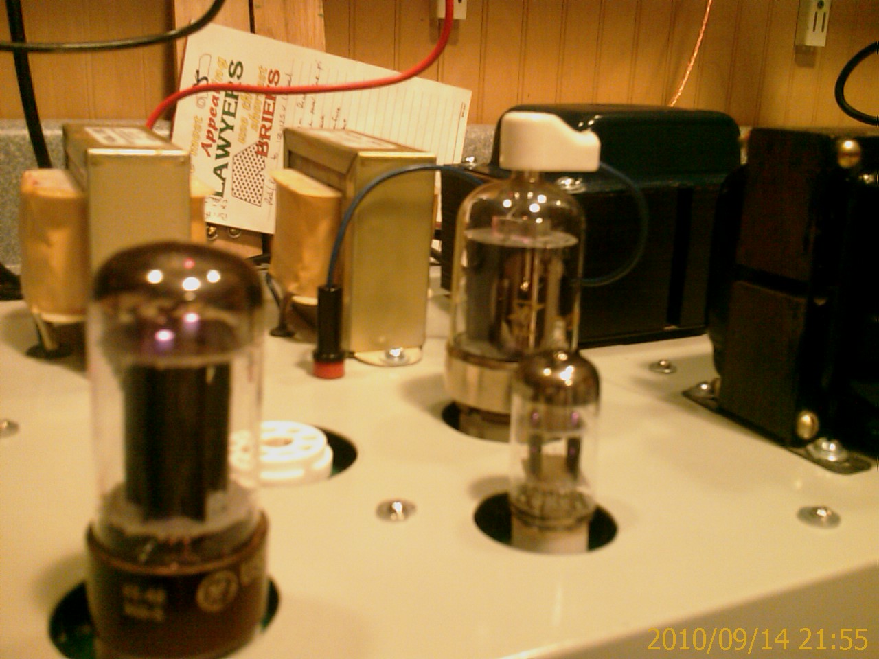

Once the plate connection is taken care of, the material difference between running 6BQ6's and 6146's, at least as far as pin out is concerned, is that the 6146 has its screen on pin 3, and the 6BQ6 has it's screen at pin 4. Because the Simple SE board brings both pin 3 and 4 to a separate isolated pad, it is a simple matter to wire the new screen supply to pin 3 or 4 as required.
6: I installed one 6BQ6A, put in a 560 ohm bias resistor, crossed my fingers, and powered it up.
The amp worked, surprisingly (!) but hummed intolerably. After a few minutes of colorful language, I stuck some scope probes in the empty 6BQ6 socket, and it looks like the hum is on my screen supply. I added another 100uf across he first C in my CRC screen supply and this did not materially affect the hum.
I reviewed the wiring and don't see any obvious ground loops, but can't rule that out. The input source is a battery powered ipod, so it's hard to see how that could ground loop with the Simple SE.

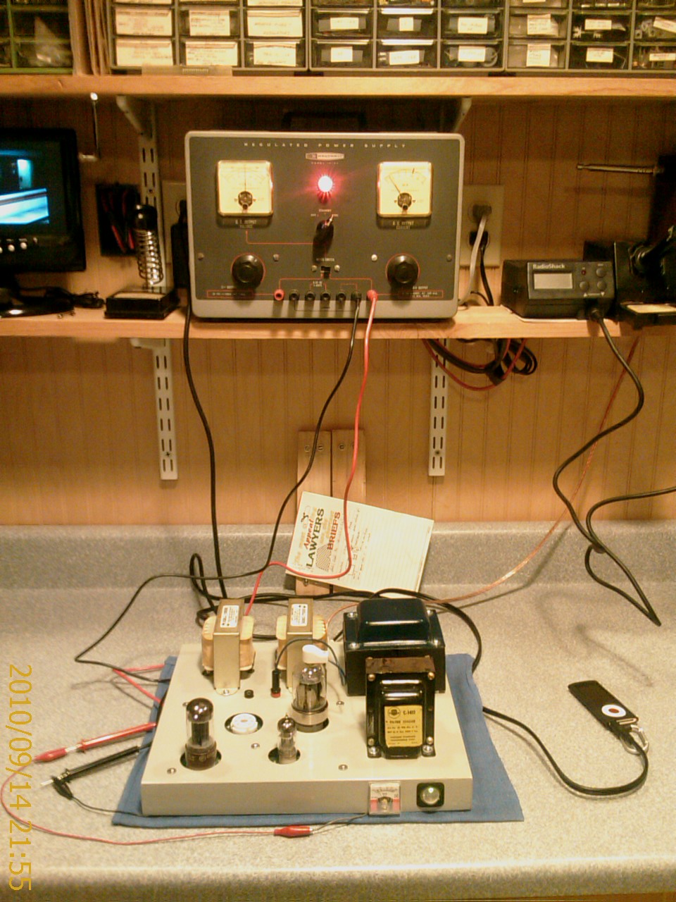

7.: I lifted my new screen supply line from my new screen supply board, and used an external DC supply to supply screen voltage, using my single point ground in the Simple SE as the ground reference. The hum diminshed dramatically, there is still a bit, but this, in my mind, confirms that my screen supply is the source of the hum.
8.: With 360 volts on the plate, 215 volts on the screen, a 560 ohm bias resistor, in pure pentode mode with no NFB, the 6BQ6 sounds surprisingly good.
9.: It was quite interesting to watch the screen grid action with the variable DC supply. The tube comes alive at about 200 volts on the screen, and from there to about 270 volts, there is about a 20ma swing in the plate current. Because the 12AT7 is still on this bus, it may have some contribution to this.

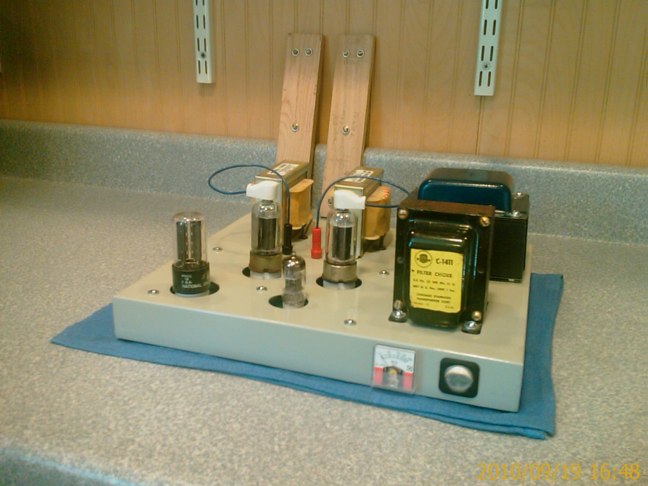

Running 6146A now!
Found it easiest to just move the 100 ohm resistor from pin 4 to pin 3. All other parameters unchanged from the 6BQ6GTB.

What's with the lawyer's magazine?

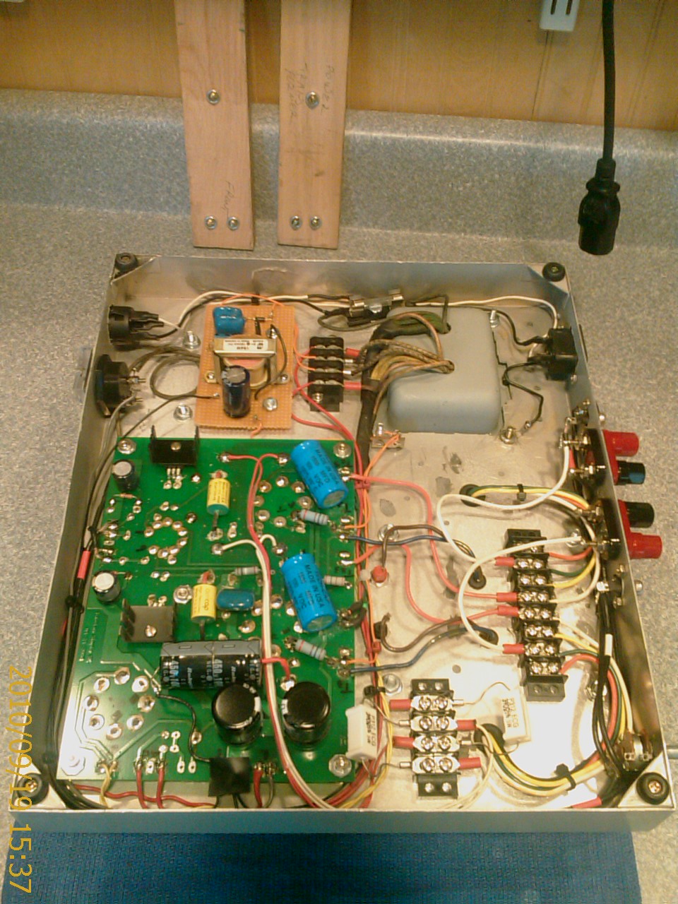

It's been back in service the better part of this evening, the 6146's in it right now are probably pretty crummy; of the bunch of pulls I dragged home the other evening I wound up throwing all but the two that are in the amp now, away, as all of the others wanted to run away.
While it was interesting in a Rube Goldberg sort of way to have half of each power supply on the board and half off the board, once I determined I needed to run the 12AT7 off the full B+, I discarded the split rail idea as being without merit, and reversed those changes I made to the Simple SE board.
The bottom line is that pins 3 and 4 of the octal socket need to be completely isolated, so that the appropriate component / voltage can be connected accordingly depending on the tube in use, and because these pins are brought out to isolated pads on the Simple SE board, they are easily isolated.
For the 6146 / 2E26 family of tubes, pin 4 has to be left externally unconnected as it is internally connected to the cathode of the tube, pin 3 needs correct screen voltage, and plate voltage goes to the plate cap. That's basically it right there, so what looked like an easy project was actually a lot easier once I got a couple of evenings into it.
I wound up with an LC screen supply. CLC (10uf, 2H, 33uF) was settling in at about 245volts loaded, which is too much for 2E26 and 6BQ6, and at the upper limit for 6146 and 6DQ6. LC sets at about 215 volts for 2E26 (above the rating, but they seem to handle it OK) and 205 for 6146. I made the LC from the CLC by moving the hot lead of the 10uF cap to the other side of the choke, so it is easily reversible if I want the higher screen voltage for traditional audio tubes.
Presently the amp is running 400 volts on the anode, 205 volts on the screen, and with a 510 ohm cathode resistor, this gives about 45 mils plate current / tube. Even for old tired tubes, these are loafing. I have the plate load set at 5K, and cathode feedback enabled.

Here are some top and bottom pics of the completed conversion showing the installation of the screen board. The thin orange wire is the screen wiring; the large orange wiring is for the cathode feedback.
