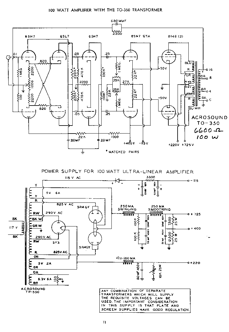

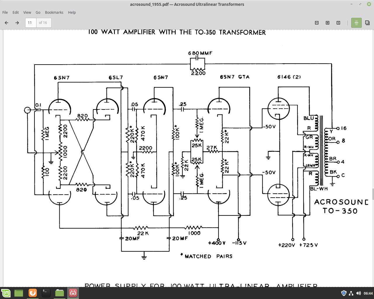

Andy: That design is one of the ones that gave me the idea for a 6146 Amp, using that very transformer. However, as has been said, it doesn't have that extra screen winding, and the 6146s look to be very unlinear in pentode mode. I would have built a design like that with regulated G2 instead, but I was told that it would be hard to wrap enough feedback around the Edcor OPT.
