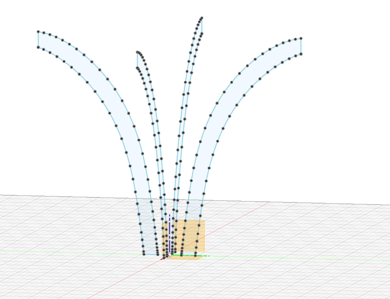

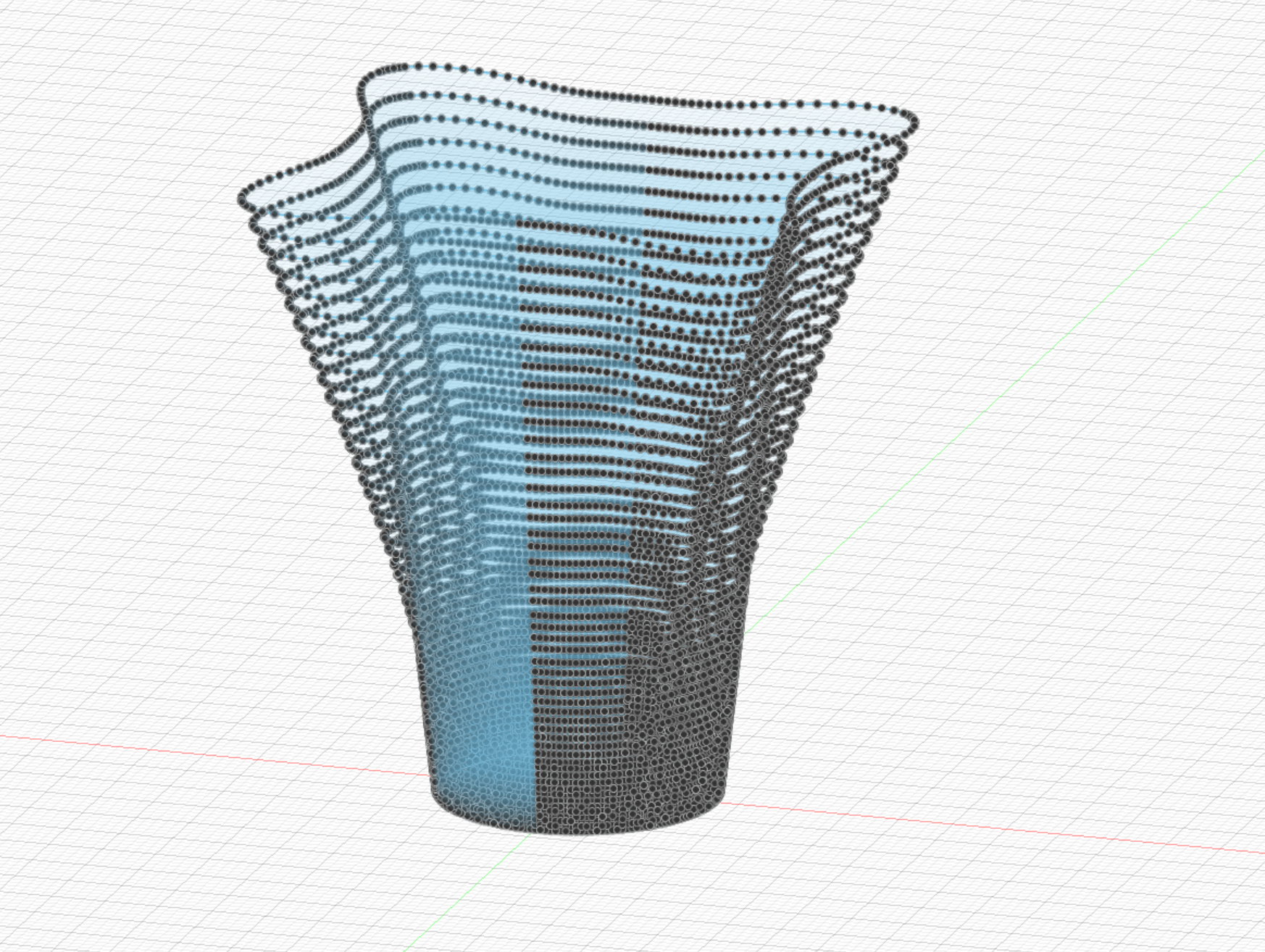

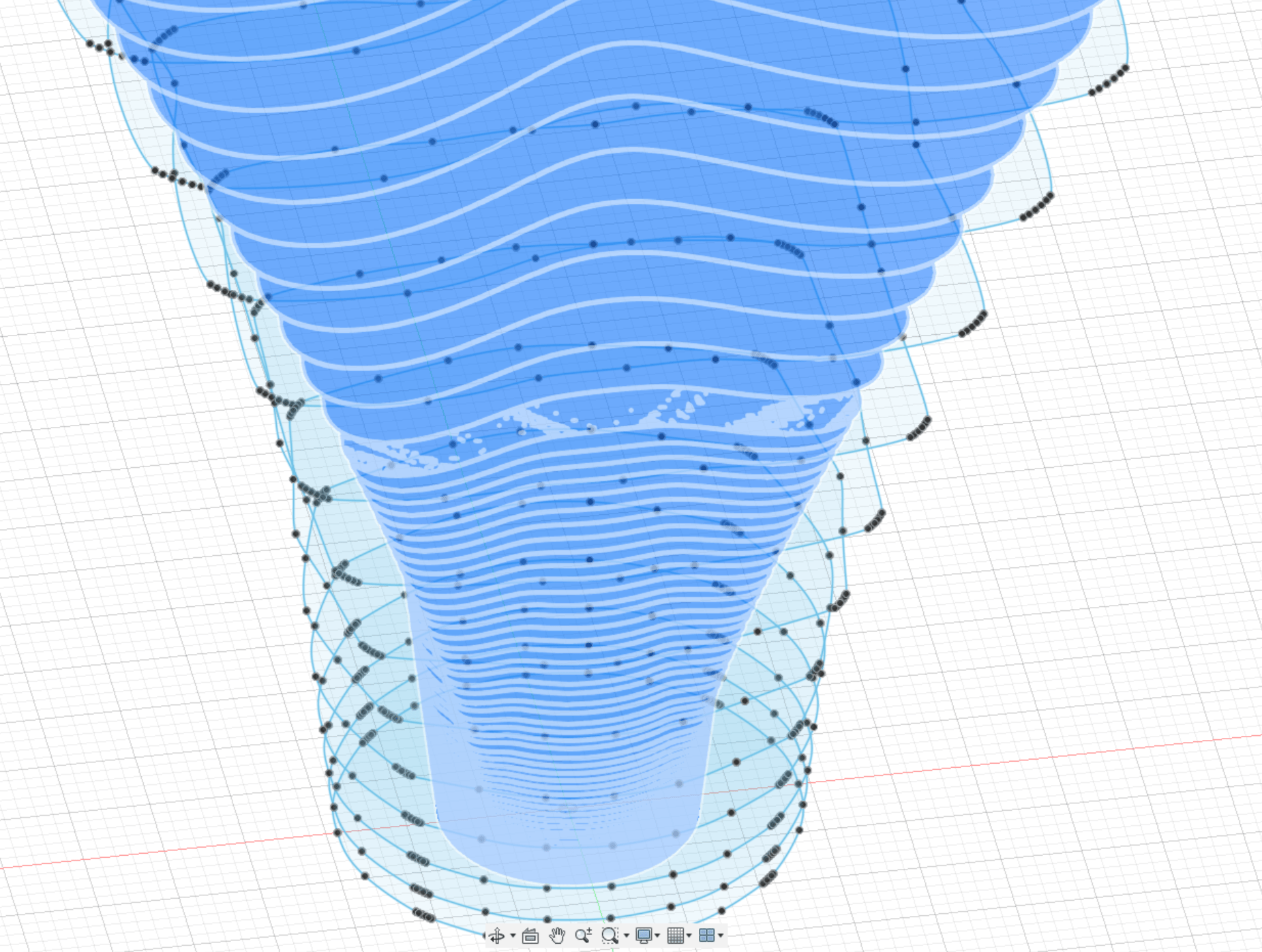

For lofting you only need the slices, you can have Ath output, slives, profiles or both. More points is not better, you only need enough to properly define the splines. More slows everything down and bogs the scripts to no positive end. Just the same with STL's and simulation, too much angular resolution does nothing helpful. Almost all of your struggles will stem from these two things.
Hi Fluid, all my issues were generally from stls being hollow and being unable to do much with them, although sometimes it would work, which encouraged me to struggle with them for longer than I should, even using blender to thicken them , etc. Currently I only use the profiles for making seams between parts and for easier generation of ribs for stiffening, otherwise all work is with slices. Currently I have quite a few components with many different set of slices and performance is smooth for most stuff. Completely different experience than when working with the meshes... I presume it is just how fusion handles meshes/stl's as I have a powerful machine and other programs like blender don't have the same issues.

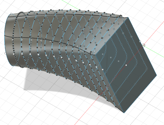

One thing I have noticed is that sometimes the fitted spline gets a little off target.
Have you seen this before? Looks like its the profile that is off, but the fitted spline runs through the points?
I thought STL's might have been a typo as the images were splines. Fusion really does not get on that well with meshes, and high triangle count ones will often crash it. Solid geometry or surfaces work much better.
Sometimes things look different than they are, the projected surface may not match or change when you zoom in and out.

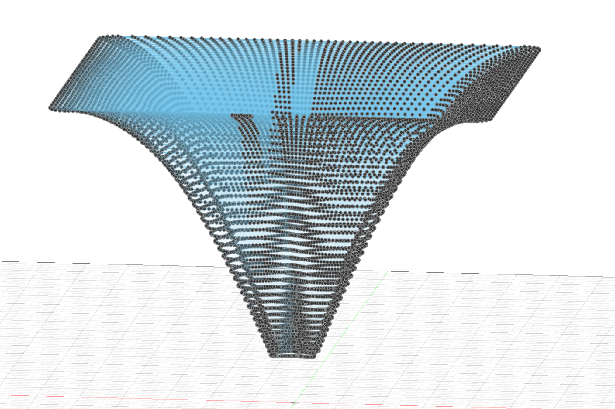

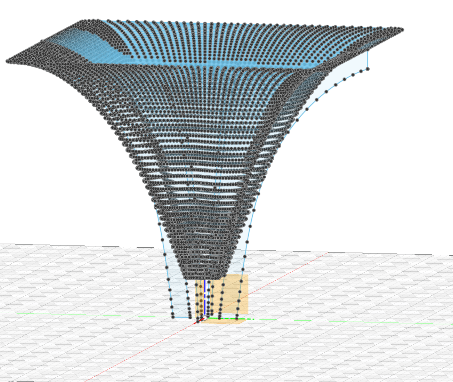

This code in the cfg file will get the proper csv file for slices to work with the Ath surface plugin.
GridExport:f360 = {
ExportProfiles = 0
ExportSlices = 1
Scale = 0.1
This is the 4ndf file fom your github with 64 angular segments, I don't see one that has the same throat shape as in your images but this should still be enough resolution for that. I have attached a fusion file with a 5mm thickened version of it. With the right workflow it only takes a few minutes.

Thats weird I just re-downloaded it from diyaudio to check I had uploaded the right version and it worked fine for me. I run it via utilities -> addins -> my scripts. Is it possible you are running the original Ath version as it has the same name?

I think you are right, it seems that it was only a visual artifact and the solid body is correct

There are various methods that work depending on what you want to achieve. I used thicken as an example and it is easy if all you want is the surface face made exactly the same to a given thickness. You can create different surfaces for the rear section with sketches, sweeps and lofts and then stitch them together to form a solid. Some things are easier to make as a surface, some as solid. Once you have the basic surface in Fusion you can project any of the profiles. The Mouth and throat can be patched and the surafaces stiched to make a plug which can then be cut from a larger solid block. It all depends on what you want the outside shape to be.
The key is to get the waveguide surface lofted into a whole. For non axisymmetric guides made with Ath, the surface plugin and slices made with the code above are the easiest way to do that.
