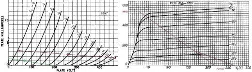

Let's try to get more practical
Keeping the power voltage low has the advantage that the driver section doesn't has to get into trouble and possible use of a power transfo for UPT.
I first tryed (only virtual ) a ECC81 ( forgot to take ou the gridstoppers, not needed any more) voltages looks to out of range but much gain.So, switch to a 6SN7 with a "design centre value" of 450volts on the plate with some positive feedback.
For the DC resistance i asumed 25 Ω (Rp).Anode dissipation of 16W is to much according to the data but the (allmost) same PL500 (or 504) is rated 16W.The transfo 2x115V to 18V is not exactely right but the closest "normal" obtainable.How about it ? ?

Mona, that is a very intetesting bootstrap going on, very reminiscent of what was used in transistor amplifiers designs back in the 60s and 70s. Worth considering since it potentially minimizes or eliminates the need for the negative supply even with a differential driver.Just not sure it is properly referenced, I need to spend some quality time with this.
Your concern about I^2 R losses is real and I share it. Price to pay for going high current. My spreadsheet for my own design is predicting around 6-8 watts which still bothers me but is lower than the value that is bothering you.
So a tradeoff is that with higher current comes fewer turns since the load impedance is less than 400 Ohms for either primary winding. Allows for large wire and lower DCR, but of course losses are proportional to the square of the current while only linearly proportional to lowered resistance.

Those 115V windings are not going to handle much AC voltage swing at 30 Hz or 20 Hz. The driver is looking more reasonable I guess, with the low voltage B+. I don't think that is the real problem though. Just use a floating heater winding for the top tube.
Try this 6GF5 tube out for driver duty, it's only $1 besides at ESRC Dollar Days. (770 V B+ rated) Tektronix used them in scopes. Everyone seems allergic to the 6GF5 because the data sheet doesn't have curves.
http://tubedata.milbert.com/sheets/201/6/6GF5.pdf
But, it's just a 6GE5, cut down to fit in a small bottle. (identical curve traces on a curve tracer)
A very well liked tube.
