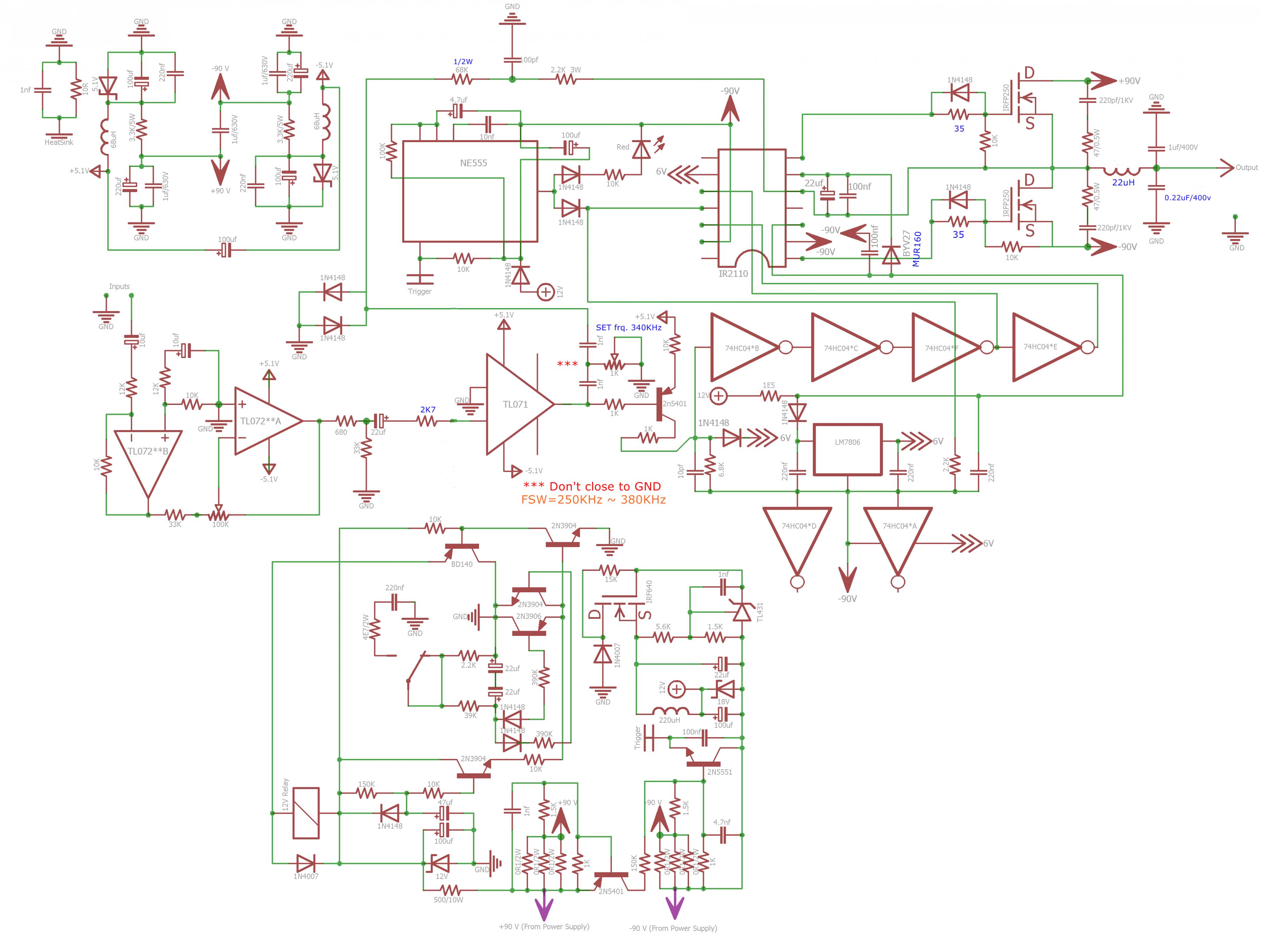

I build this amp that I think is designed by "manojtm" by the name AUD600
I have problem delivering high power from it because as I increase the input signal the distortion begin to increase and the positive rail current consumption goes to 0 as the negative one draw way more power (about 1A)
So am I missing something here??
I appreciate any help from you guys
I'm not a pro and I really like to run this amp
Here's the schematic that I'm using right now:

AUD600 amp is good you need to change 100k to 68k FB resistor and 10K/1W FB resistor to 2K2/2W and 56pF to 100pF/200v and 2N5401 emitter resistor 1K to 10K and IR2110 supply bootstrap cap 4.7uF to 22uF/63v and FSW adj. resistor 1k to 680 or 560 ohm

I did fix the previous problem and now I have a working amp but now the problem is that I can not get more than 600W rms out of this amp on a 4 ohms load despite using a +-90 volts supply
(I get about 70 volts peak output and after that clipping start. at clipping point I have about +-84V on amp rails)
so why do you think this is happening?
I'm currently using IRF250M but I plan to change it to IRFP4227
With +-50V supply amp works great and I get output peak voltage near amplifier rail votages
Thank you again for this amp and your help and I appreciate it if you could help me fix my problem
90v supply rail you will get more than 600W. you said you get 70v on output at 4R load. it means you get more than 1000W
for higher voltage you need to set FB resistor to get 29dB~32dB Max. gain

Hi dear MANOJ
I want to build two separate amp that each capable of delivering 800W rms @4 ohms load for my subwoofers
right now I get 70V peak output voltages that is about 50V rms that deliver about 625W rms @ 4 ohms
I know that for 800W @4ohms I only nead +-80 volts but to lower my SMPS output voltage I have to reduce 1 turn of each secondary winding that will cause to reduce the voltages below +-80 Volts
