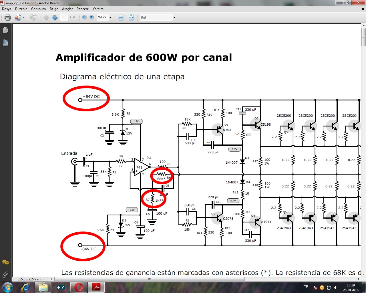

Most. The drivers warm up when I give 2x84 VDC. I think the boat current is prejudice. What to do

The drivers are Q3 and Q4. Are those the ones you mean ?
This is not a great design because the bias is fixed and very component dependent.
Assuming a current of around 7ma plus the base bias current of the output stage and you are looking at around 1.5 watts dissipation per driver. So they need heatsinks and will get quite warm/hot.
The only way to make them run cooler (less dissipation) is to lower the supply voltage or lower the current. Increasing R12 and R13 to perhaps 120 ohms might help but be careful. I would suggest you use a bulb tester while experimenting.

Q3 and Q4 transistors are mounted on the big heatsinks so they should warm up but not overheat.
Are both fans connected and running?
You NEED them.
Sound quality aside, the big problem with this amplifier is that it does NOT have a speaker out short circuit protection, so when you short cables even for 1/10th of a second, you will blow very expensive transistors.
Then the resulting DC (84V DC will appear at speaker terminals) will blow the speakers.
So be very careful with shorts, only use screw terminals (and check wiring every time) or Speakon connectors, never ever musical instrument type plugs and jacks.
