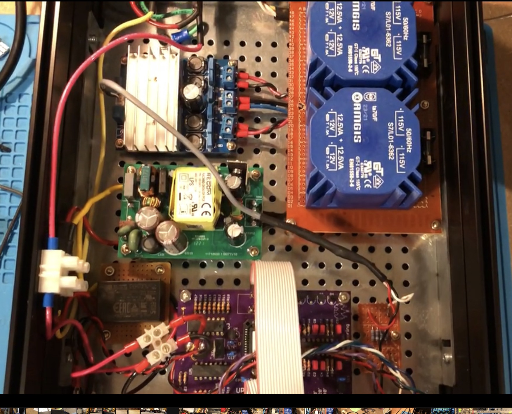

I built my SG4 originally to power the mains level 2 phase Hurst motor on my AR-XB turntable. I have since added a Schiit Sol to my rack, which has a 16VAC Hurst motor. So now I want to leverage one SG4 to power both turntables, not necessarily at the same time, I would switch the outputs.
The SG4 feeds a 8K2/1K8 voltage divider resulting in .454v into the TDA7492. The TDA7492 then feeds 2 Amgis L01-6362 xformers 90 out of phase for a 120VAC output on each motor phase. The TDA7492 outputs 14.97VAC/channel without a load.
My question is, can I simply change the voltage divider to 7K5/1K8 achieve the 16VAC I need through the TDA7492 and power the Schiit Sol motor directly off the output of the TDA7492? Does the TDA7492 then need a .22uF cap across the outputs to filter out HF noise? What else do I need to be considering?

I’m catching on, thanks! Since I already have an operational SG4 setup powering my AR turntable, I ordered another TDA7492 to play around with. I’ll get that one to work with the 16VAC motor, then I’ll update my functional SG4 setup to switch between 16 and 120 vac.

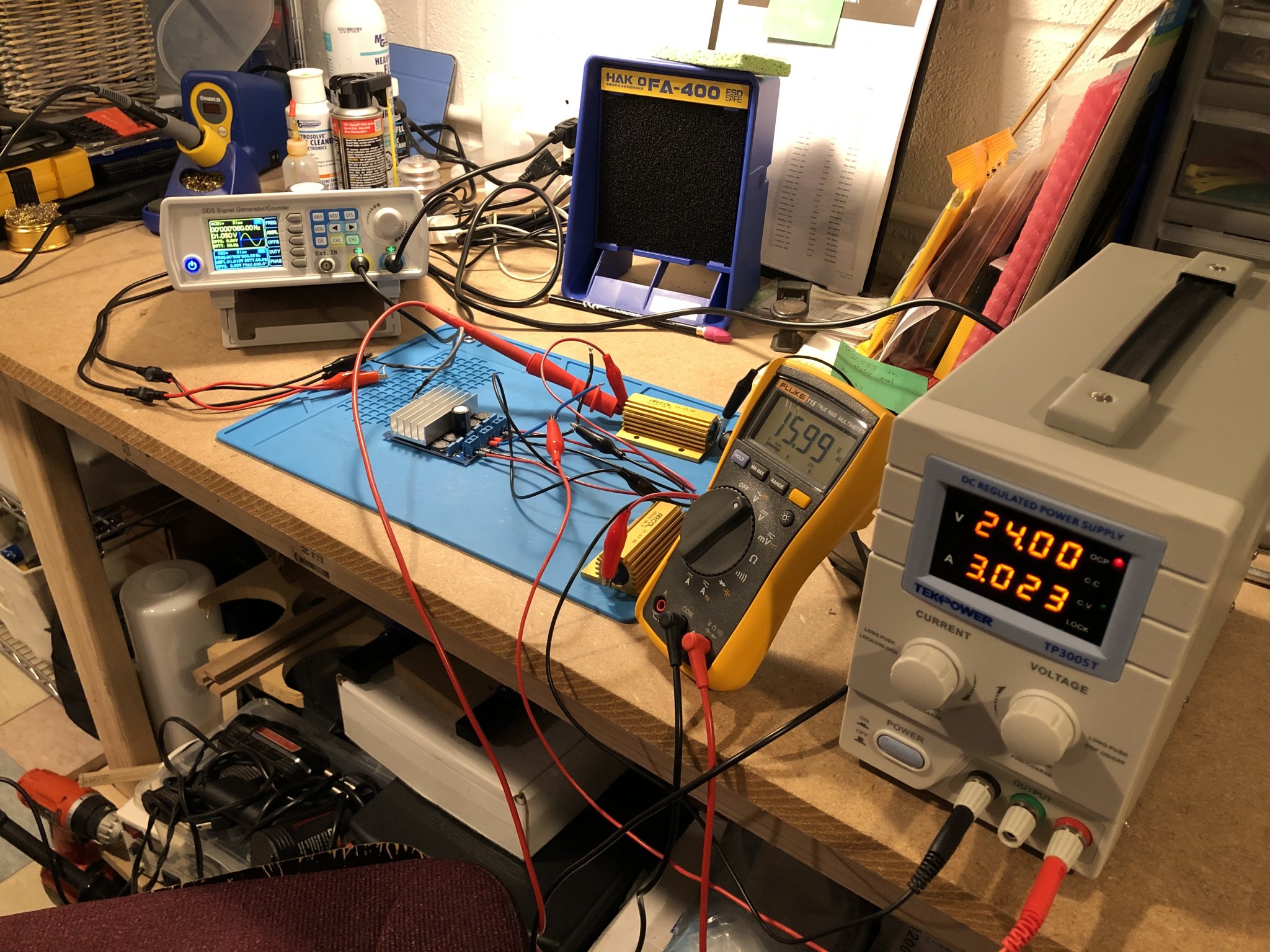

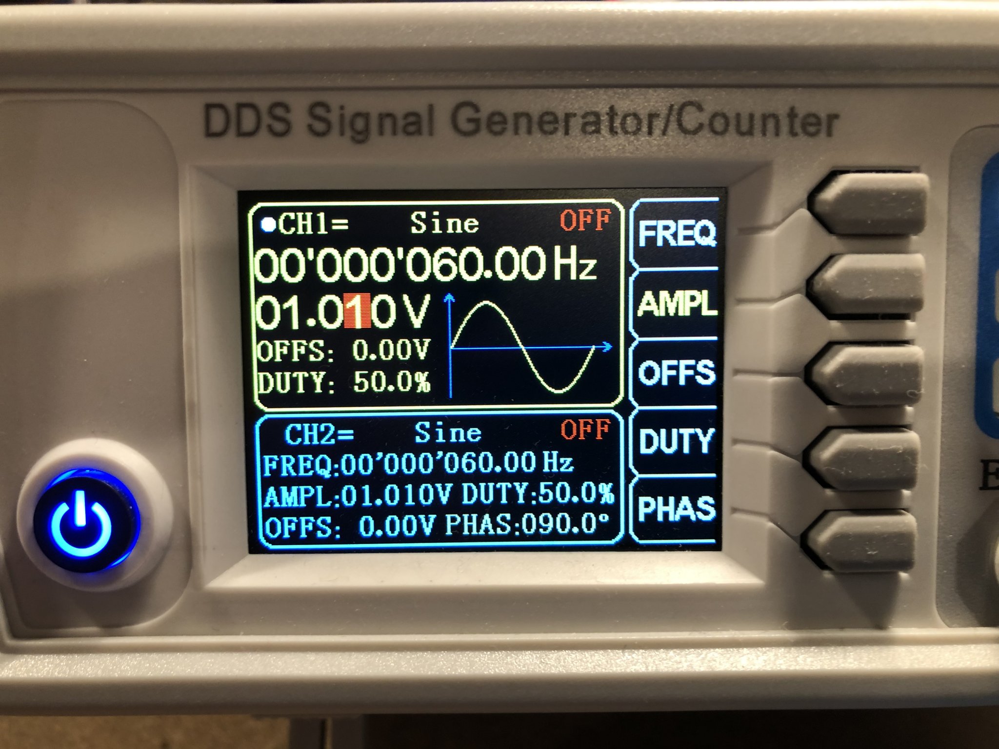

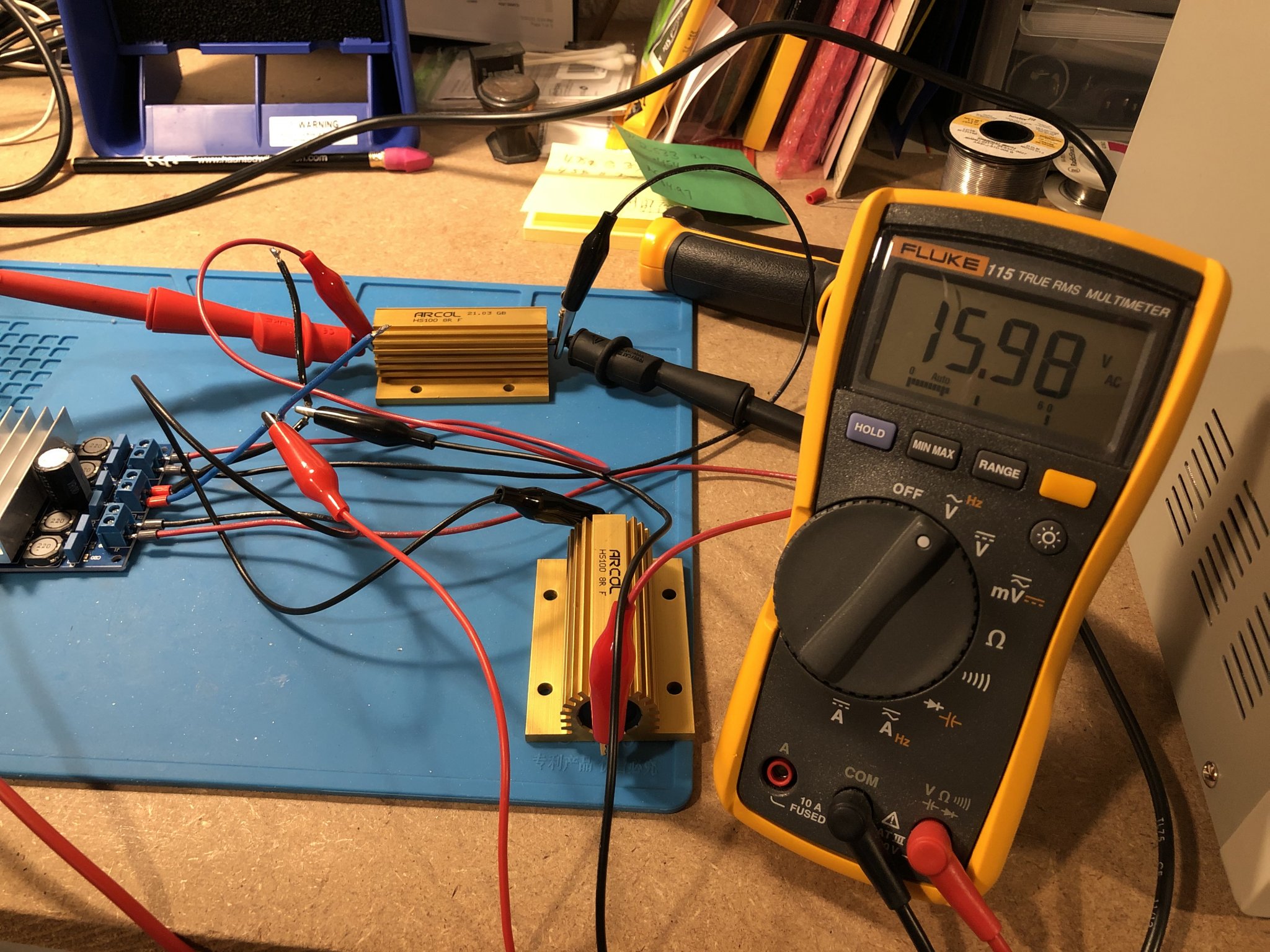

I bought another amp and after some experimentation achieved just under 16v out @1.01v/60hz input. I used 8ohm load resistors on each channel out. Next step is to replace the load resistors with the motor. Once I have that setup functioning well, I will reconfigure my completed SG4/TDA7492 to toggle between 120vac for my AR turntable and 16VAC for my Schiit Sol turntable.
Appreciate the help here - Thank you!
