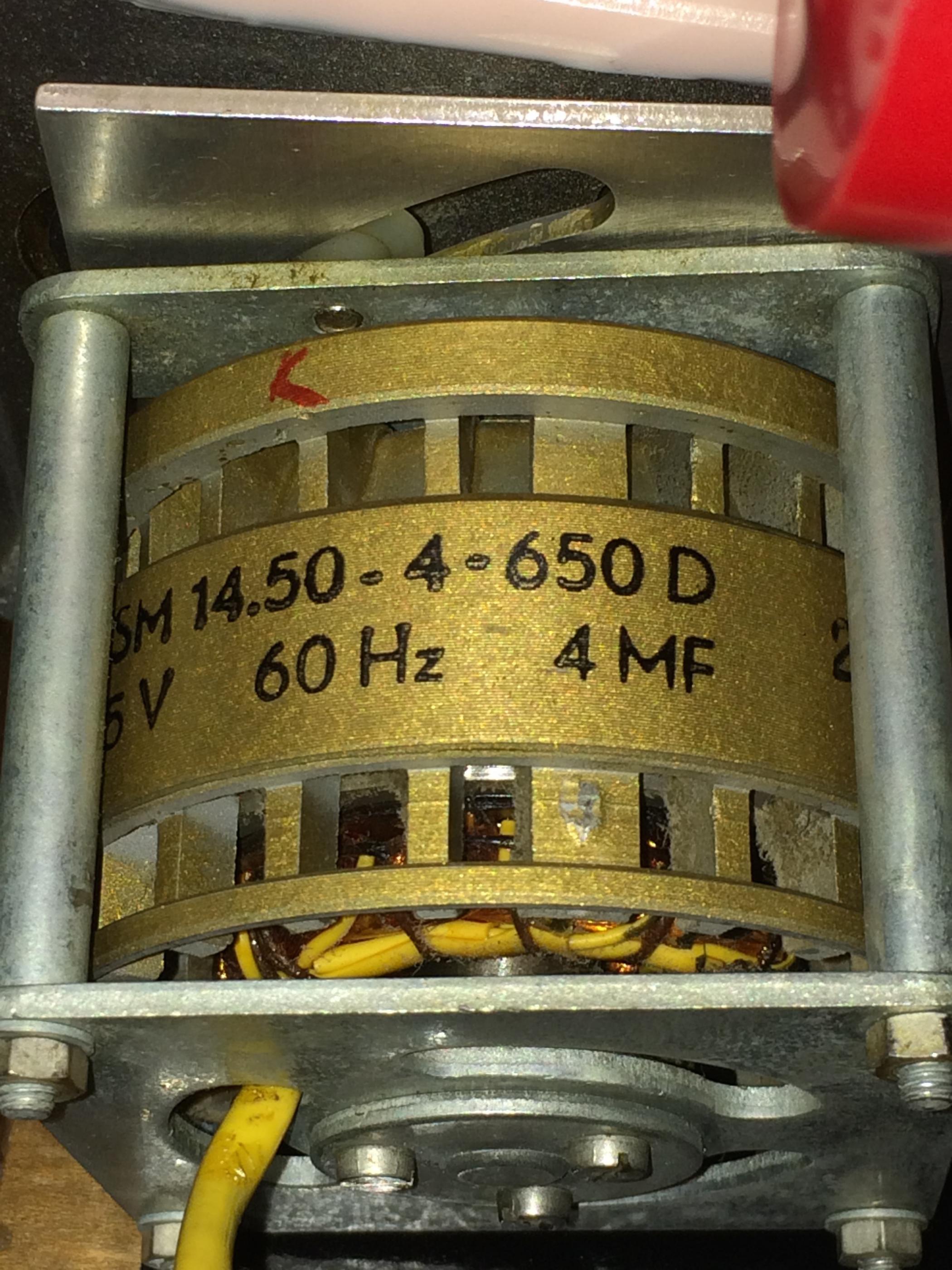

I would like to drive the motor on my Empire 208 table using the SG4/TDA7492 setup described in this thread. I have successfully built one to drive a Premotech 110v motor (older Rega).
My question is this: I have heard the Empire motor referred to as a 3 phase motor. Is this a correct understanding? If so, do I need to output 3 signals to the motor instead of 2 like I used for the Premotech motor?

You can drive the 3 phase Papst motor with a single phase and the capacitor that came with the table or use a 3 phase drive using the SG4/TDA7492/xfmrs, but it is quite a bit more complex.

Empire 208 motor
Like member "hirscwi", I'm also attempting the build to use on an Empire 208 Pabst motor. I've finished the SG-4 and using the MK154 amplifier specified for this thread, I'm in process of wiring all the parts together. I'm a novice at this and not particularly confident that I'm knowledgable enough to pull it off w/out blowing it all up!!
I'll post a photo of everything wired up for the group to inspect before I apply power but in the meantime thought I'd post of photo of my Pabst motor to see if it's the same and if there's anything that helps determine the # of phases used.

OK, here's what I've extracted so far. I'm about 24 pages through the 42 page thread and need to rest my eyes for a while. I do have a question:
The motor on my Empire 208 is wired with a single capacitor (4mfd). I assume this gives only one phase-shifted signal. Does that suggest that the motor is running on only 2 different signals? I assume it would operate on 2 signals but without as much torque and probably more roughly. Is this correct?
With the phase cap, the motor is running as 3 phase, but not optimally. The 2 direct connections can be looked at as running 0° and 180° since they are out of phase with each other. The lead connected to the cap is ~+90° referenced to the 0° input. So instead of running 0/120/240, it is running 0/90/180. This works, but with higher vibration.
