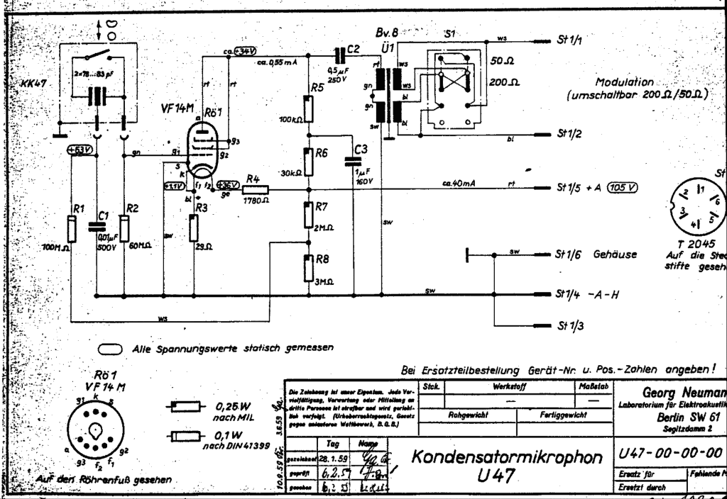

I tested the originals using the Neumann ext psu 408 VDC with no load.
The 100M indicates 130M
The 60M is reading 125M
Test Trumps Theory eh?

I would not trust a measurement of very large resistors without using a clean laboratory test fixture and an electrometer.
BTW what do you mean by noisy, per published spec or your perception. 60Meg is very small for a condenser mic and contributes considerable noise, I have no idea about the grid current of the VF14 but the bias resistor would be better at 1-5G Ohm if possible.

I believe that is appropriate for a tube. Grid current is low but not as low as a small JFET. Grid current in >>100Meg makes hiss. I do not have parameters for a U47 or its parts, but a Sony and an English tube condenser mike got optimum in the 10^2Meg area.
I am reluctant to listen to mike hiss without objective calibration. There is always hiss!! A modern reference could be AKG 414, which is usually in good shape and reasonably low hiss. Adjust both mikes on speech so A/B switch matches level, clear the studio, crank gain (same on both!).

There are two main elements to the noise. A constant hiss, which now seems likely to be exaggerated by the grid resistor now drifted to 125M, over twice the intended. There is another noise, intermittent bursts, I think someone called it discharge noise. Several experts have suggested that often comes from an oxidised valve socket. I have cleaned that, but the reassemble will have to wait for resistors

I meant a redo that dumps the tube, if that makes it more clear. 1" capsule mics exist at 4dBA or so but they don't use tubes.
