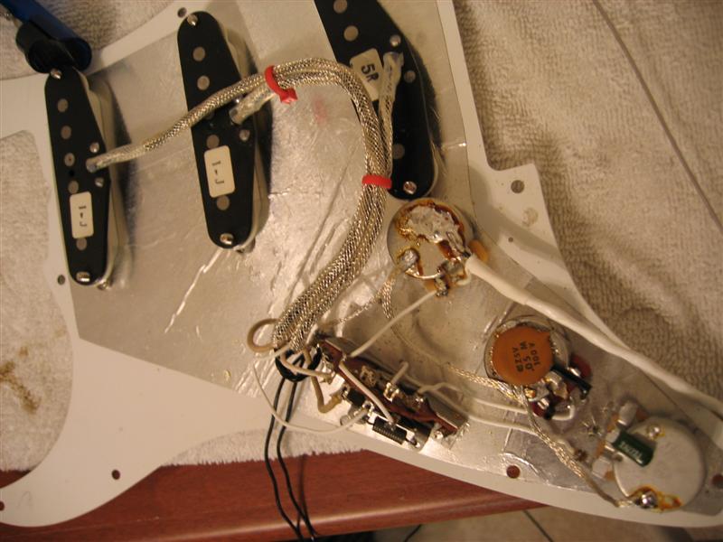

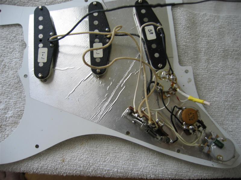

First of all I twisted the pick-up coil leads... Instead of them separated and laying all over inside. I think that was most likely the biggest single improvement.
But then I screened the twisted pairs from all three pick-ups (Strat) and grounded to the pick-up switch. Then I used shielded twisted pair wire to connect the switch to the pots and from the pots out to the jack. ALL wire was Silver plated Copper with Teflon insulation. I use it on other projects and had it handy.
Worked well. Picture attached. Before then after.
